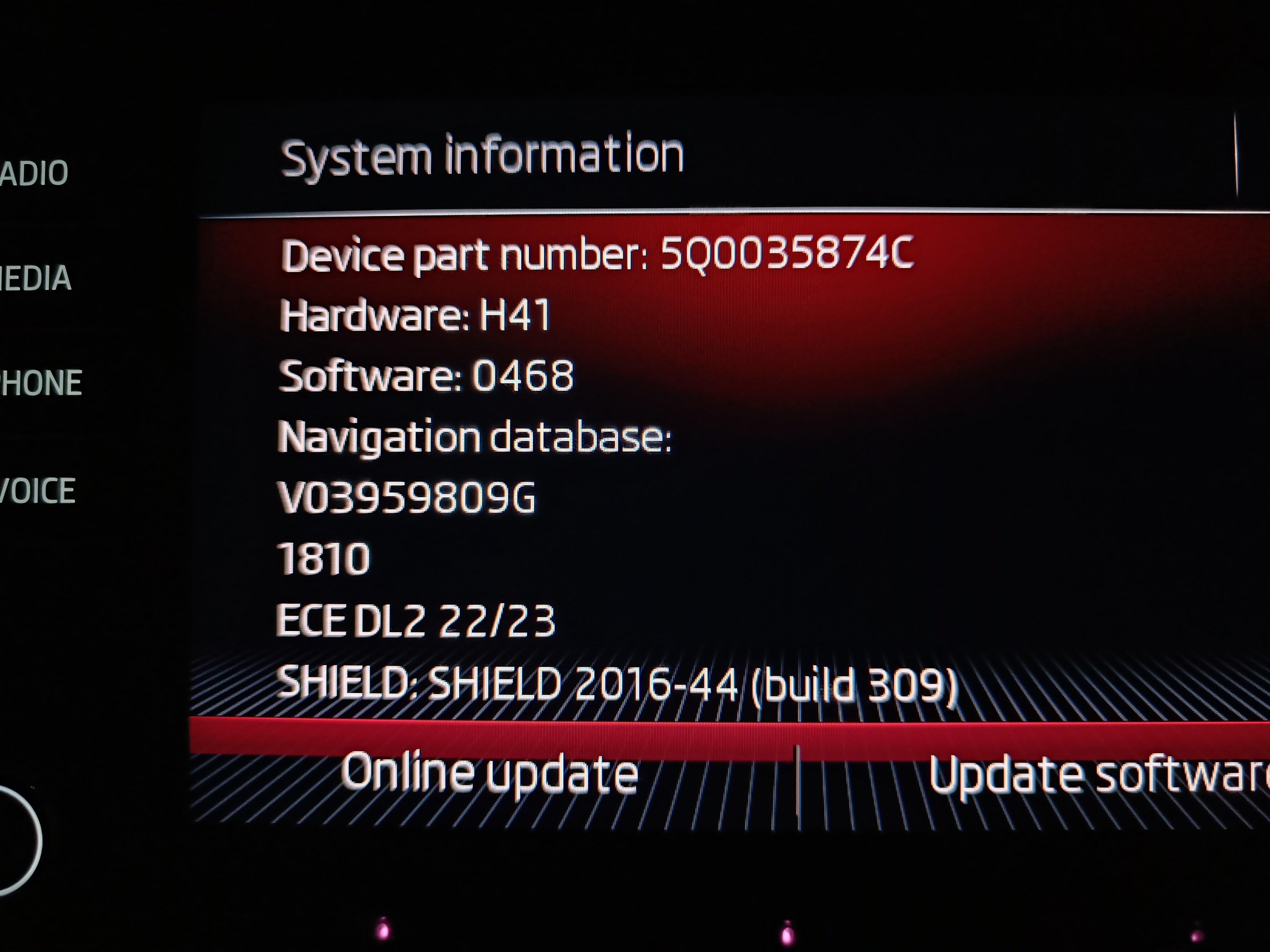

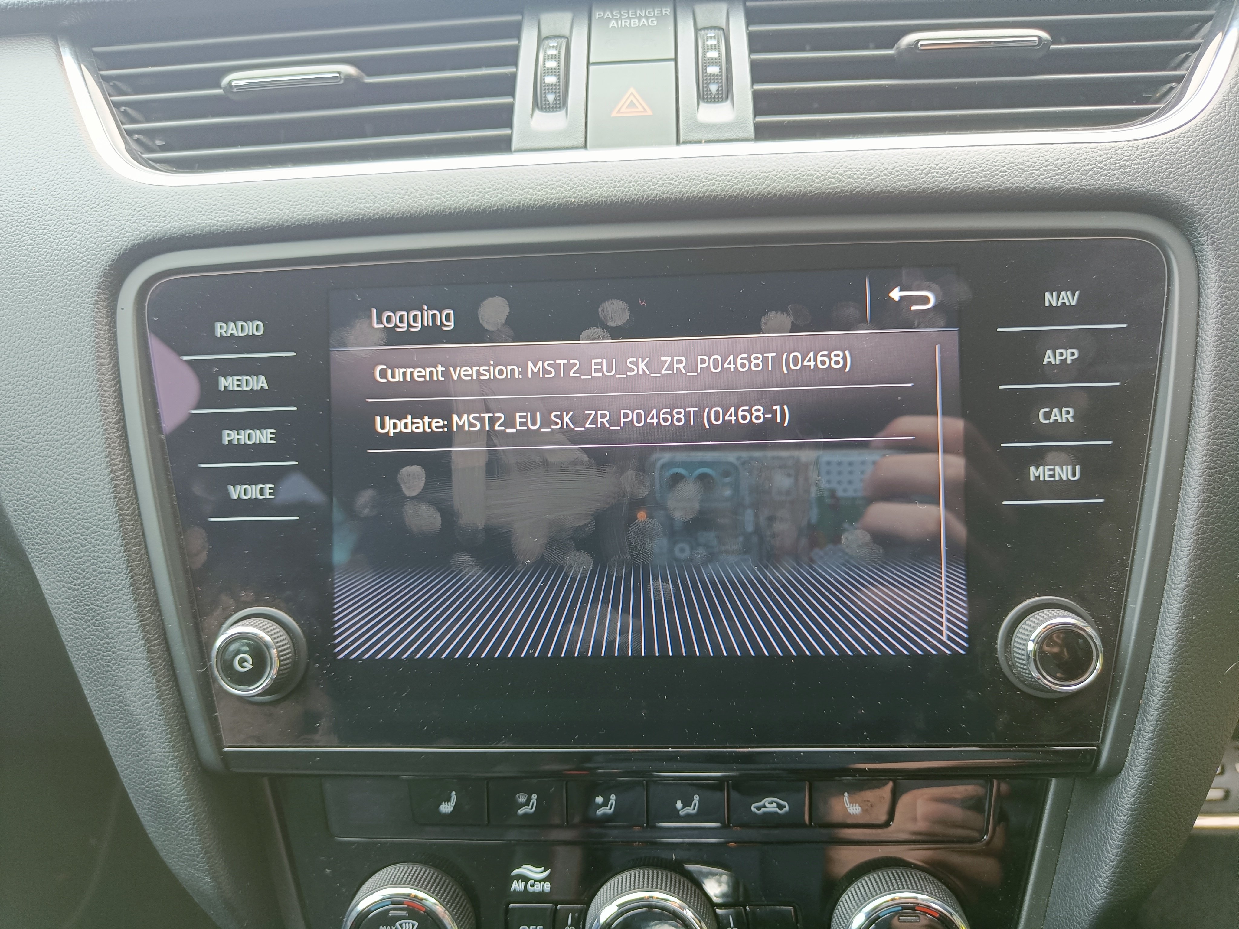

  9. I did think how the car was getting the update hahaha, I do apologies. Yes that would be great if I could get the update.
  10. Hi sorry i'm not seeing the '480' update, is this the correct one?
  11. Thanks guys, Here is the info... Would be great if there was one for my headunit. I believe there we no faults in the system when I took it down to my local independent but like you said ODIS will not have been checked then.
