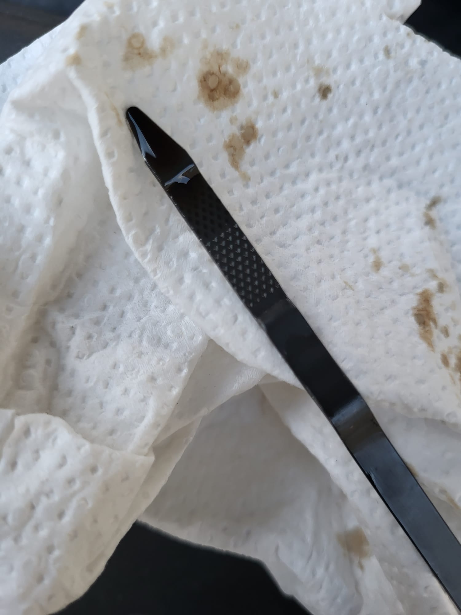

So my reading (the picture I posted) was actually wrong? Because I had waited an hour after I got home. The engine was still lukewarm to the touch though. Now I'm getting worried again I damaged my engine by driving with an oil level that's too low.

Sorry to ask, but I just spent some time searching whether one should check the engine oil hot or cold. The consensus was cold all the time. Why check again when the engine is warm? Isn't the oil still "up there" then for a large part, which gives a wrong reading?

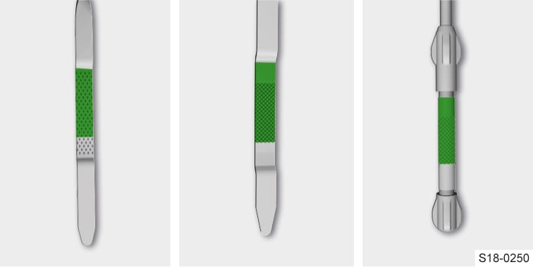

So how do I go about adding the oil tomorrow (it's dark now and the car is outside)? In increments of 0.2 liter, and then do the dipstick test each time until it's at the top of the area of the dipstick with the dimples in it?

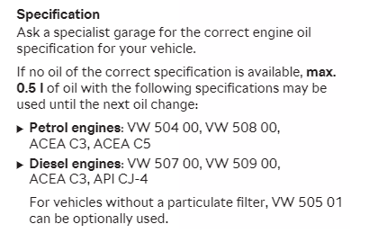

There's nowhere else in the manual that specifies which oil you should oil. Of course they're gonna be vague about it so you have to buy their overpriced stuff?

Hi all, I have a 2021 1.5 TSI skoda octavia 4 petrol. First of all it's my own mistake for not checking oil regularly. I never knew newer cars burnt oil as much as they do (apparently). With my previous cars I never had to check oil levels intermittently, I just went for a yearly oil change and that was that. So today when I was on my way on a several hour trip (30 minutes into the trip). The "please add oil max 1l. You can keep driving" light came on. I didn't have an oil flask in my car nor a location where I could buy one, so I turned around and drove 30 minutes back home. Probably shouldn't have done that and just stopped immediately? Anyway when I came back home the oil dipstick level was this (measured about an hour after stopping): As specified in the manual, the level should be in the green area on the following picture: My least maintenance was 6 months ago in march. So I have no idea how we burnt that quickly through the oil. We did drive around 9000km in that time. Anyway, the garage I used during the last maintenance, used MPM 0w20 synthetic oil. So I went ahead and bought a flask of 1L Castrol 0w20 oil: https://www.opieoils.co.uk/p-162116-castrol-edge-professional-ll-iv-fe-0w-20-vag-fully-synthetic-engine-oil.aspx Would that be fine to refill the engine until I get my oil change? In the manual they specify I can only put in 0.5L of VW 508 00 oil IF there is no oil with the right specifications. But they don't say which are the right specifications, so I'm confused. My last question is, if I perhaps did any damage to the car by driving around with low oil levels?

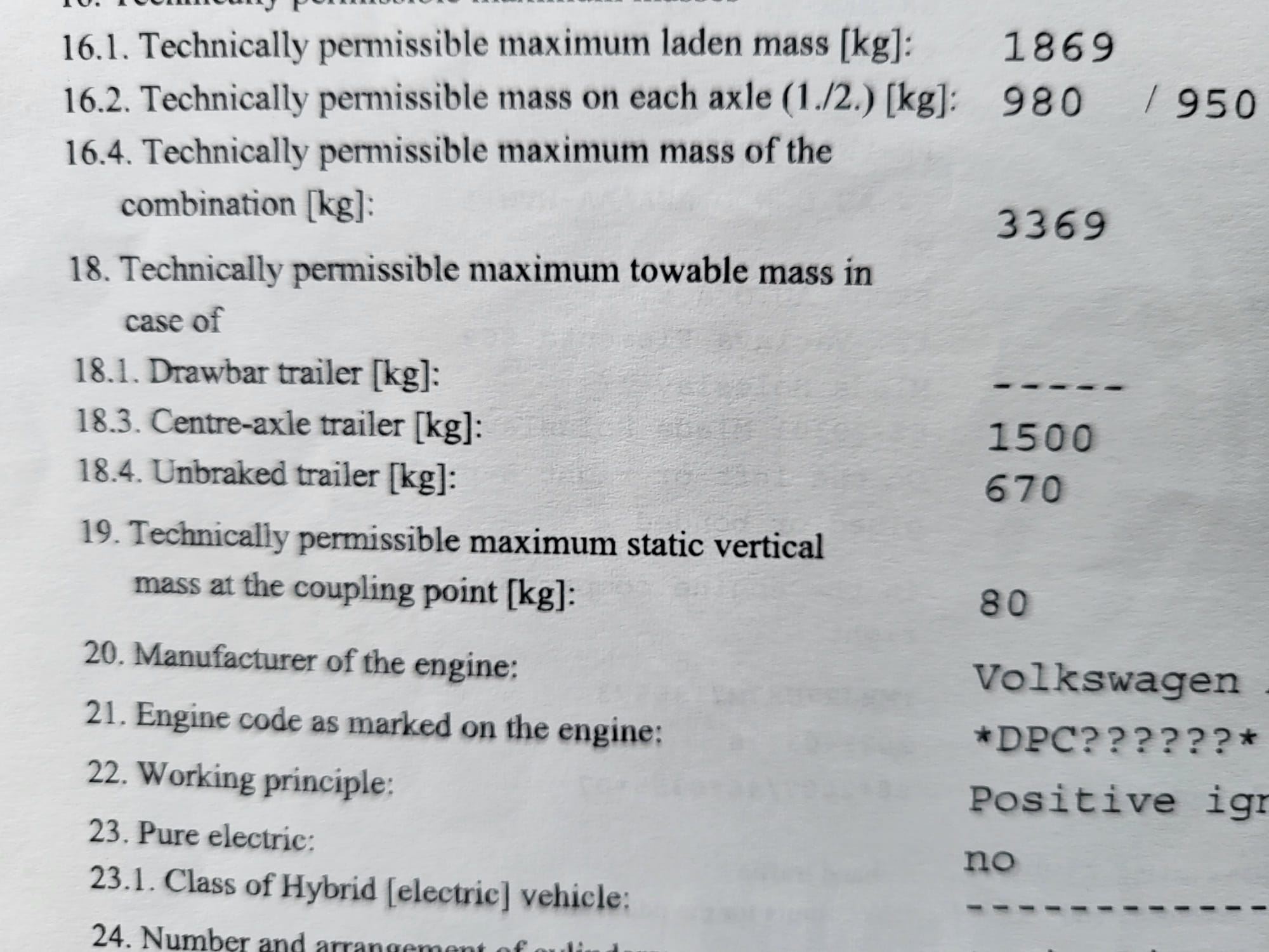

We would like to purchase a travel trailer, but we don't know what the max allowed weight is our 2021 1.5 TSI Skoda Octavia can pull. I live in Belgium so we have some kind of certificate which mentions the max allowed weights. There's three options: drawbar trailer, centre-axle trailer and drawbar trailer. Which one is it? Pic of certificate:
