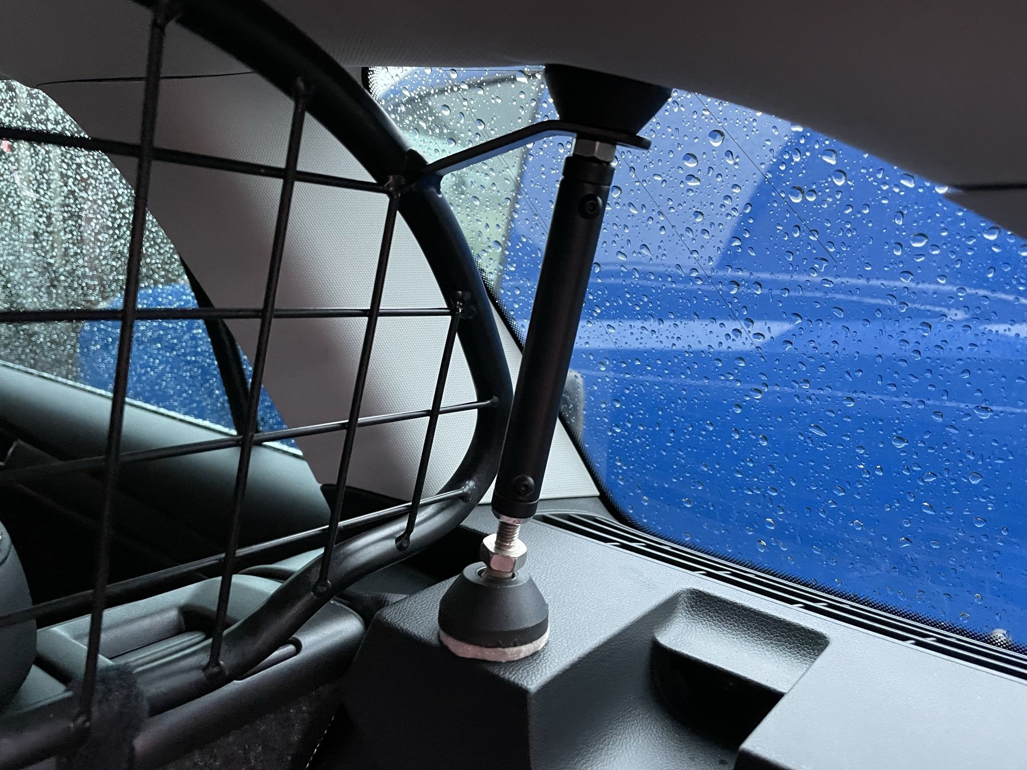

  1. It is only the roof fixing points that are the issue. The guard fits in all other respects, including height. The guard was purchased for a 2016 Superb estate without sunroof and is now fitted to a 2022 Superb Estate 2022. Also fitted is the longitudinal divider giving the 40/60 split in the load space. Attatched is Skodas fitting instructions for the guard. 3v9_017_221.pdf3v9_017_221.pdf items A - F are replaced with the support posts.
