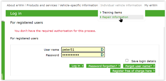

  16. No I cannot get the service manuals - I get this message continually. Erwin have confirmed the reason being I registered as an individual. They say you must register as a company to get the service manuals.
  17. This the email I received from Erwin support. Dear User, I see in erWin registration, that you are registered as a private person. the Digital Service Plan application is primarily created for electronic maintenance records by either authorized services (via the ElsaPro system) or unauthorized services (via the erWin system). You are in system erWin registered as a private person. That is why this application in erWin behaves in such a way that you do not see it as a private person, but as a company you do. Only a company and not a private person can make the service record and see service history! If the customer wants to have an overview of the entire service history, he must visit any authorized service partner, who can print the entire maintenance history of his car on request.
  18. Well I have still not been able to access any repair manuals from Erwin. Eventually ERWIN support worked out that because I registered as a private individual I cant have access to the repair manuals - I must register as a company. Has anyone else had this problem? I tried to re register as a company but it rejects me. I need the CJZE pinouts on the ECU to grab an oscilloscope image of crank versus cam synch signal and I need the schematic of the front passenger - to be removed and replaced - if anyone can help with those items Id be gratefull.

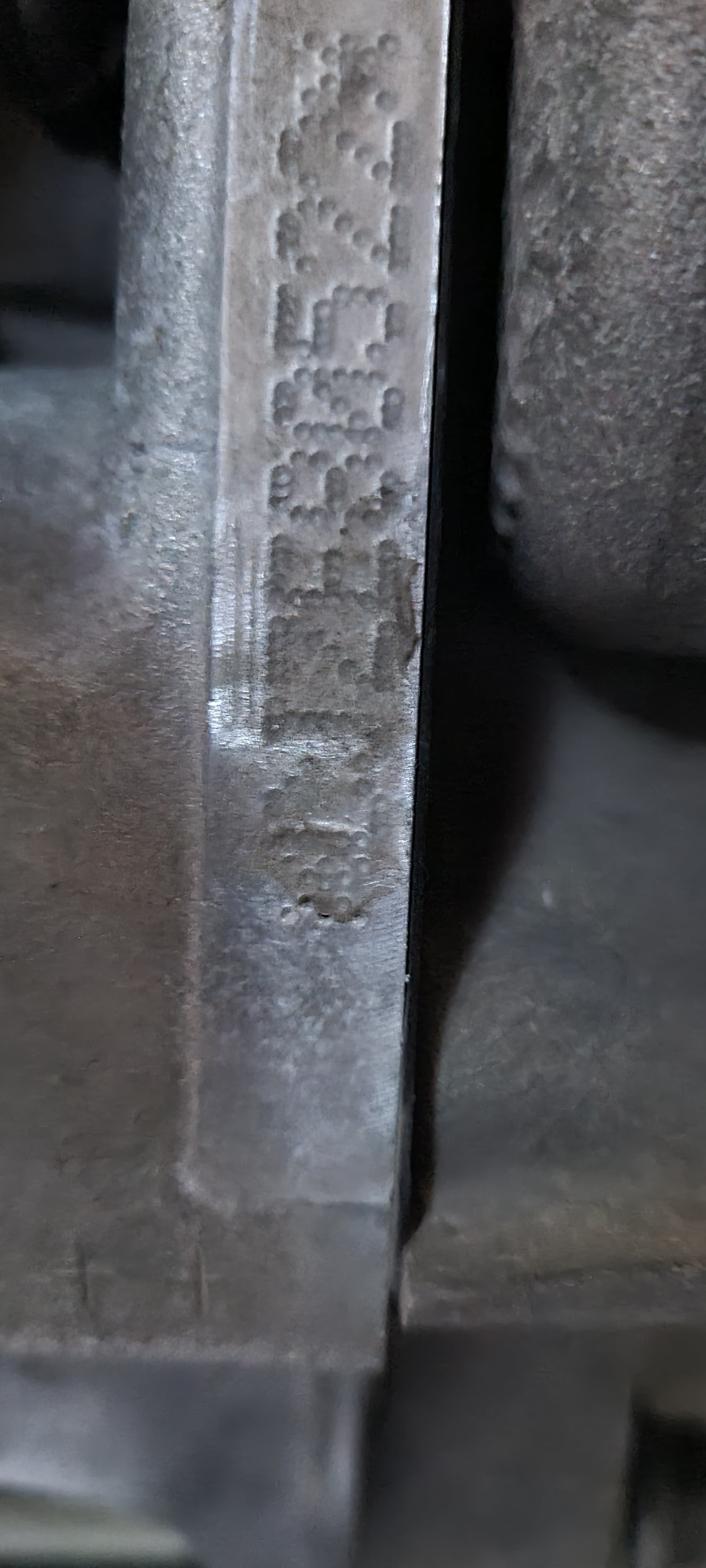

  23. Engine number attached - registration papers reflect that number CJZE80522. Owners manual front cover reflects CJZC. Probably the maintenance manual and circuit diagram for the CJZC will do.
  24. Thanks varoom - I see you up up late in the UK - thanks for your time. yes that is the engine number stamped on the engine - it is the last of the 1.2 TSI sold in australia prior to the 3 cylinder jobs. The E in the CJZE could be an Australian modded engine but I would expect erwin to be correct. Importers here are useless. We do have a head mechanic at the local Skoda dealer from the UK - cant get to him past the service manager. Local skoda forum is poor compared to brisskoda - so no info there yet. Have you any ECM pinouts for the CJZD - I need the cam and crank input pins. Have you any info in the timing pin kits. Thanks again.
  25. Yesterday I bought access to Erwin. I was registered by the administrator and given access. I could not access any maintenance manuals - the massage banner was “ you dont have the required authorisation” All I could do was carry out a VIN check and even then Erwin came up with an incorrect engine model. Erwin said my engine was a CJZC when the correct engine is a CJZE version. SKODA VIN MBKM6NJ3HZ129097 ENGINE CJZE80522. I have asked Erwin for tech help - they only refunded my money and said try again to login. Is Erwin the best resource for maintenance or is there a better resource. I note the manuals in https://cardiagn.com/skoda-fabia-mk3-1-2-66-81-kw-tsi-engine-cjzc-cjzd/? I need accurate electrical diagrams to attach my oscilloscope to the ECM for a cam/ crank waveform grab, prior to a timing belt change. I also need details on the part numbers for the timing pin kits in order to change the Cam belt on a CJZE Fabia 1.2 TSi. There should be cam and crank locking pins I assume. Any help from the tech gurus would be appreciated. If I go ahead with the timing belt change I will post the process here. I have done several Japanese cars but never a Skoda.
