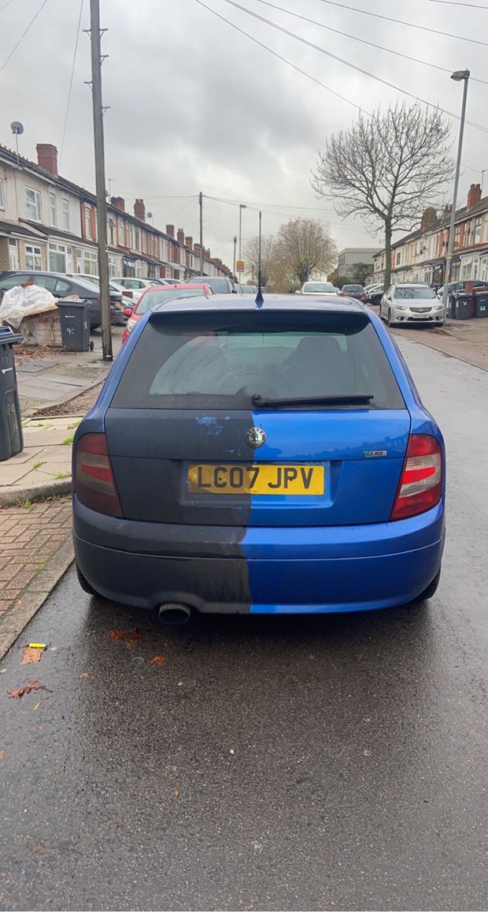

  4. Just bought a cheap vRS SE as a project, and it is lacking a lot of power, previous owner had told me that it was mapped to Stage 1 running around 160-170bhp. However it doesn’t feel as though it is ‘pulling like a train’. There is an air leak in a pipe leading into the intercooler, I’m not the most advanced when it comes down to the mechanics of cars, but I’ll attach a photo of it. When putting my foot down, you can hear the sucking/whistling noise when around 3000-3500revs. The previous owner had told me that the leak could cause a cloud of black smoke from the exhaust, but I do not know if that’s because of the leak or just that’s its a diesel. Do you anyone know what pipe this is? And should I replace the whole Side mount intercooler or just the pipe? Thanks
