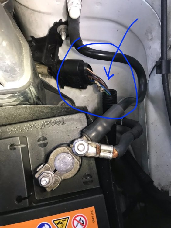

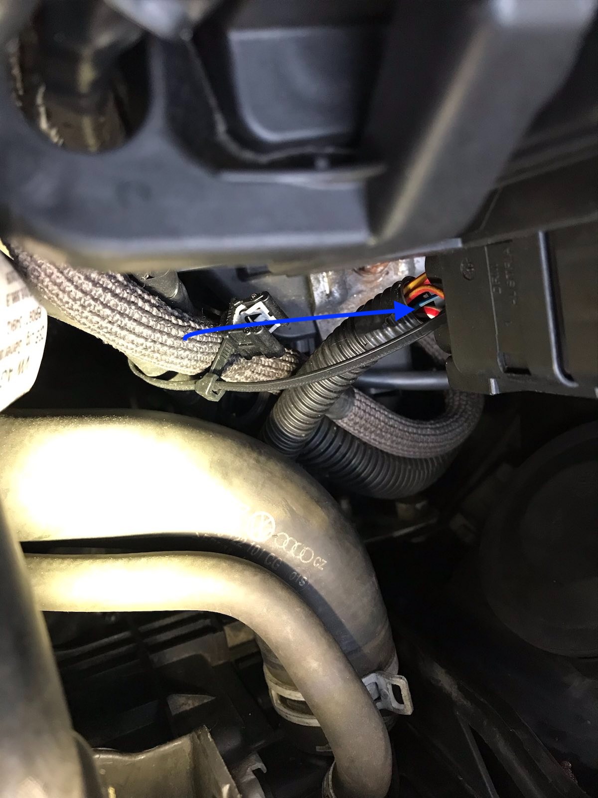

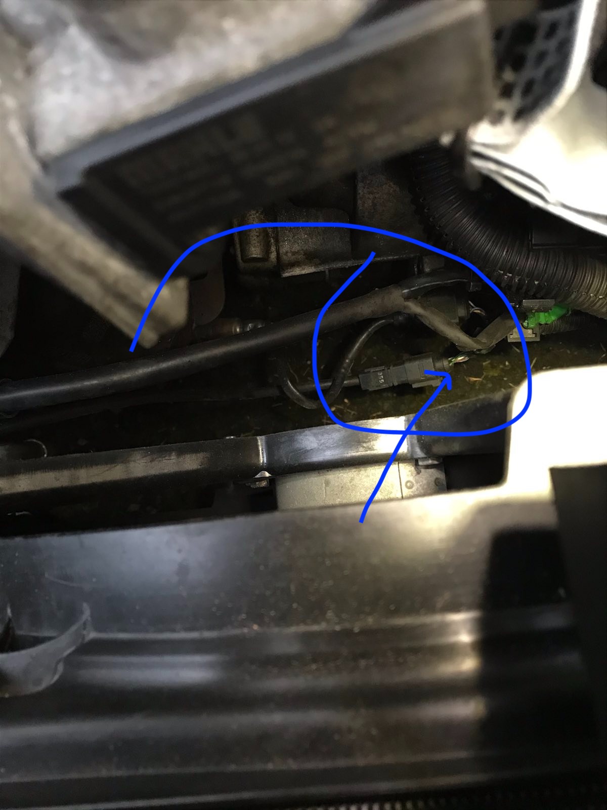

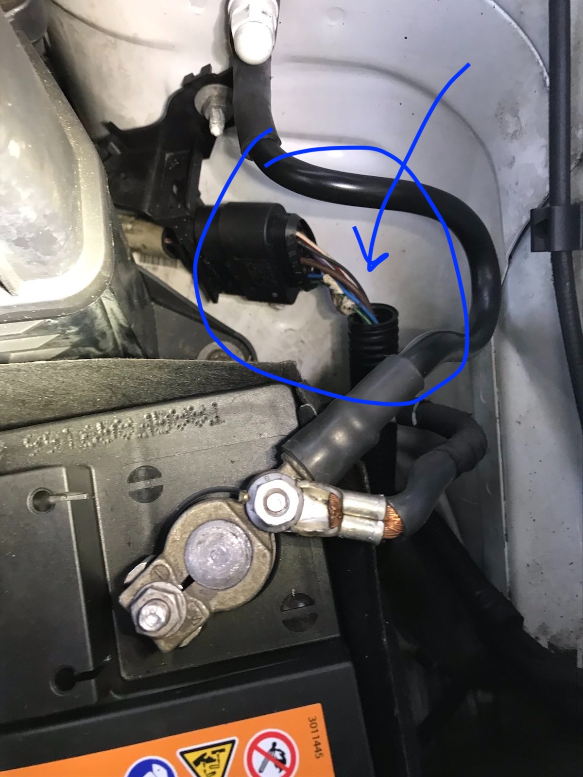

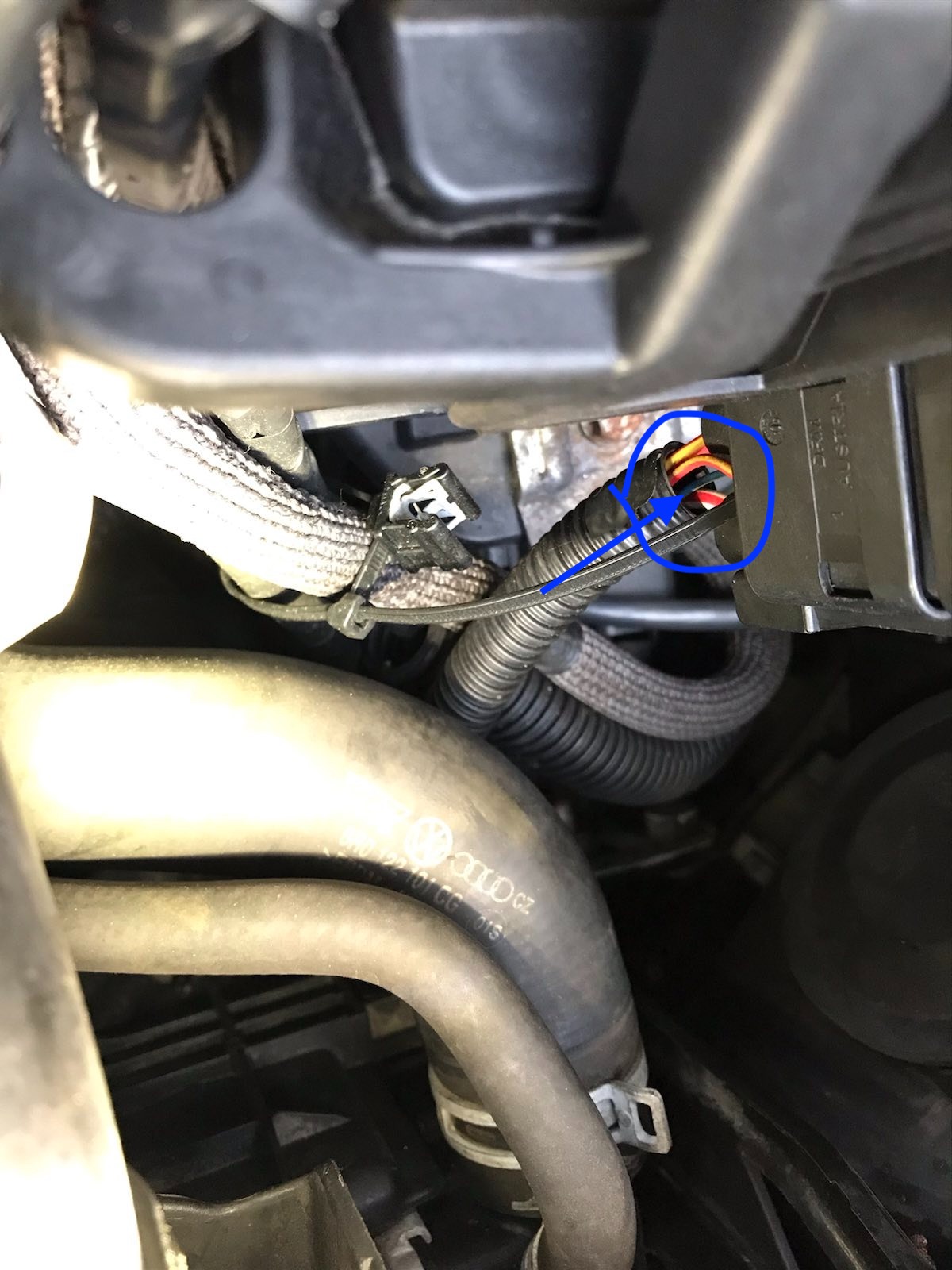

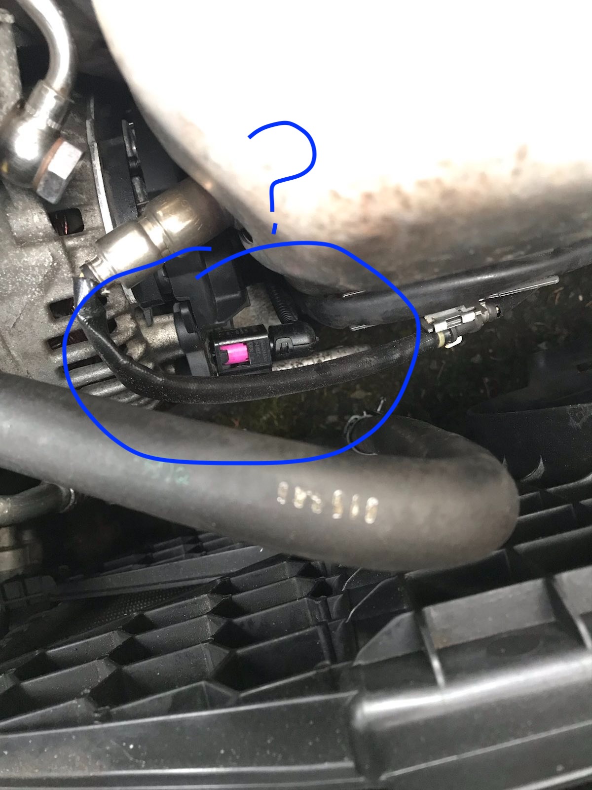

Hi Guys hope you had a good week. Been busy so just getting round to work on this "Hunt for the Blue Wire" couple of things: FIrst, I have power steering. It steers. Dunno what I was thinking or whatnot. Yesterday I over-clutched ina fiddly car park and the engine turned off, was on a hill going into a space. Decided to let it roll - THEN I found out what it's like with no power steering. Second, with some reflection, I realised this ALL began AFTER I had the good ship Halford's out to replace my battery (due to the infuriating alarm going off constantly, that I removed myself). It is clearly electrical, as you've said. I feel like the guy at the garage is well intended (he pushed through an MOT while everything was workin), but he kept going on about some expensive electrical switch *mentioned) that was tied somehow to the car itself by programming and was mad expensive to replace. (!?) Now, Blue wire: Before I go spending and digging through manuals, can you please give me a hint what/where I'm looking for? Below are photos of the blue wires I can find thus far... Behind the battery? Feeeding into the wee connector on the front of the battery? same one better view Curiously hanging free coming from under the battery seems to swing up behind the alternator? Alternator connector had a blue one... Thanks as always @Breezy_Pete @varooom @KenONeill @nta16! Martin

GOnna go on the SEARCH FOR THE BLUE WIRE. Or make a movie of that title. @Breezy_Pete be careful what you wish for anyone know the best site to get a shop/repair manual? Don;t mind payin for a good one...

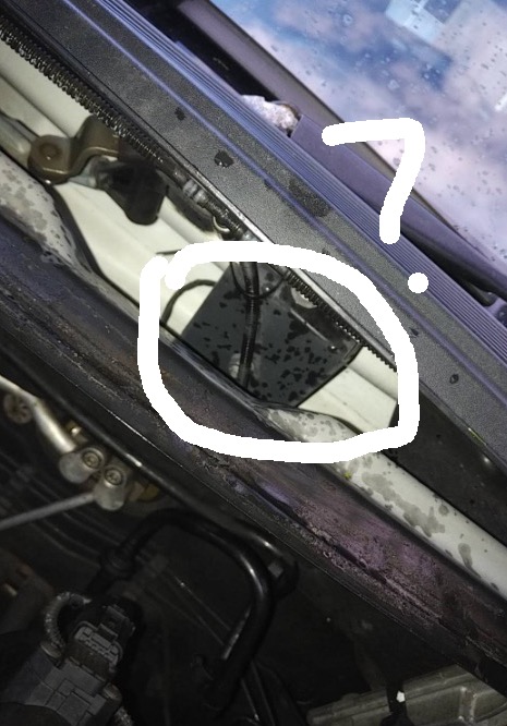

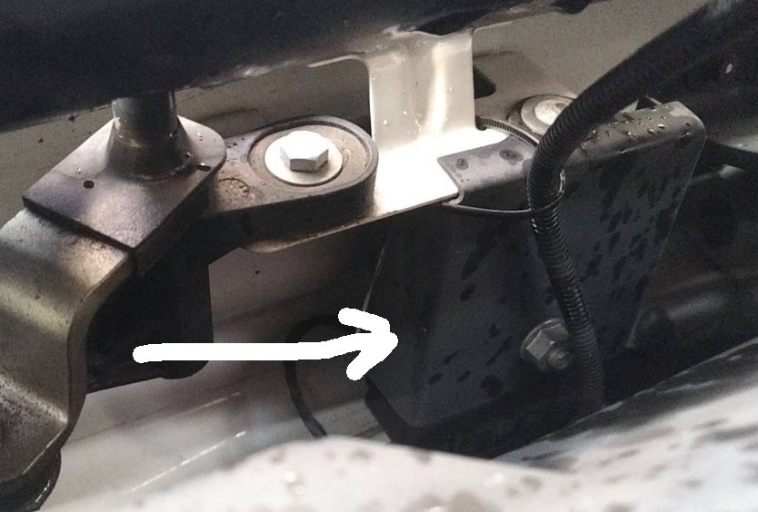

@nta16 @Breezy_Pete Thanks Nigel and Pete. The report is, I stopped checking the computer, and opened up that bonnet, took up the plastic skuttle cover (?) and removed the thing. MIRACLES! I just didn't feel confident messing about with the fuses and having it go off anymore - some of my neighbours are elderly and it got late in the afternoon. I'll have it in the garage 5 January and let them sort it, but I feel very empowered - am not a newbie to cars just to Skoda and such. I noticed in another thread someone was saying they replaced with one made in Italy. Italy is also marked on mine. Appears someone's replaced this already. The fellow this morning could not get any readings from the computer reader - so, we'll see how we figure this out... But yes indeed Nigel, I'll do anmother post/theared and shre what I've learned, and what I find out. Taking the thing out was slightly fiddly without removing the wiper arms, but not really that bad. 30-45mins? You just prop it to one side, and I got something to press the left side up high torquining the plastiuc without breaking anything. One thing to watch out for: the windscreen spray hose is clips with a tiny zip tie to the alarm bracket. Must be cut first lest you rip the spray hose up. More soon, and really guys, THANK YOU. Martin

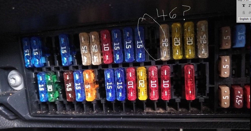

Hi Pete and NTA - so, update. Battery replaced. Siren goes off still. Changed key fob batteries. Went off again. I think thankfully there's a timeout on it or I'd lose my mind - I only have hearing in one ear and this is excruciating. I also disconnected the main battery. Stranegly, I went to pull fuse number 46. There's not one there! Could this be the issue? The garage that was checking it out for me was testing down there a few days before this started? could they have left out a fuse? Otherwise, Pete, I may try your fuse 54. I may just have to cancel my Christmas plans... Dunno. I am tempted to just open thte top and remove the darn siren. It's a 2011, is not mint necessarily, and I don't leave anything of value in the car. This is too upsetting and I can't keep disturbing the neigbours. thanks for any further ideas.
