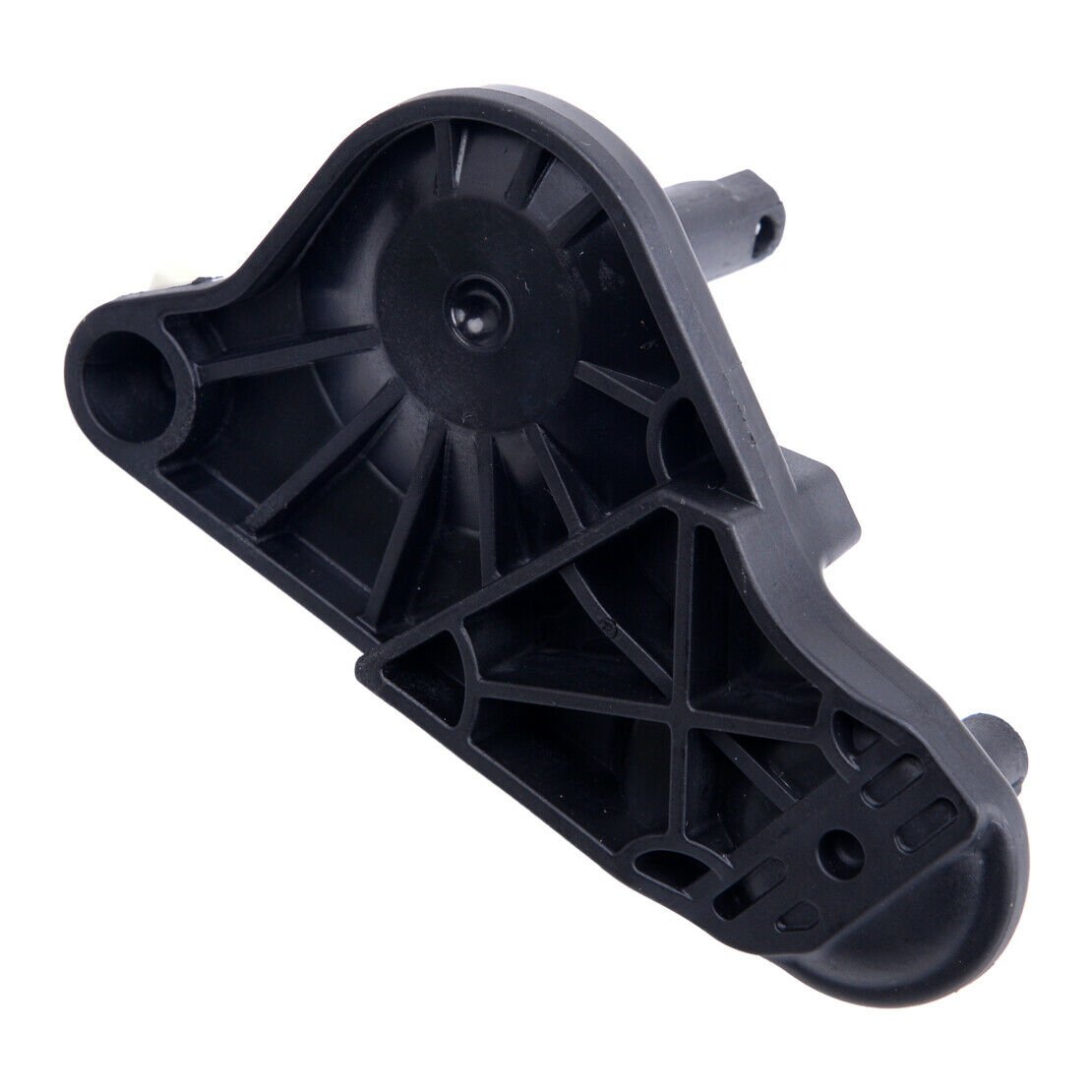

  7. fabia 2008 service on time battery good Morning first time quick start , when worm its takes long salves to start. went to repair suggested 50% chance of starter motor anyone has any similar issue pls share
  8. diesel battery recently replaced , service on time
  9. hi, i have issue with fabia taking longer slaves to start today i found interesting which solves the issue i believe background , i usually keeping car on gears whilst parking (maybe issue develop due to this) issue maybe solved but not sure need advice - -- - - - -- when i turn off the engine i put gear to third and make it neutral when start it work fine / but when i turn off engine and put gear on 4th or 2nd and then neutral when start it take longer salves (anyone know why is that).
  10. i had same problem gear stick was free , mine was Car Shift Linkage Lever was faulty its location in engine easy to change
