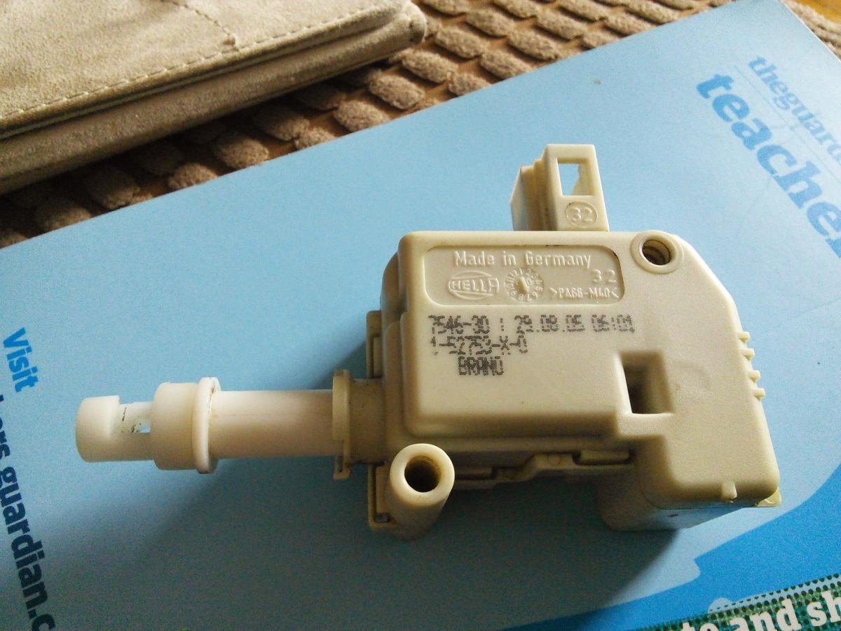

My boot would not open checked over looked fine lay in boot with car all closed up pressed unlock on keypad the piston part of this post-105123-0-25239500-1411913087_thumb.jpg did not move
