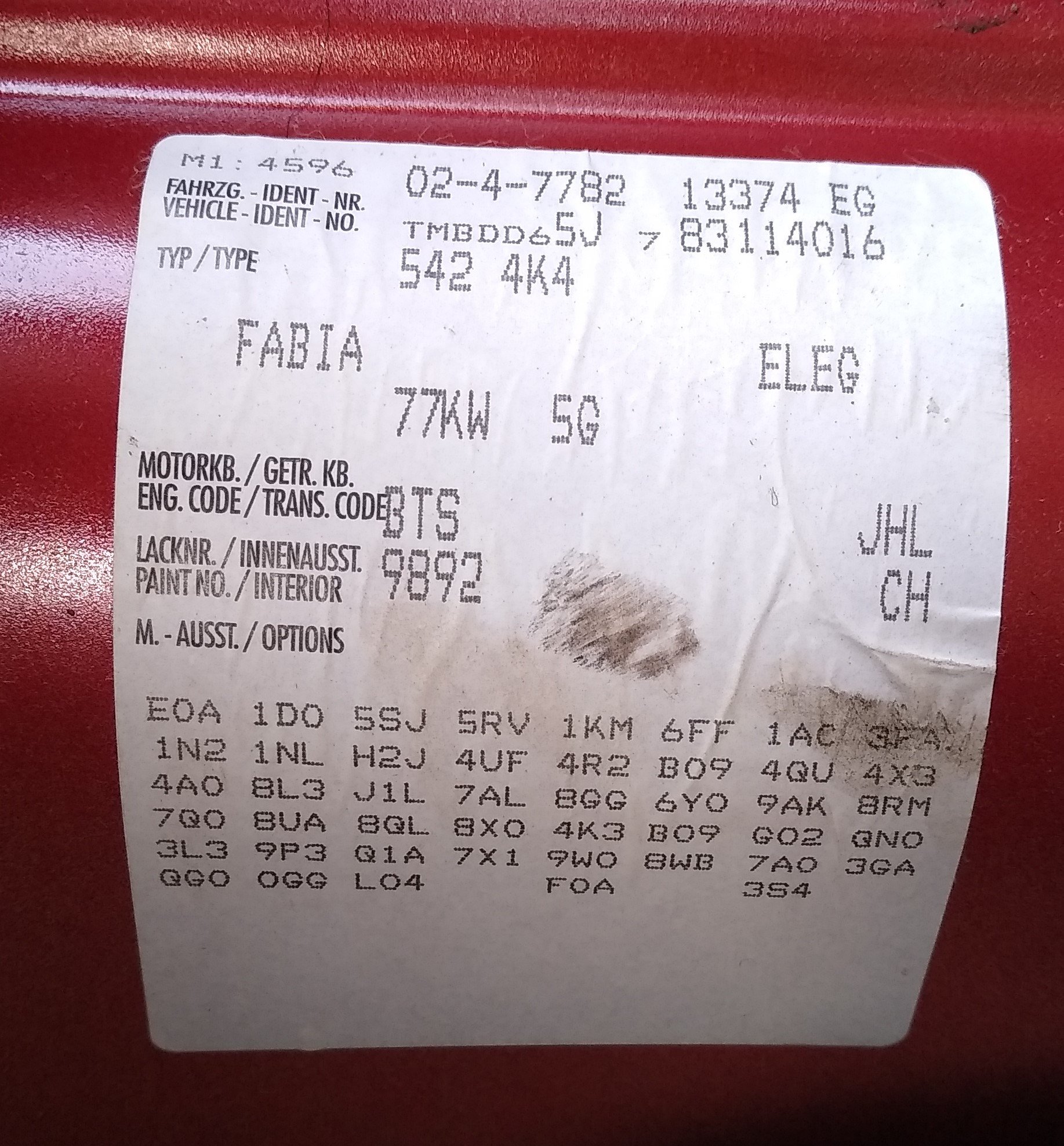

  10. Can someone let me know what the PR code or OEM number is for the front disks of my UK spec 2008 1.6 16v Fabia hatchback. I have looked at the PR codes listed on the sticker in the boot but none seem to match (Helpfully it only shows the back drums as 1KM). VIN is TMBDD65J783114016 Engine is BTS Tyres 205 x 45 R16 My local car parts store shows the following choice of disk diameters / PR codes 230mm 1KK, 1KT 239mm 1LB, 1LM 256mm 1LQ, 1LR, 1ZE, 1ZG 288mm 1LN, 1ZC, 1ZH Any suggestions to save taking one off to measure it? I have attached a picture of the PR sticker Thanks - John

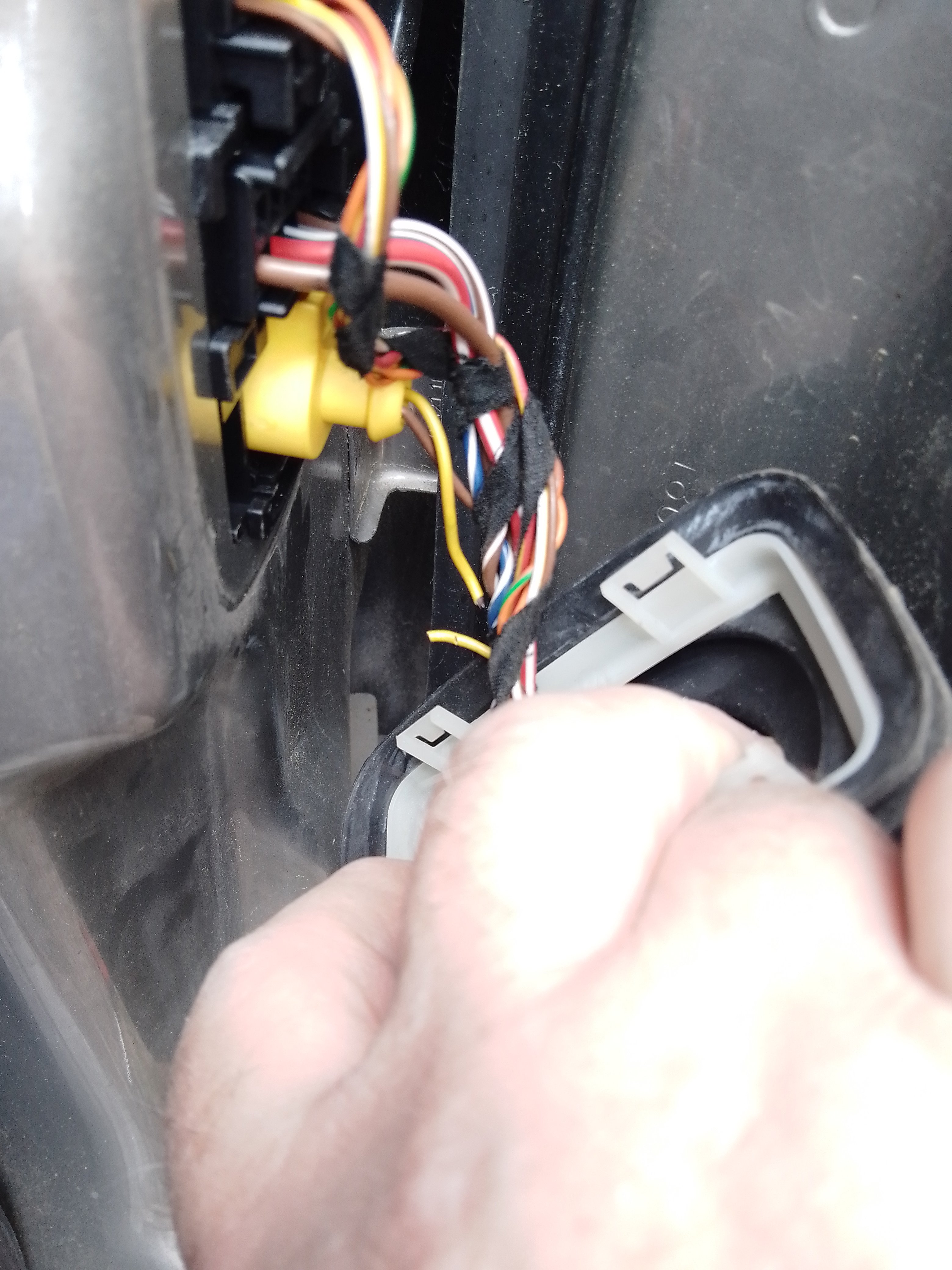

  11. Hi Pete, it was exactly as you stated. The yellow wire to/from the sensor looked like it had been chopped in the cable bundle from the body to the door. I patched in a new piece, flushed the memory and hey presto no more fault code or airbag light. Today it passed its MOT. Many thanks 👍😁

  13. my diagnostic gizmo shows DTC 01221 - side airbag sensor , drivers side. G179 open circuit / short to plus. I have checked the usual connectors & wiring under the seat etc for faults. Where is the impact sensor located? is it in the door or body? Any help gratefully will be much appreciated
