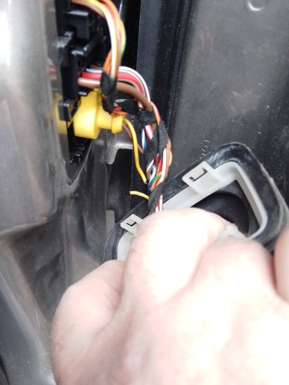

2006 octavia FSI - airbag warning
Hi Pete, it was exactly as you stated. The yellow wire to/from the sensor looked like it had been chopped in the cable bundle from the body to the door. I patched in a new piece, flushed the memory and hey presto no more fault code or airbag light. Today it passed its MOT. Many thanks 👍😁
Thanks Pete, I previously had door lock problems with a fabia caused by the door loom wiring so I should have guessed. cheers
my diagnostic gizmo shows DTC 01221 - side airbag sensor , drivers side. G179 open circuit / short to plus. I have checked the usual connectors & wiring under the seat etc for faults. Where is the impact sensor located? is it in the door or body? Any help gratefully will be much appreciated
