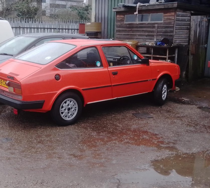

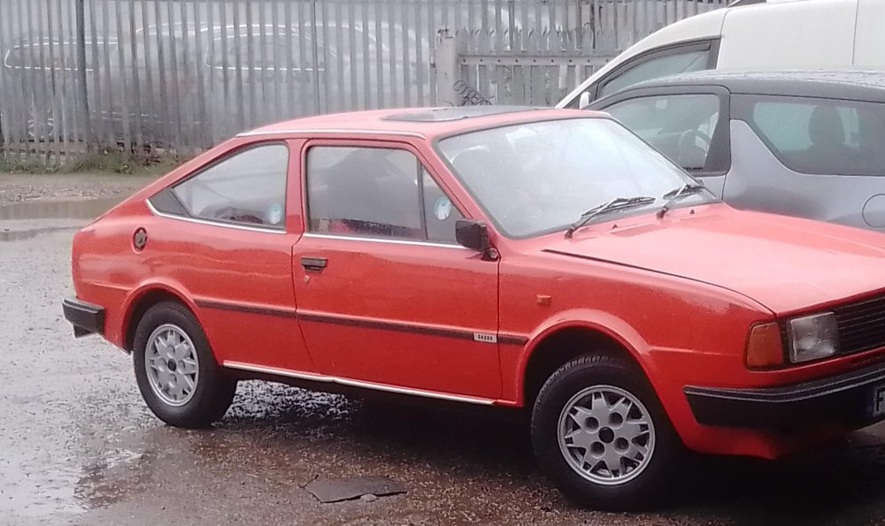

  16. My Skoda Estelle Rapid ... Owned Brand New from dealership in 1988... I do require help & assistance from group members on a few items I need to keep car on the road. The car works beautifully with only 30,000 miles from new but alas I need to source the odd item 😬 🚘 🚘

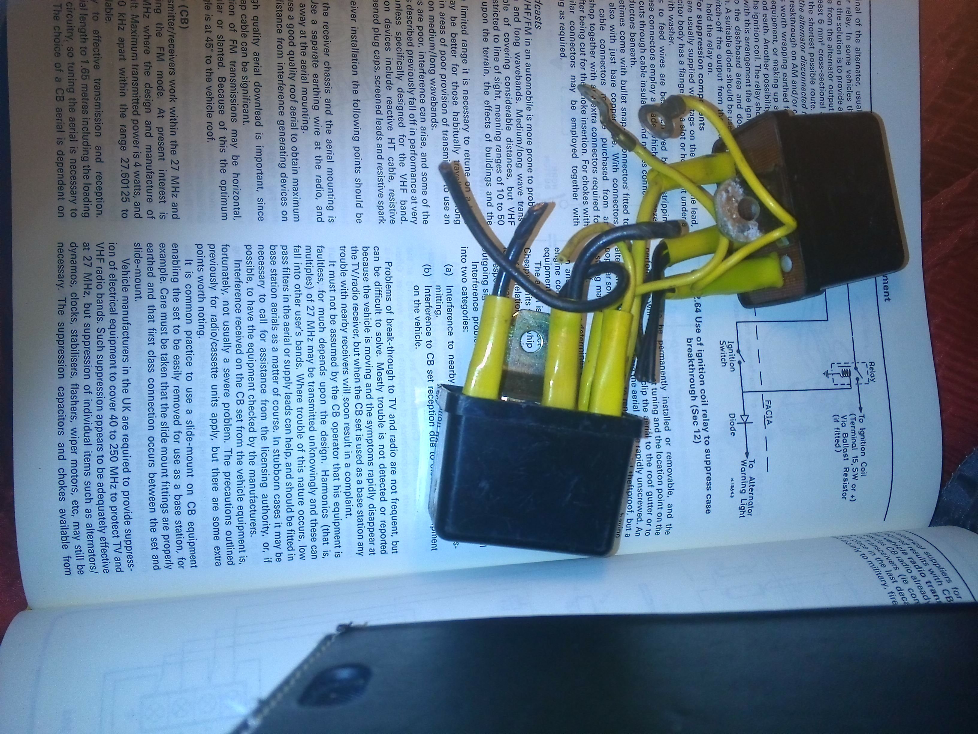

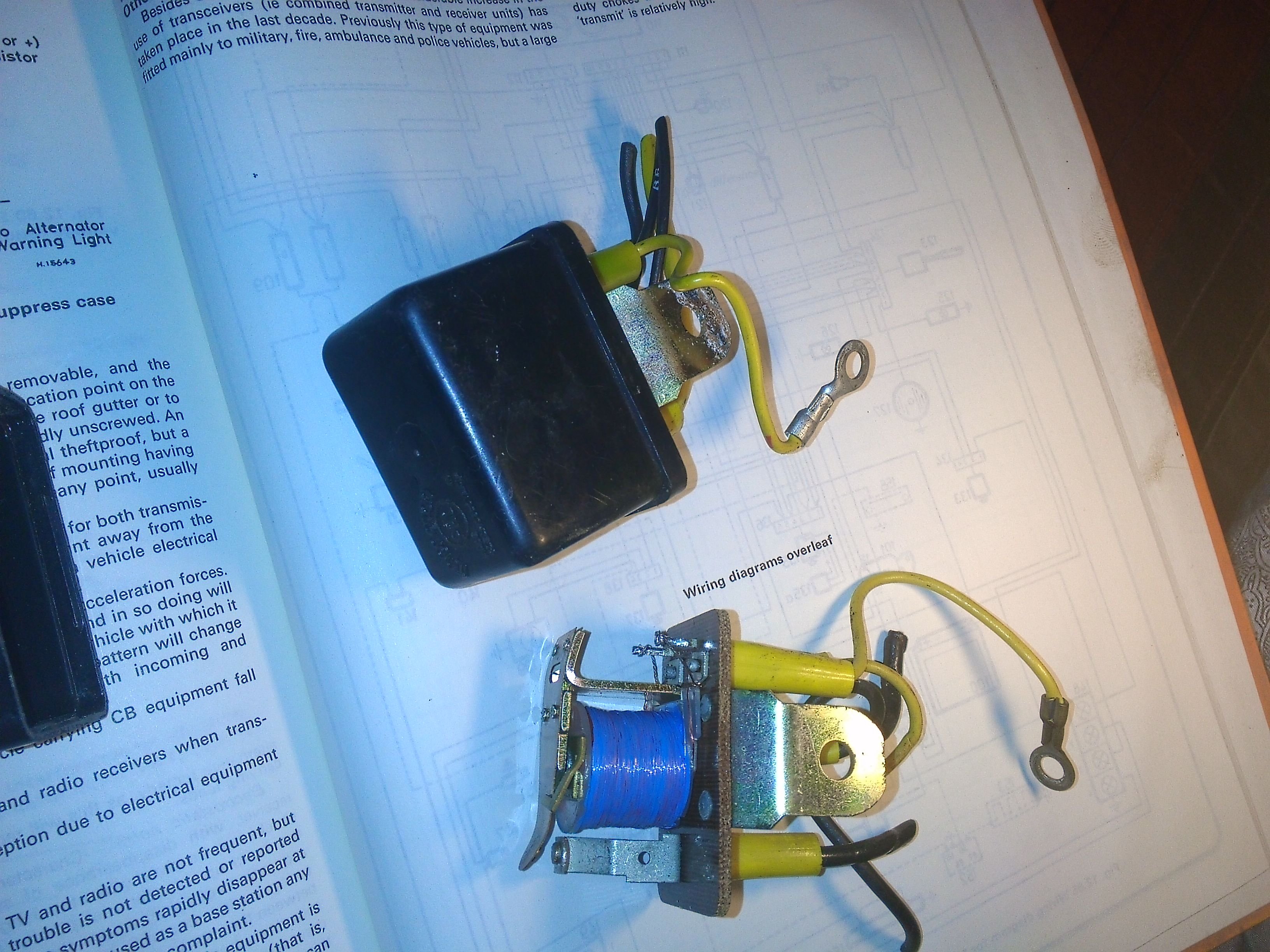

  21. The reason for my contact is that I'm looking for the following.... I'm looking for spare items .... I think they are called Auxiliary Headlight Switching Relay for a (1988 Skoda Estelle Rapid 130 model) there's one in the front boot and one near the coil (engine bay) .. Please help pictures attached.... Does anybody have old parts ??
  22. The reason for my contact is that I'm looking for the following.... I'm looking for spare items .... I think they are called Auxiliary Headlight Switching Relay for a (1988 Skoda Estelle Rapid 130 model) there's one in the front boot and one near the coil (engine bay) .. Please help pictures attached.... Does anybody have old parts ??
