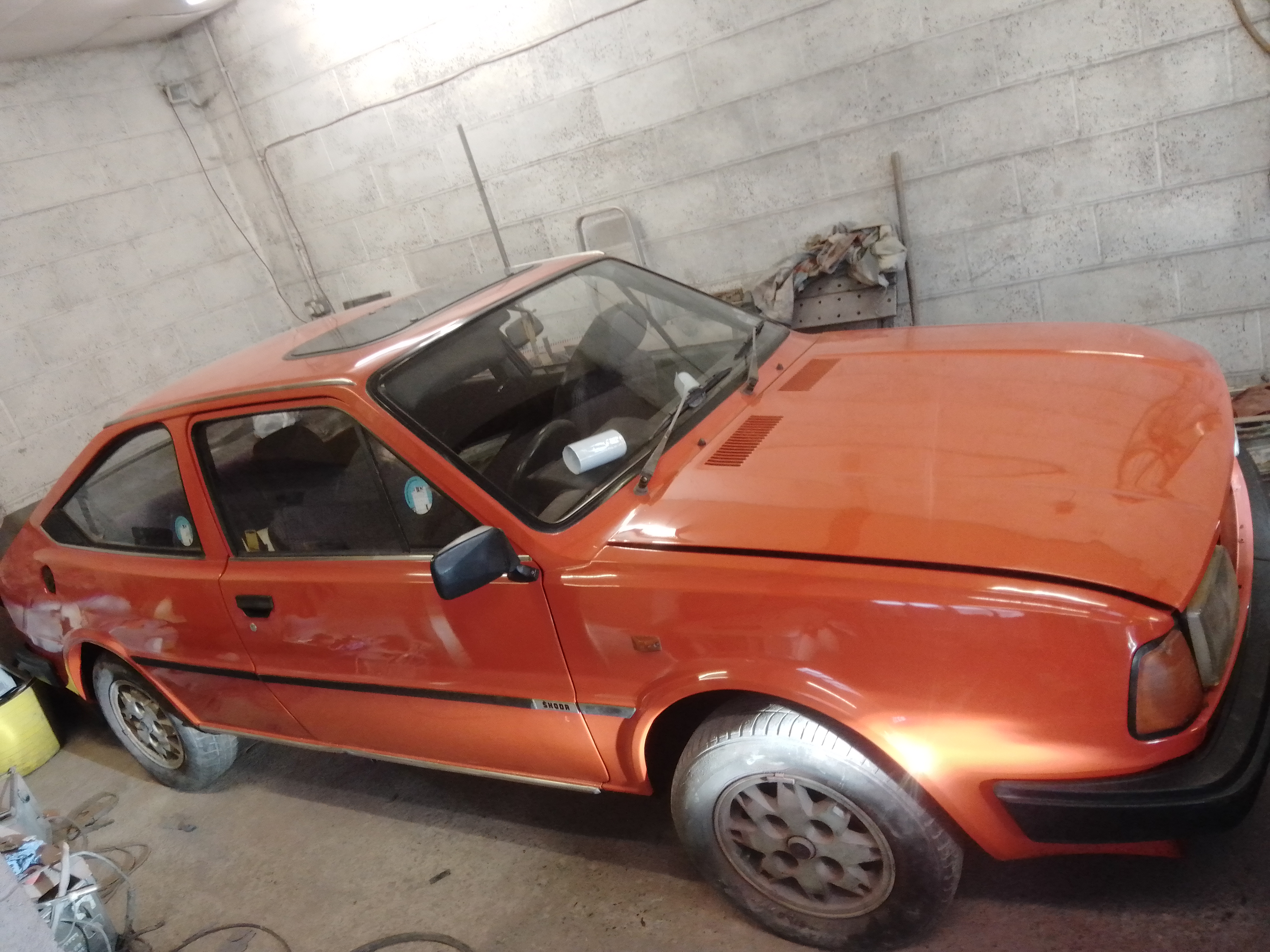

After resorting my Skoda Estelle Rapid 130.... I need members help on a Mechanical Fuel Pump or a work around with an alternative.... Can you ask if anyone has one for sale 'complete' or if you can advise on a supplier .... Had the car working bypassing the fuel pump .... Pipe from carb attach to electric fuel pump and then other pipe in petrol can .
The fuel pump is bone dry and ain't dragging petrol from tank 😬😳
