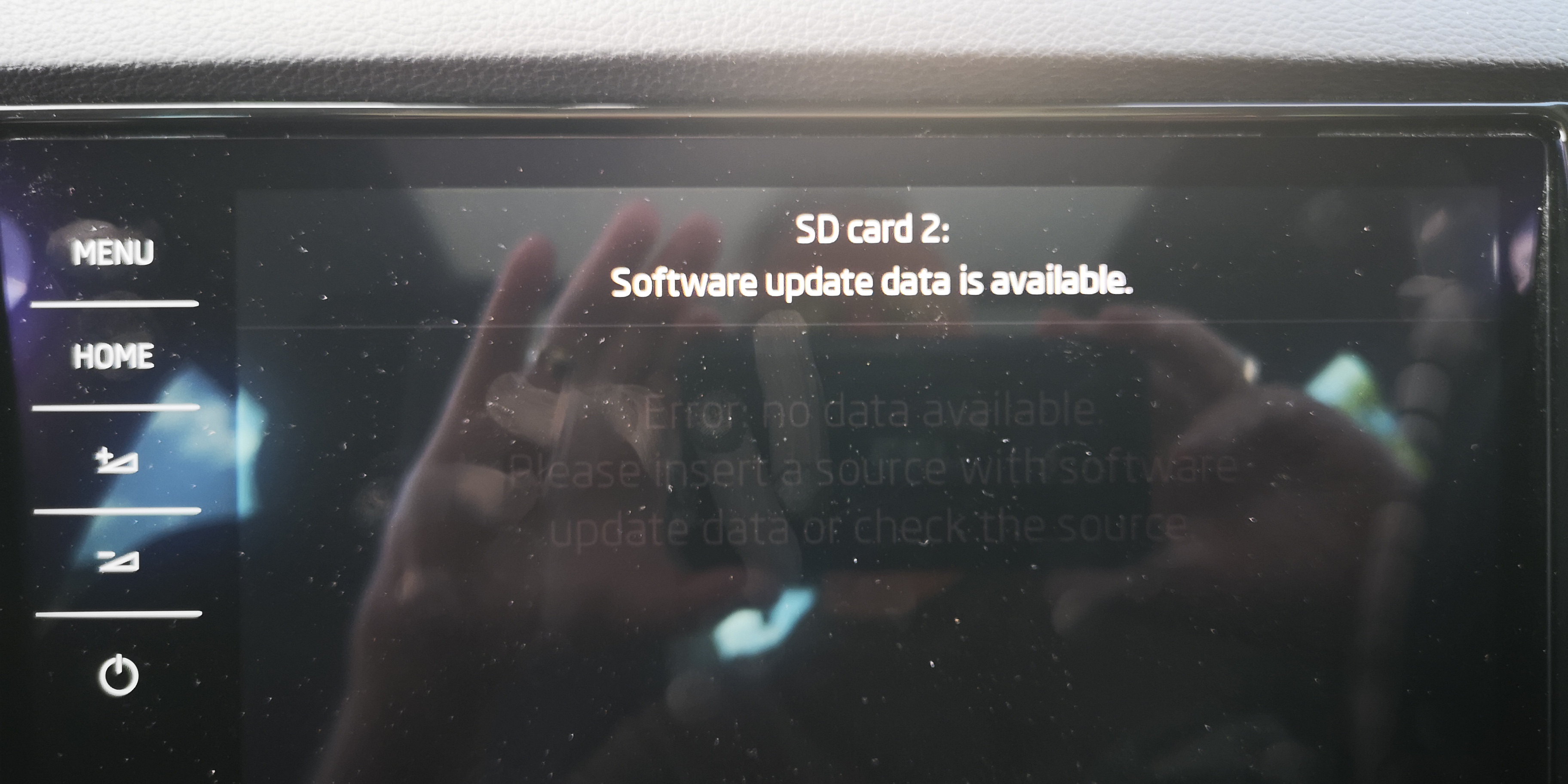

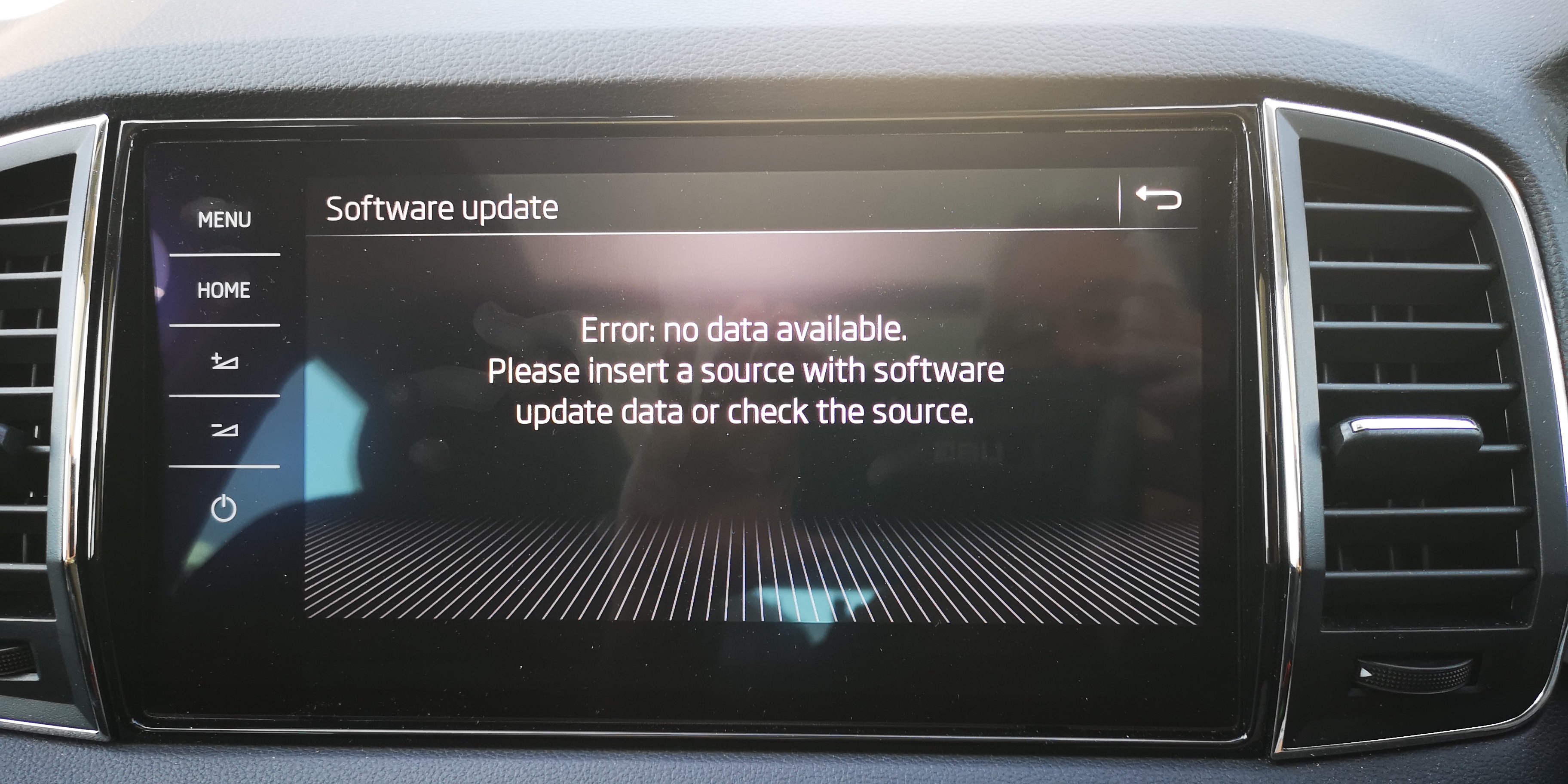

  2. Figgis replied to Figgis's topic in Skoda Karoq
    Problem solved. Formatted SD card on a windows laptop ExFat (64gb card) allocation size 2048 (as on my Mac it doesn't actually give the option to choose) Unzipped the download straight to SD Card on laptop. Everything after that worked fine. At least I shouldn't have a problem next time. Thanks for all your replies.

  5. Figgis posted a topic in Skoda Karoq
    Having read lots of posts on map updates it seemed relatively straightforward. Well how wrong can you be. Downloaded maps (using vin number) HIGH12_P330_EU_202322.zip, unzipped files, formatted 64gb SD card exFAT, Copied unzipped files to SD card (no hidden files) Moved to Karoq to install. Display says Software update is available SD 2. Select update from SD 2 little spinning icon then message "error no data available" See pictures. Any suggestions welcome. Thanks
