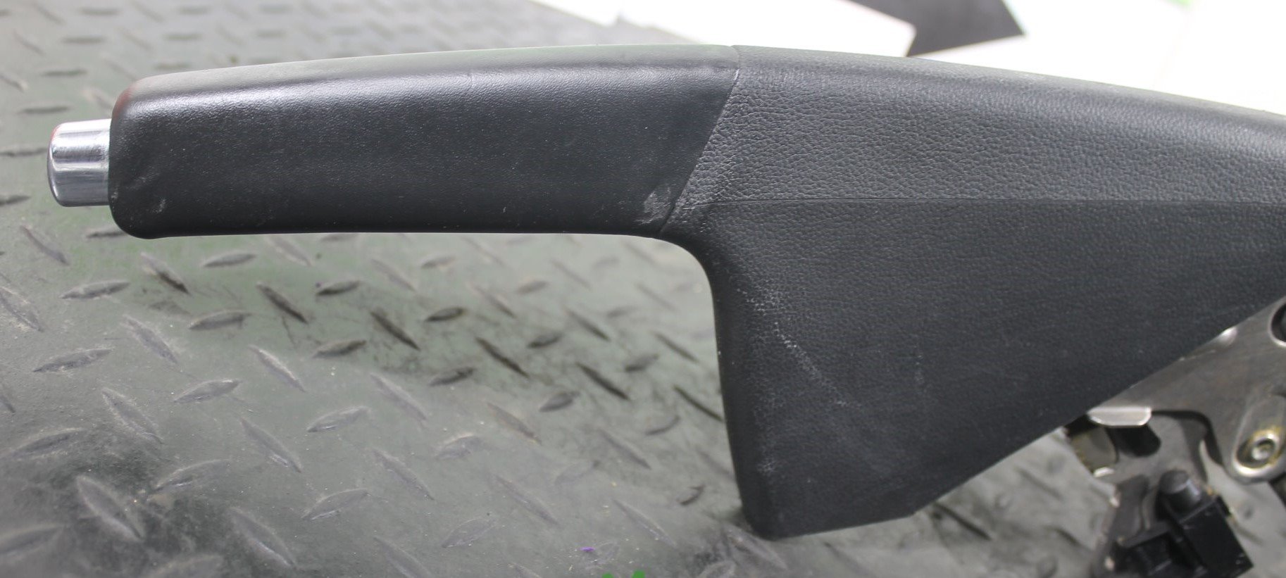

  1. Thanks for that. It looks like I will have to spend a few quid on a new one.
  2. That is very useful - many thanks. I would say that it doesn't seem very straight forward ie having to pierce the leather. Think I will need to do some further investigations. Thanks again
  3. Hi There. Can anyone tell me how to get the leather grip and rubber gaiter off the handbrake. Mine has separated and the leather/rubber join but I cant see how you remove it to either replace or repair. I have watched videos for handbrake cover removal in general but they all refer to a small clip on the underside.....but mine doesn't seem to have this. It looks like the image attached. Any guidance appreciated.
