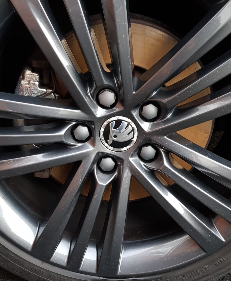

Excellent! I'll order a set. Thank you very much indeed.

Hello all, My centre caps are looking a bit tired, are these just a self adhesive badge or do I need the whole centre cap? Thanks

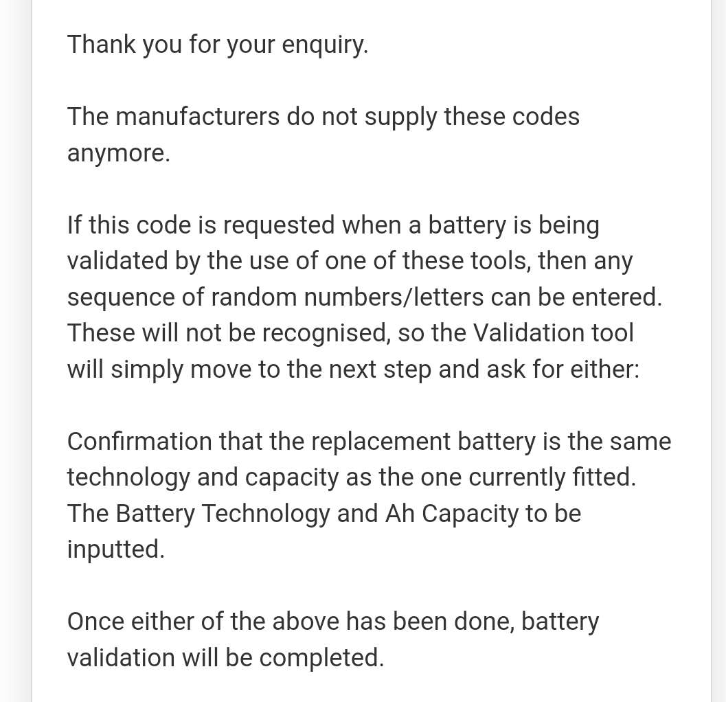

Just had a read, info about battery production date is useful, seems the old battery is the original so it's done well, managed 73k miles and 8 years old. Thanks for your help.

I've got no new fault codes so I'll see how it goes. The start/stop is now working.
