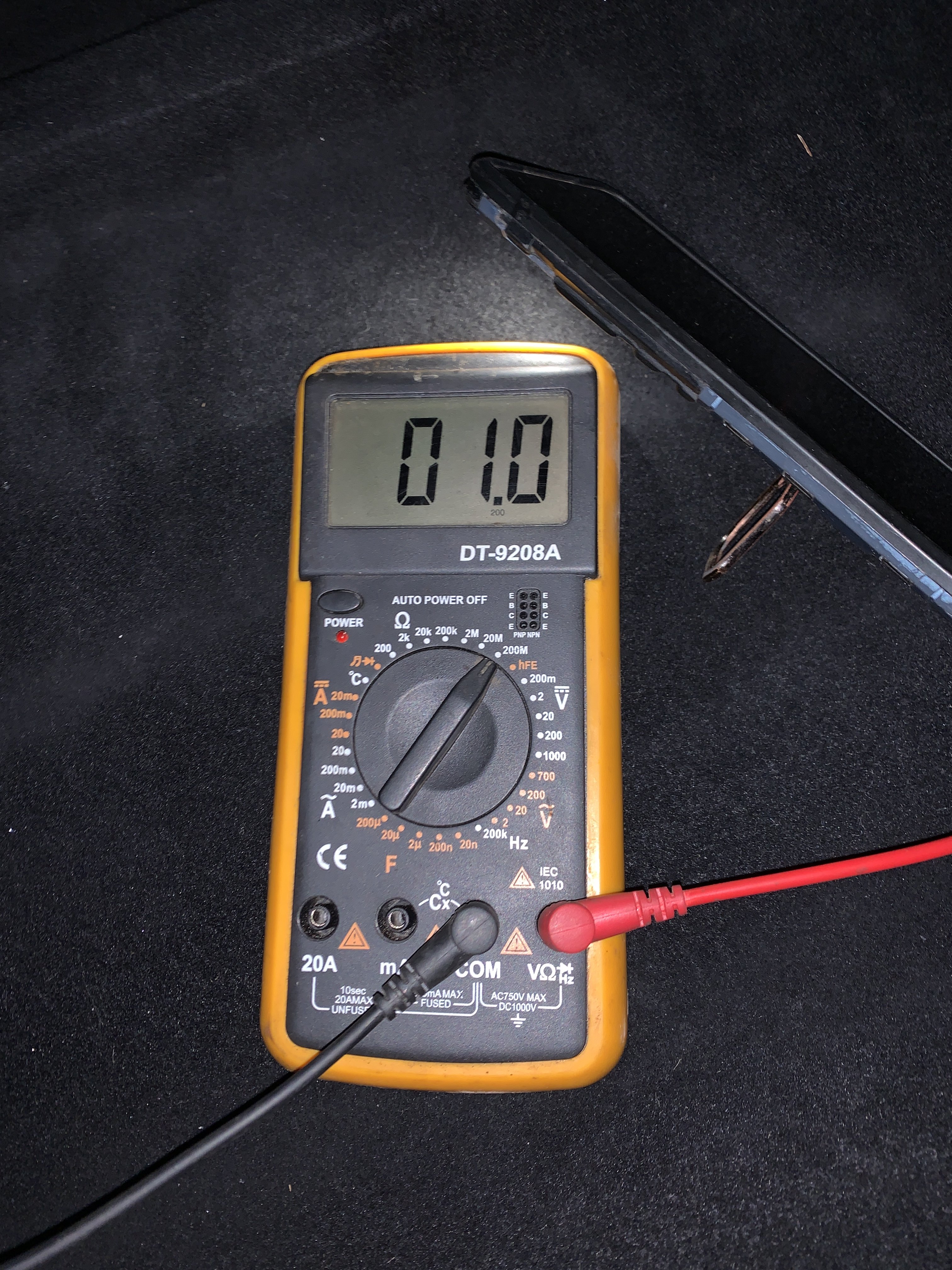

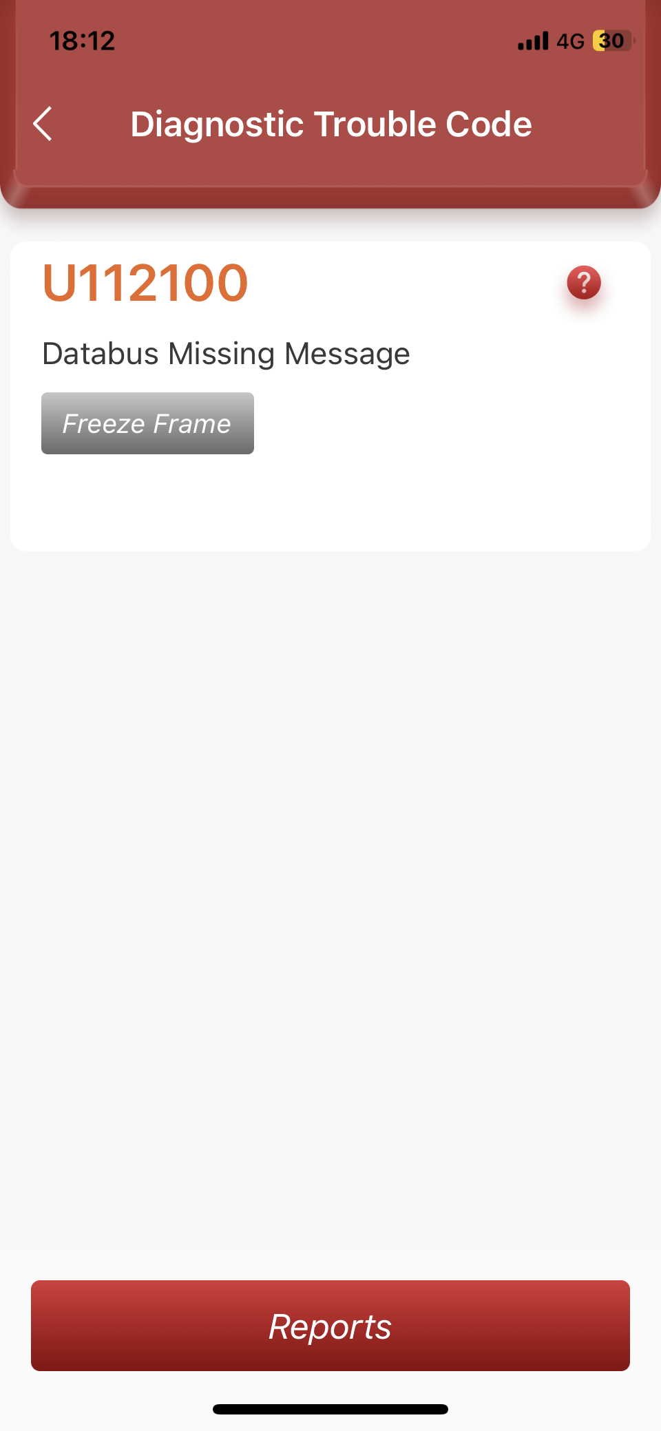

  6. Ok so for an update. Managed to grab the codes which lead me to nowhere. Also measured the resistance in the heating element for comparision if anyone will measure theirs
  7. I will try to grab the codes and test the output to see if it is actually generating heat, both in one go. As for the resistance measurement, since base values are not stated anywhere a reading won’t help me much, that’s why I did not bother. Won’t know if it is off base values.
  8. That would be awesome, just not sure how to interpret this information, how could the resistance change in the heater element (to make a diffrence)? If it had burned, would it not just be cut off somewhere, reminding that I have done the continuity test. Also you will probably have to remove the plastic trim around the perimeter to access these contacts (they are on clips, no screws). And there are more than two connections on the glass, so make sure if you are measuring to document in between which contacts the resistance is measured. I am also in the process of getting AutoData license from my ex-University I have studied in, we had access to it while studying, hope the teachers are in the mood to lend a single login the diagrams should be helpfull. Thank you very much again, Kev.
