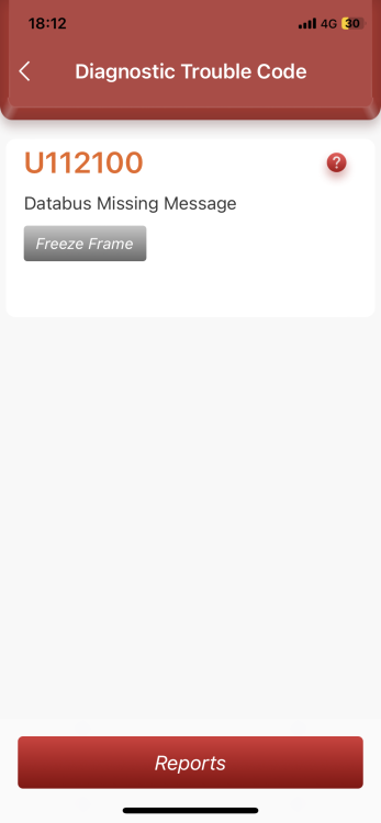

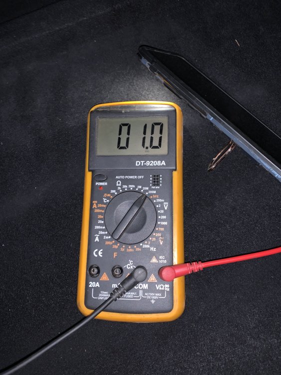

Managed to grab the codes which lead me to nowhere. Also measured the resistance in the heating element for comparision if anyone will measure theirs
Well, that's your problem then. Your heating element it virtually open circuit at 1 Mohm. Assuming a maximum 30A fuse for the circuit then the resistance is of the order of 1 ohm or less. This would result in about 150 watts whereas your 1 Mohm would only produce less than a milli-watt.

How/where did you measure the resistance?
Did you try at the lower resistance ranges? It should be measured on the 200 ohm range.
You should be able to measure the resistance across the 2 connection points to the heating element. If that is where you have measured then you have a bad connection to all of the paths in the demister so the problem lies at the point where the terminal is connected. Loss of one or more of the individual elements would only increase the resistance slightly, certainly not into megohms.

I did, at the connection points, the last option was the only one that gave a reading.

Hello again everyone, I was feeling that I own everyone a reply, was just postponing it because TL;DR have not yet fixed the issue.
For clarification, there was a mistake in my previous post. The heating element is not opened. It is acutally reading 0,8 ohms (had to change the test leads because they were ****e). Have also voltage drop tested every line of the heating element, every line is in tact. no luck. (used a partner that forced the activation of the element through a diagnostic tool.)
