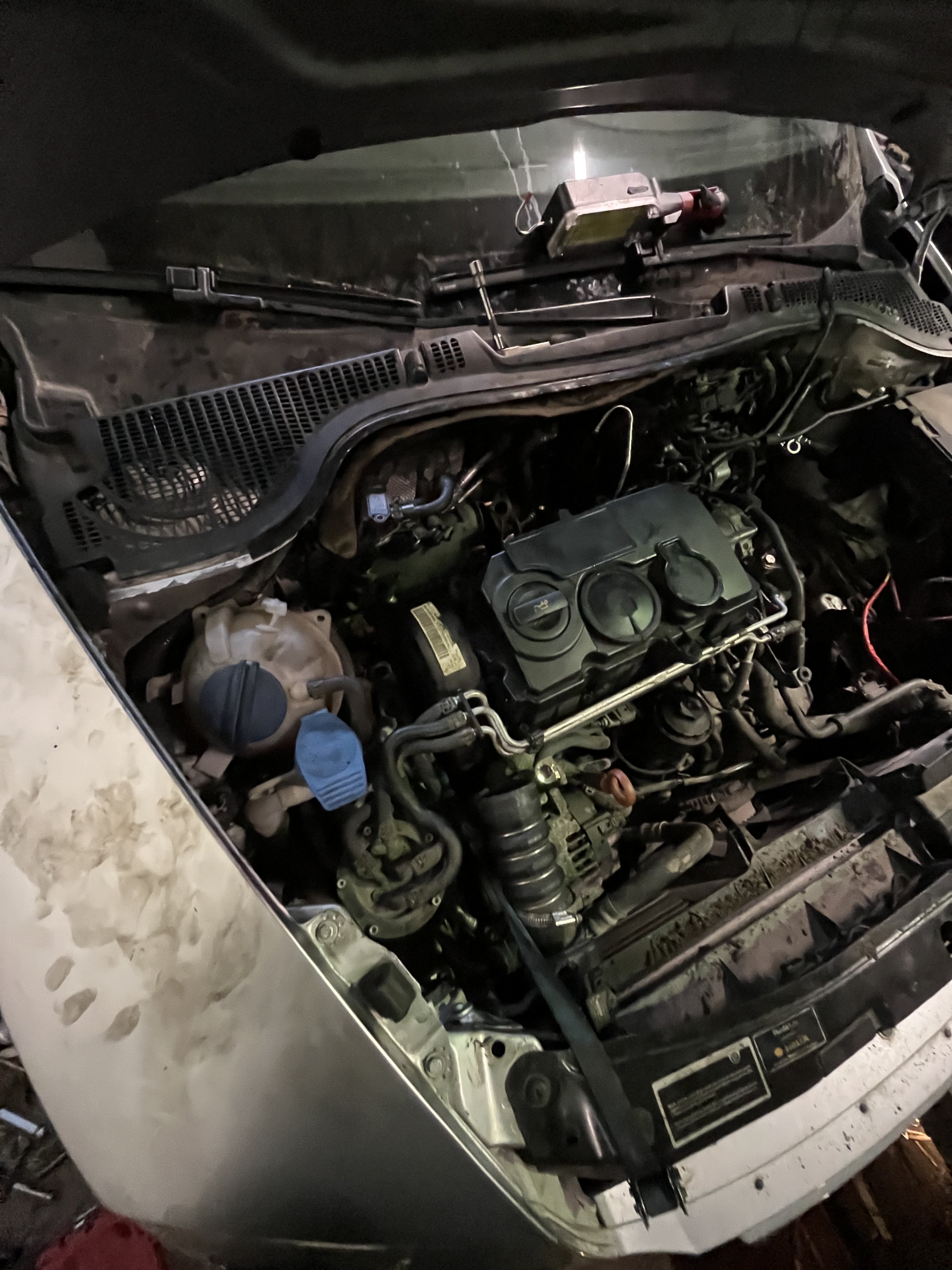

Changing Turbo on a 4x4 1.9tdi, Help/advice needed
Thats nice to hear ! 🤩 turbo looking so destroyed 😀 do you want buy brand new or refurbished ? And be careful with this tube, I broke it and it was carrying a booster for brakes (that is translated) brakes were not working properly 🤦♂️ it's coming from vaacum pump to servo cost around 40€ 🥶
Yeeees its working 😍 after about 10 hours with breaks 😍

whole with manifold, refurbished cost me 220€, i gave them my old, and wait 3 days for it. @hectus https://cardiagn.com/skoda-octavia-ii-1-9-77-kw-tdi-pd-engine-bjb-bkc-bxe-bls/ here is workshop manual 😍 i finnaly find some working

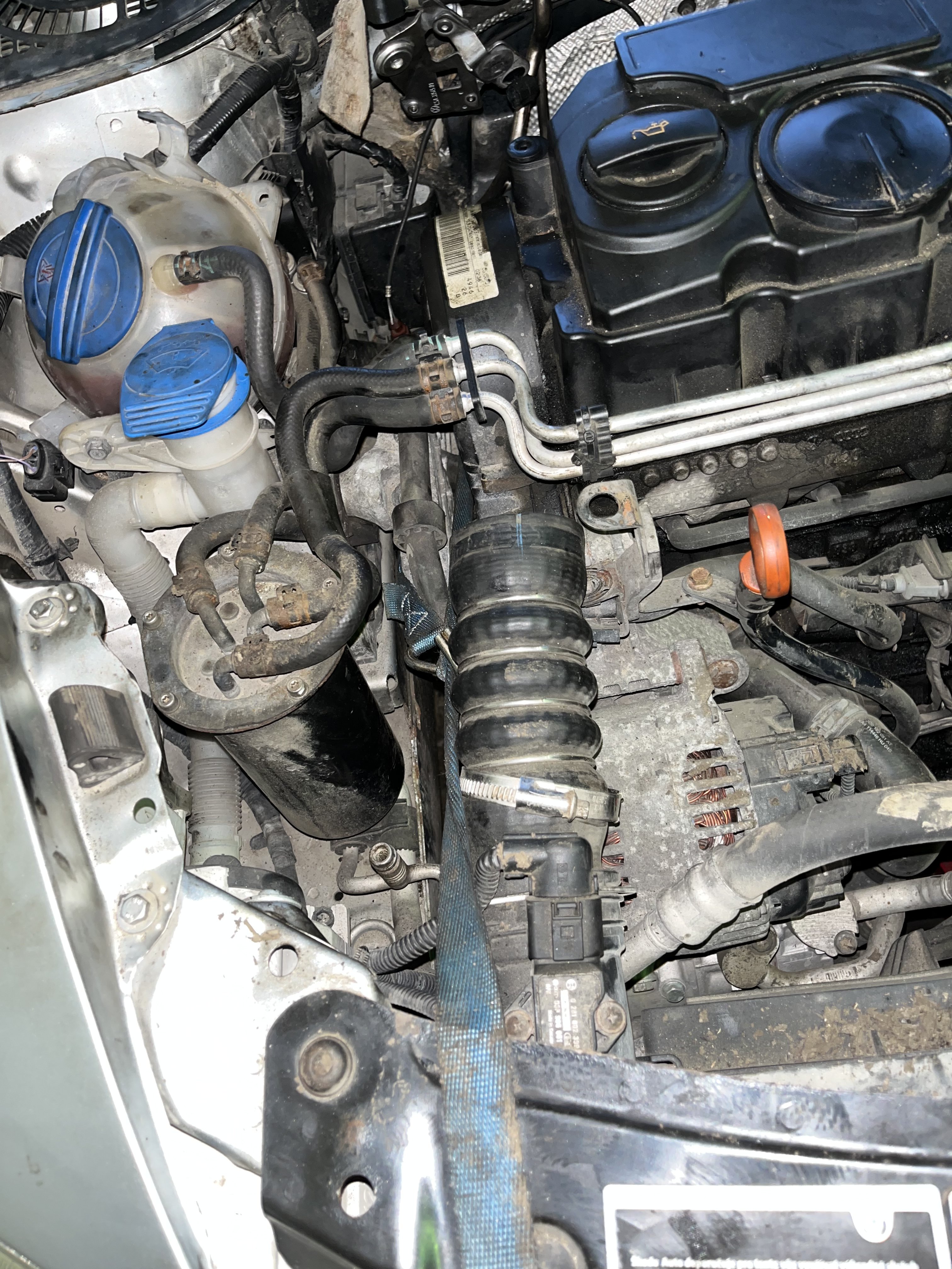

yes bushing on the left side, if you dont have DPF i think it will be easier Video of mine turbo https://files.fm/f/at8q2pk6s

@hectus silent block, or bushing i dont know i only unscrew DPF filter, and left wheel, and that shaft that coming from gearbox to hub. tommorow i will flush my intercooler, i try something but i dont know how. some tutorials should be on interner i will watch something

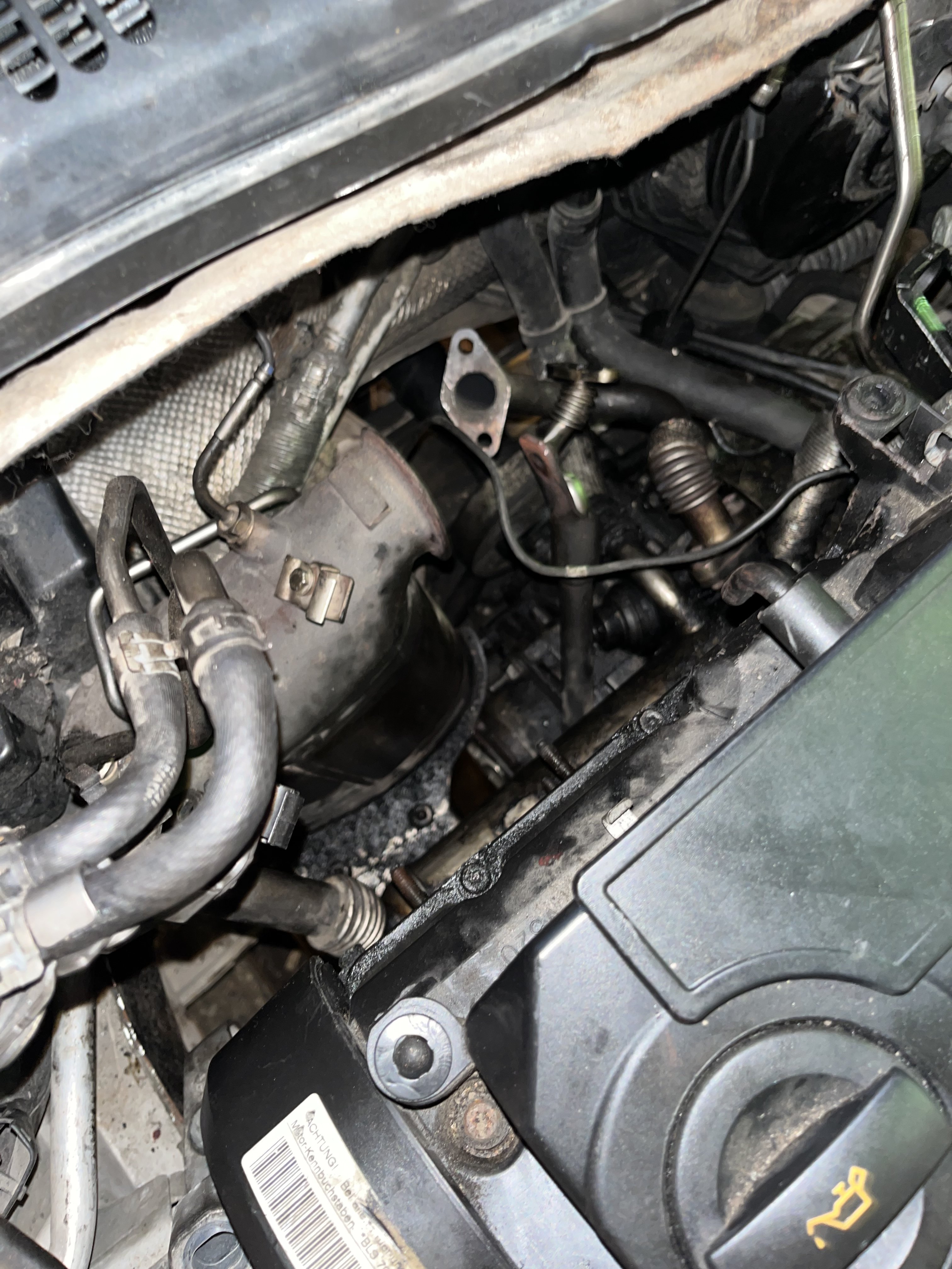

The turbo has arrived, I'm going to install it tomorrow 😀 I hope it will be successful because I'm a trained electrician from school and not a mechanic 😂

yes, I removed only 1 of the 3 Bushing from engine, and then ratchet and i pulled engine to front yes its 4x4 6 gears 77kw 1.9TDi sorry for my english i am from Slovakia

Hi, yes, i waiting for refurbished turbo now, I only disassembled the right wheel, intake, battery, removed the silentblock, pulled the engine and removed the turbo and intake, it was difficult but 5-6 hours, the mechanic told me that it would be 700-800€ to repair, so I'll try it myself. if you have questions, feel free to ask
