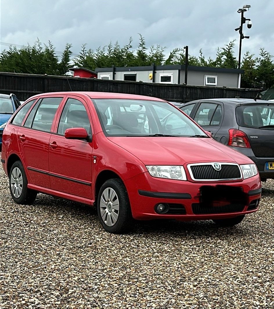

Been a while, but in the end we just scraped it. Our Lad buggered off to Wales with his latest skanky gf, had a baby with her, fell out and is still there no job no money. Tbh were happy he’s out of our hair. But on the fabia front, been keeping our eyes out for a similar fabia but in estate form for our own use. Was so impressed with the lads one, everytime I had to do anything to it was generally pretty easy. Everything came apart and went back together as intended. Genuingley feel these are some of the best engineered cars out there. So a few weeks back we happened upon a 56 plate Ambient 1.4 16v 100hp estate in my favoured Red with just 47k on it. Got a fair bit of history and the mot history confirms mileage. So we’ve bought it. Needs a few bits, noisy cv and I’ve not seen any evidence that its ever had a cambelt change. So both are top of the list before we use it too much.
