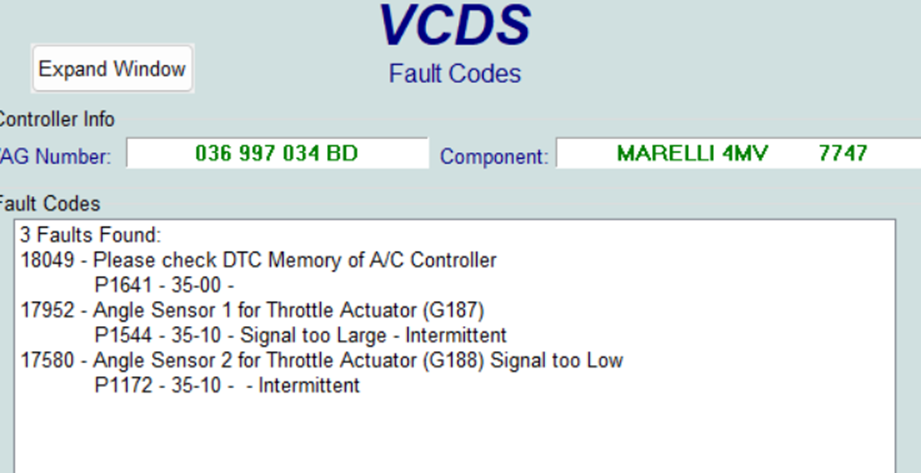

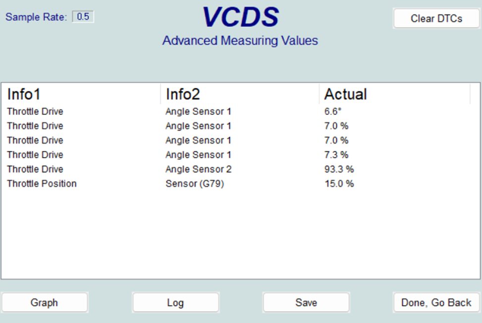

  4. Is this with the vcds? I’ll have to find it. I did a test that when I pressed the pedal , it showed increased/decreased sensor setting but the throttle body didn’t move.
