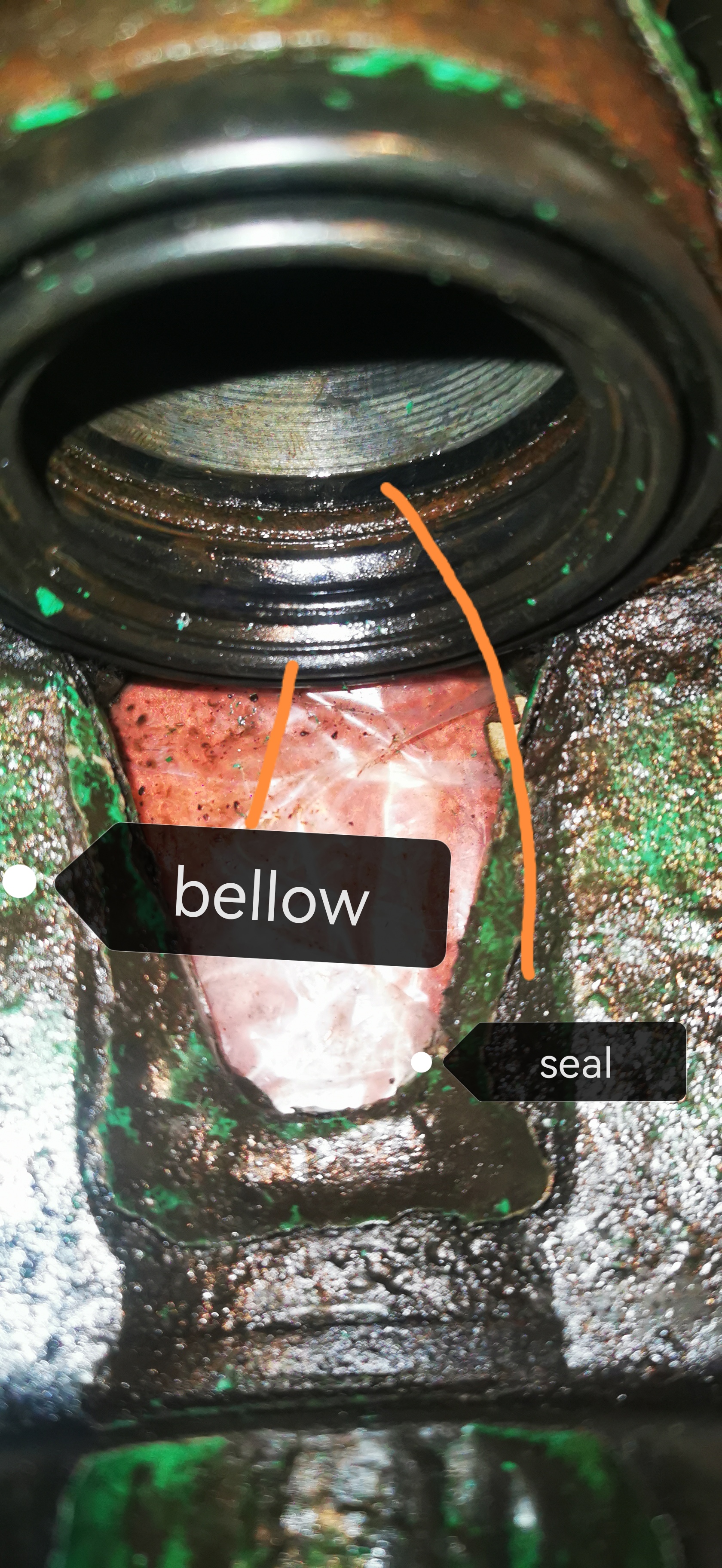

  13. sorted , got them both out.πŸ™ the seal and bellow are looking alrite so might get away with cleaning everything and putting it back together to tide me over , but gonna buy some new ones anyway. gonna try this ultrasonic cleaner bath thing out and see how it works out on it all πŸ˜…
  14. is this the parts correctly named? gotchaπŸ‘
