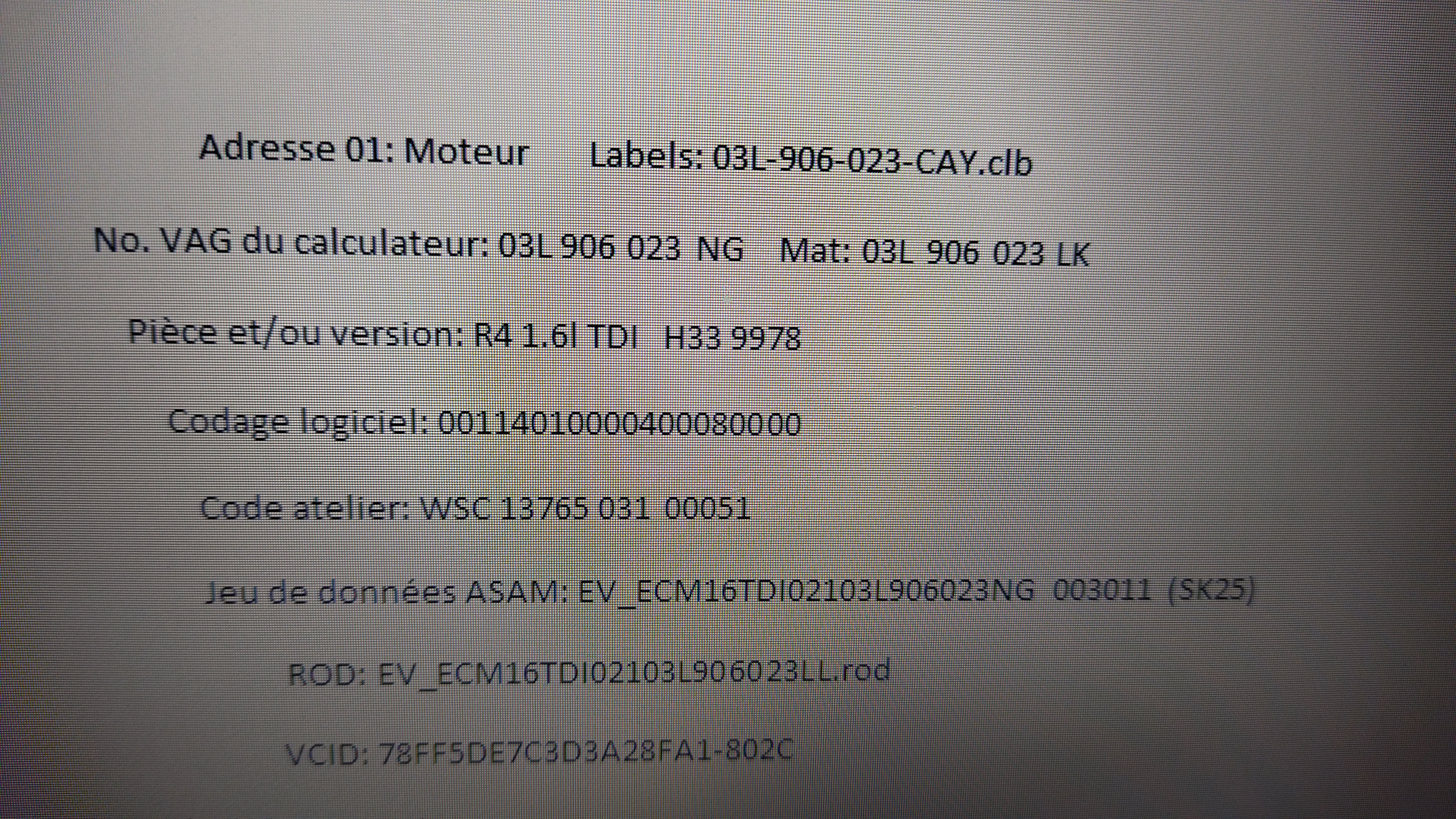

  8. thank you so much yes I have vcds, the last regenerations occurred after 148 km and the second after 214 km. the calculated and measured soot mass returns close to zero after each regeneration. but the calculated soot mass is increasing very quickly (no vcds fault code). example: the last reheeration was triggered with the following measures: soot mass calculated: 24 gm soot mass measured: 0.4 gm mileage since last regeneration: 214 km
  9. thank you for the answer the mass of soot measured barely rises to 0.5 gm in 200 km but the mass of soot calculated arrives in less than 200 km at 24 gm which triggers regeneration.
  10. thank you for the answer the car is a fabia 1.6 tdi 75 it has 158000 km. scan vcds no fault code. I measured the soot with vcds. the soot level returns to 00 after each regeneration but the calculated soot level increases rapidly which triggers a new regeneration. the level of soot measured is correct it increases slowly (G450 changed and adapted). I have to find out why the calculated soot level is increasing rapidly and thus stop the repeated regenerations.
