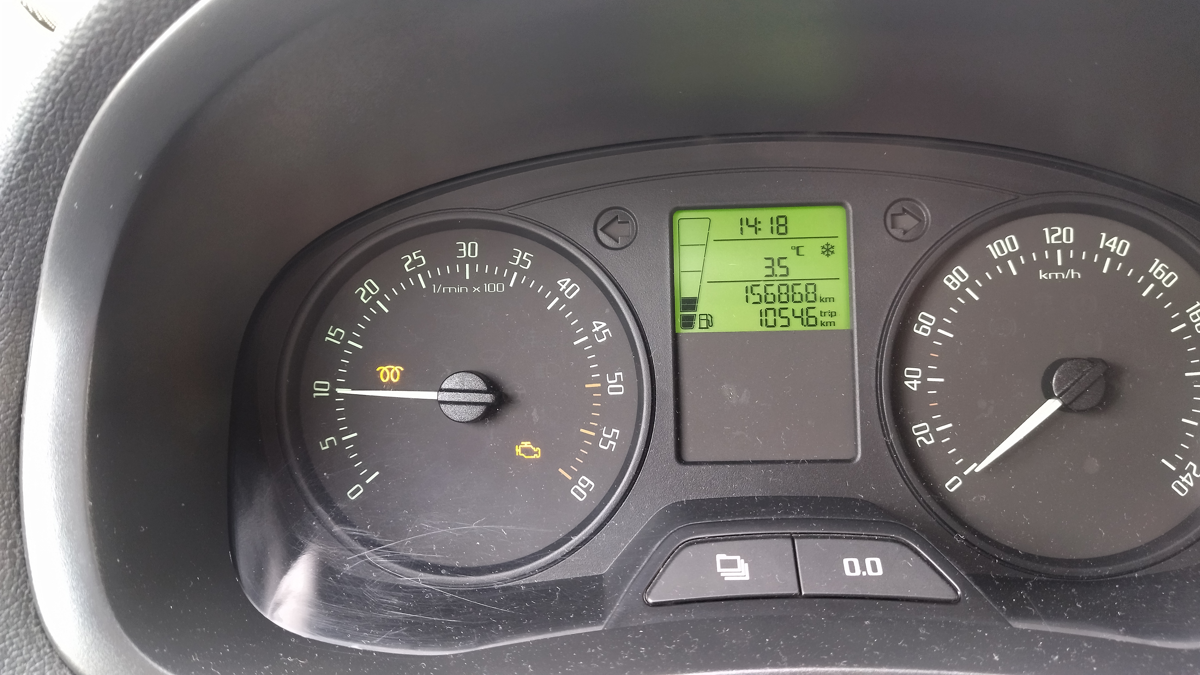

  17. HELLO my 2011 fabia 1.6 tdi does repeated regenerations even when cold. regeneration is triggered whenever the calculated soot measurement reaches approximately 25 gm(vcds) I changed the FAP differential pressure sensor and erased the faults (no faults) but the level of soot (calculated) rises rapidly and after a week regeneration is triggered (even when cold) which causes post combustion and sends FUEL into the engine oil. someone can help me THANK YOU
  18. Bonjour j'ai une fabia 1.6 . elle déclenche une régénération environ tous les 200km. aucun defaut tableau de bord que faire ?
