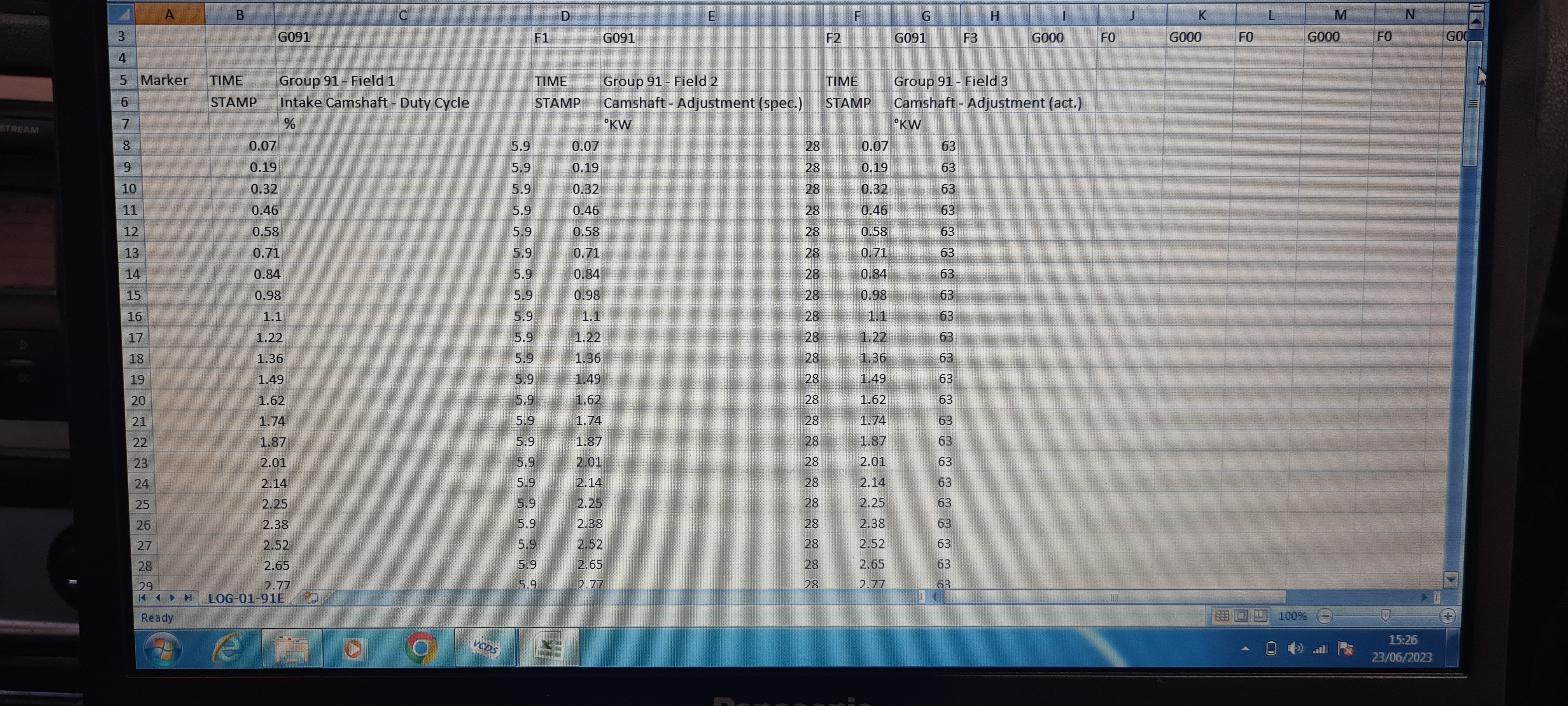

  5. Hi, Help from the gurus if possible, Have done quite a few bits and pieces recently, But after changing the intake Camshaft due to lobe wear, I now have a complete lack of power, Already had - DV valve (previously) Camshaft control valve Camshaft chain and tensioner Camshaft sensor Pump cam follower Power drop only happened after intake cam change, Double checked Camshaft timing yesterday appears OK by eye There is no engine light, and no codes from VCDS, just the following from live data, Turbo does kick in eventually (higher in range than usual) idles ok and runs ok, just no power, bogs down when trying to pull away in 1st Any thoughts? I'm thinking possible timing valve oil control rings, that or the Camshaft lobes are out slightly... 2005 Mk2 Vrs TFSI engine

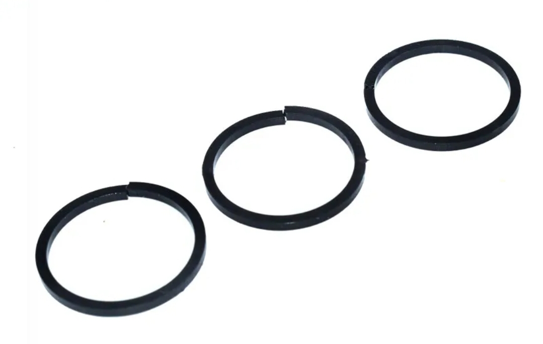

  6. MK2 - main timing is by belt It's the plastic sealing rings on the inside of the cam chain cover that sits inside of the VVT pulley Codes are - P0011 and P0341 Drives fine until sat in traffic for a while, then try to drive after clearing traffic and bucks like a stallion with ESP light flashing, Broke down yesterday, cut out, when trying to pull away from lights all lights on dash with a warning sound like a flatline from the dash, but started straight up after a couple of mins sat still not been able to pull codes yet, need to wait till back at work and plug in the texa

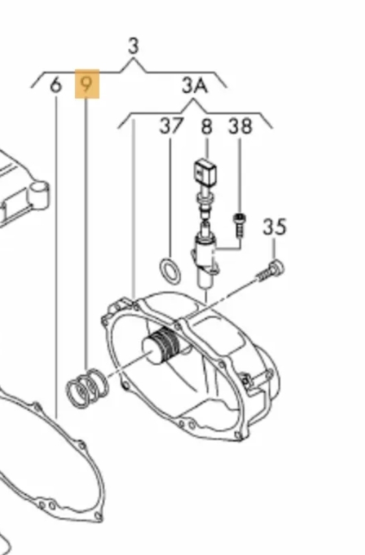

  8. Thanks, KM said they couldn't cross it over and cant guarantee the cover will fit ๐Ÿคจ (but the rest of the kit will - and it has) I was guessing that the numbers are the same just the last letter, so it's just a newer revision of the cover ๐Ÿค” they just didn't want to commit to it Thanks for your help
  9. Ideally just the cover, I've done the chain and tensioner and control valve, but one of the seals on the inside of the cover has snapped Used this set - https://www.kmotorshop.com/en/article-detail/view/132221/timing-chain-kit-rs0061-et-engineteam-06f109088j-06f109088g-06f109088c

  11. Hi, I need a new camshaft chain cover, Skoda part look up lists part number - 06f103530 F but I can't seem to find the same online, However can find plenty of part number - 06F 103 530 and 06F103530G or 06F103530H Are these compatible and the same just different revisions or they not compatible? Thanks for any help
  12. Had a few issues with the MK2 VRS when bought 2.0lt petrol Had a rattle at idle and a horrible cut out when warm mainly after sitting in traffic - ESP light flashing and engine stutter, had codes p0011 and p0341, p0341 only came active when the light was on and juddering just done cam chain and Adjuster pulley, and N205 valve all good and rattle now gone, but still getting the ESP light and a stutter almost undrivable now (not pulled codes yet) Question is, if the plastic rings in the cam chain cover are damaged or split would ot cause these issues?
