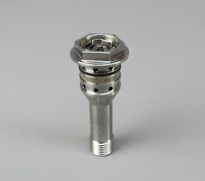

The one in the last picture comes from the top of the engine (super easy to get to with just one screw). It is VW part number 04e906455ac, and is depicted as part #25 on the below diagram (where it is called camshaft control valve). I'm just not sure if it is related to intake camshaft, or if it is linked to exhaust camshaft though. Just in case sharing actual picture of my engine (this part 04e906455ac I marked with yellow arrow, and the magnet solenoid for intake camshaft VW part 04E906423C which I removed in this picture is marked with green arrow).

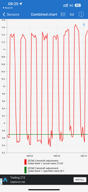

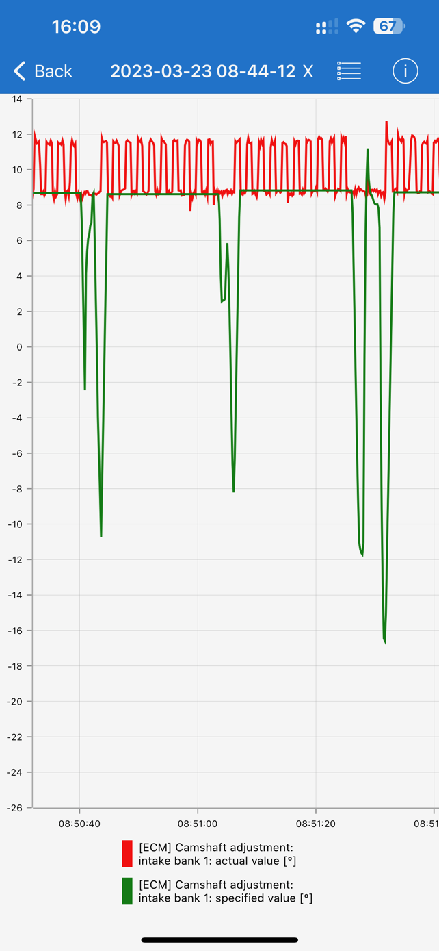

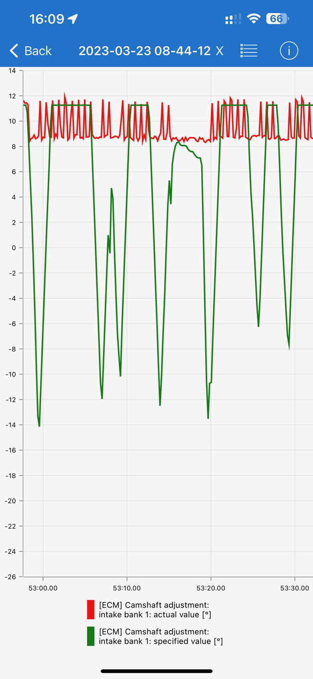

What I cannot figure out is the following. After stopping the car with Start/Stop on (hence engine shutting down for a few sec), of course while still on relatively cold engine, when I resume driving I get the below reading (where the SPECIFIED value for camshaft adjuster remains static). During this time I tried accelerating, decelerrating, and that still did not move the SPECIFIED value. If the magnet was stuck, I would expect the actual value to get "stuck" like this, while computer continuing to dictate proper specified value (which would then also vary with pressing of gas pedal). In my case, I see the opposite happening with specified value getting sort of "stuck", while the actual seems to cycle through a few degrees up & down. Again this lasts for about 5-10 seconds, and then everything unfreezes again and behaves normally, but I cannot understand the logic of why would specified value not react during this time to acceleration (as in all other cases it does react immediately to changes of driving performance). Does that point to a possible rootcase?

My Car: Skoda Kodiaq 2019, 1.5 TSI DADA engine, 150 Hp In the Netherlands, it seems OEM parts are around 150-200 Euros, but that is fine (I can also start by replacing with 2nd hand part just to check if that's the rootcause). But when you say solenoid - what do you mean exactly as I have 3 parts in this engine, and depending on the garages I talked to they called each of them a solenoid at some point Do you mean the magnet that pushes the pin in/out ? or the oil control valve that sits inside the camshaft adjuster (on which the above magnet is actually pushing)? or the sensor/oil control valve that sits on top of the engine by itself:

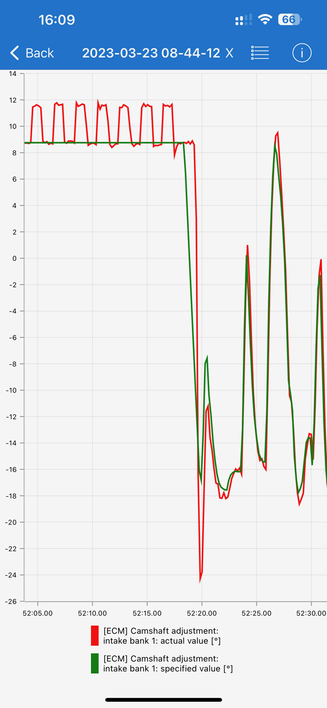

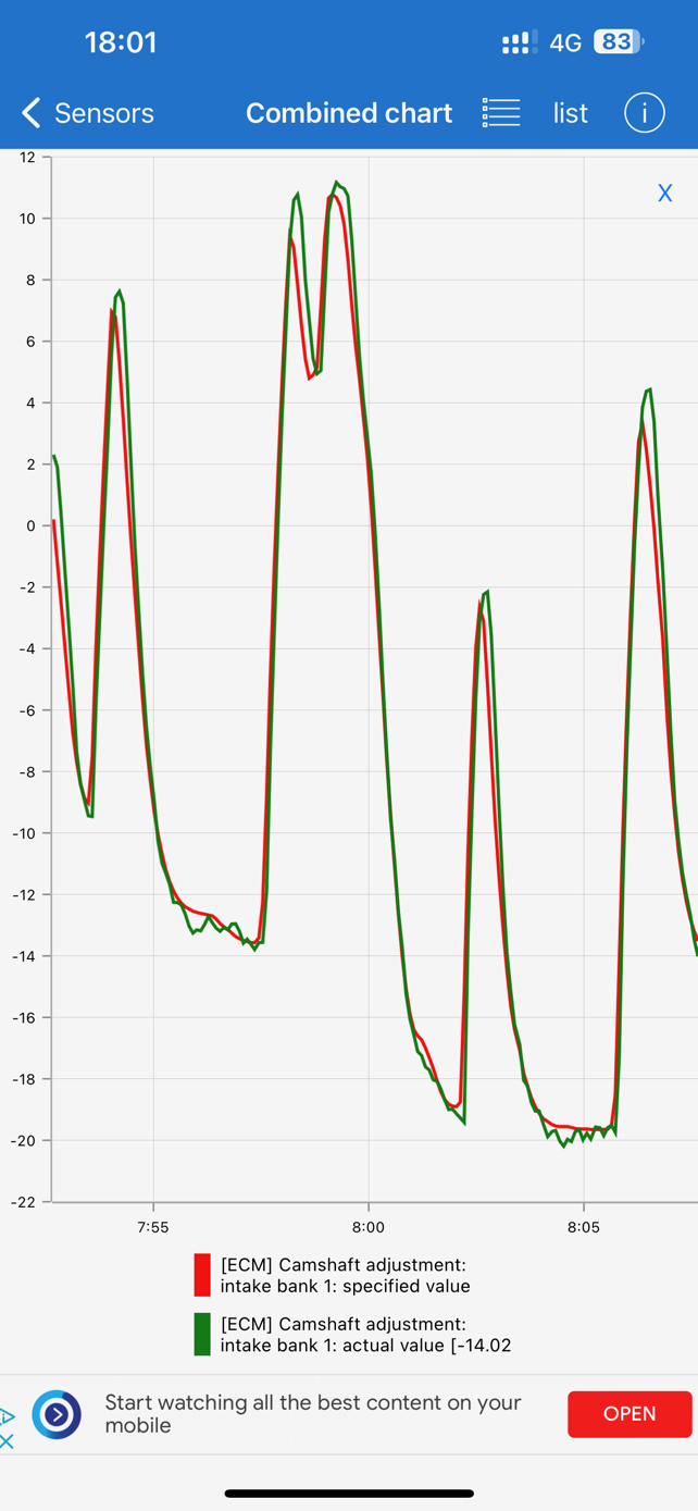

@varooom thanks a lot for your response and the detailed diagrams. If this is indeed such a delicate system, perhaps I should not be messing with it... Perhaps this is what I needed to hear Wondering still if anyone had a similar problem and if there might be a simple solution - i.e. could a simple oil change just fix it (thus not requiring to bring it for an expensive diagnosis or service) ? In the meantime, the issue happened again today right as I was looking at live chart in the OBD app, which allowed me to capture the exact moment on screen. As you can see, the actual camshaft adjustment value for intake bank 1 does not match the specified value for just a few seconds. This is the moment that triggers EPC light to come on. Then it goes back to normal and roughly follows the specified graph. Don't know if this is pointing anyone to what could be the possible root cause of such a temporary deviation.
