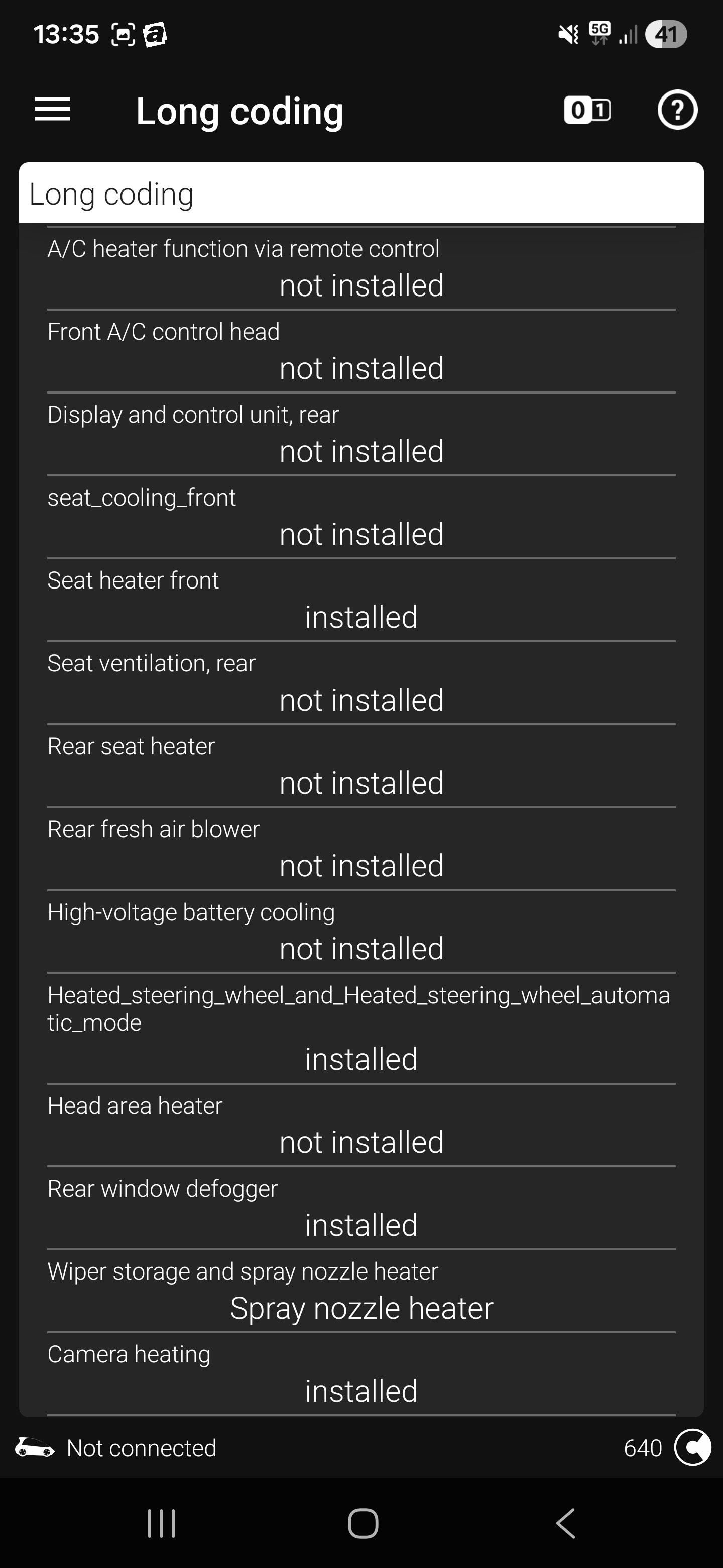

  1. And if in turn on automatic heated steering wheel function and set it on low, it turn on on startup on low and works on low 🤦‍♂️

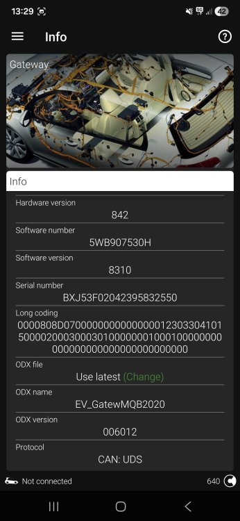

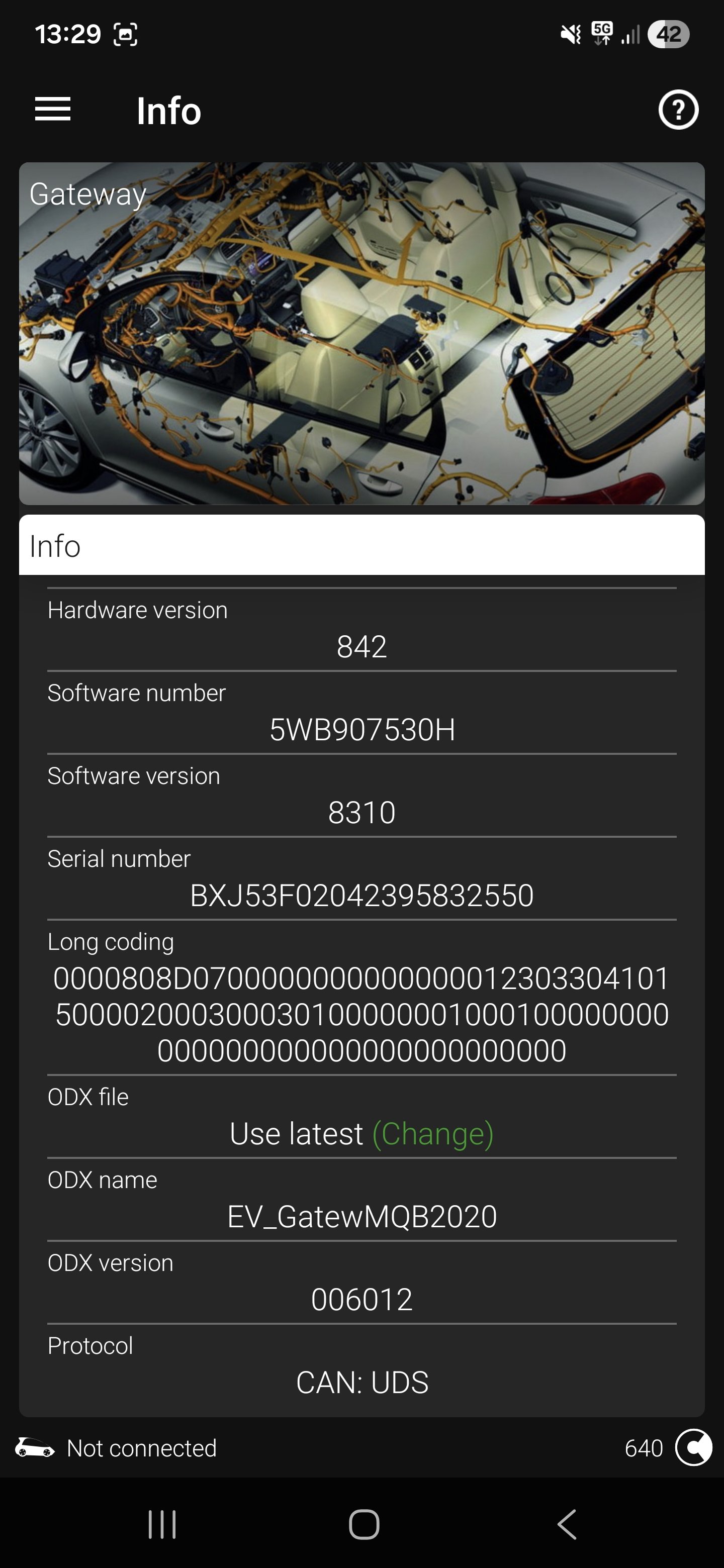

  2. So I finally finished the heated steering wheel. I used the 5Q1953549F ring with the same SW and HW as the original. My steering wheel is 5E3419093AL VKK. The heating works. However, only on high. When I press the button again to reduce to mid, one line disappears but only for 1ms and then the heating turns off immediately. On high it runs normally without problems but cannot be reduced. Any guesses what can be wrong? Thanks

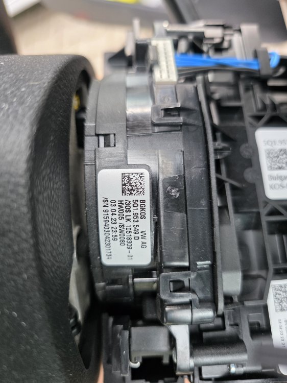

  3. if not whatever... dont care about tahat much i will have not functioning button... , more i need heating, so if someone know what column to use and other parts, i will be greatful
  4. Hello, i have NX 2023 only with standart cruise control and manual gearbox, so i dont need ACC, but i wnat to retrofit heated steering wheel and code TA it shoud be possible without capacitve stearing wheel.. Can somone help me with parts? I just dont know wich steering column i have to get ? I found 5Q1953549A, it shoud have heating but i dont know if it is the correct one for my car, than i need the cable (that from ali for 5q1 is good i thnik ? ) and steering wheel. Coding for heated wheel is the same, and TA i found on obd11 forum and someone sad it works good without acc and capacitive wheel ? Thanks guys for help
