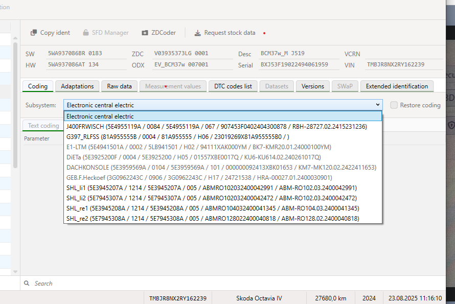

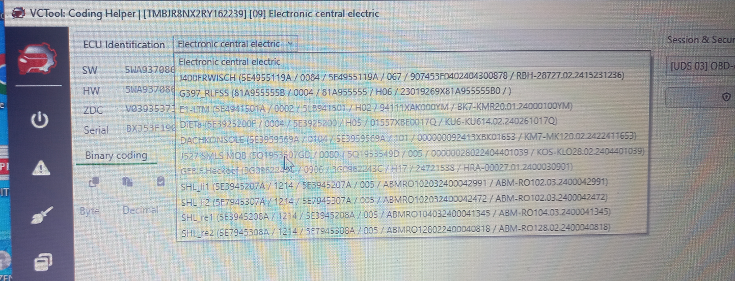

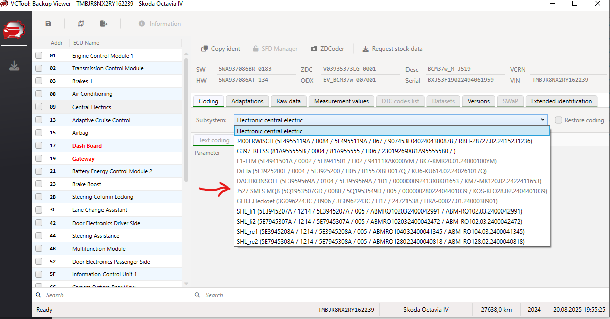

No, I still thinking how to do it. I can't connect to 5Q1953507GF or 5Q1953507GD. It is subsystem under 09 module. I was connecting via VCTool but is grey... On stock server I found data set for that module, but I never flashed subsystes. A little bit scare to damage 09. Any advice how to do it ? image.png

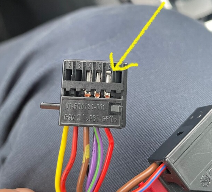

Do you have an adapter for the wiring or are you changing the connector directly? The control unit without heating is wired differently than a module with heating.
No I have no adapter, I ordered new 14 pin connector . I was checking 2 times if pins are in right slots. Heating was working with new module
You dont Check the wire with the Plan?
I have access to Elsa, I also checked other threads where is picture of connector. It is exactly the sameimage.png
OK...
With heating
LIN>vi/gn>T14e Pin 5
LIN 2> vi > T14e Pin 12
Looks good.
Pin 6 ist correct? Looks Like Other als 5&4
Edited by Cairus

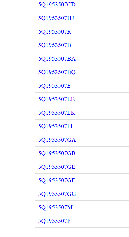

It was disassembled from 5Q1 953 507 GA. Probably if slipper 5Q159354F comes from 5Q1 953 507 GF will work without problems. GA have different ACC switch so that mean 5Q159354F have different configuration inside. I found that some different software are available, by paying 30 eur I can download GF software. So far I have no idea how to upload that without any damage. I uploaded some datasets into 1 level ECU several times, but this is subsystem. That the reason why I asking if someone have some experience on that.
I wouldn't pay €30 for it. What file or data set do you want?
