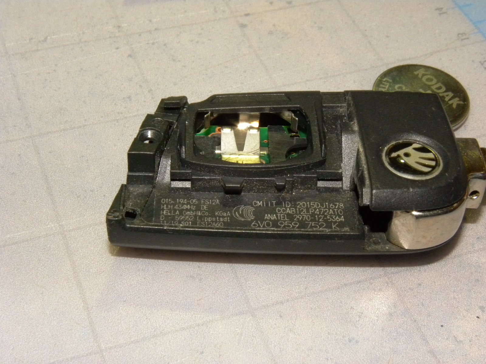

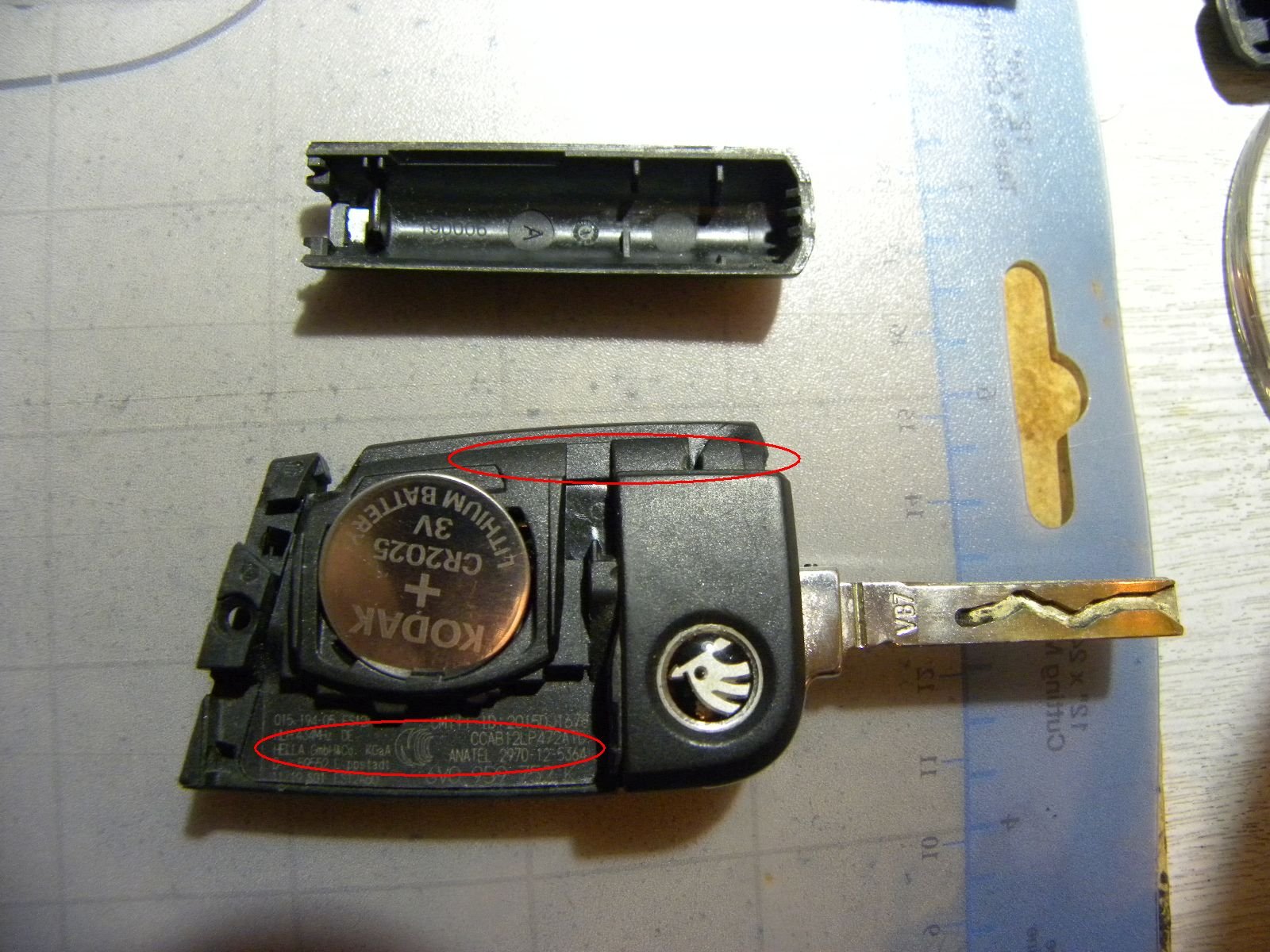

Hi Nigel, Yes, I discovered that there's no progress to be had from removing the skoda viking sticker symbol. As I've worked with this transponder before, and the Hella 434MHz matches, I think there are two possible locations. One is under the text label into which the key-stem folds, and the other is top right of the battery positive contacts. I think this second one is more likely. I don't see it falling out past the metal contacts when the battery is swapped as they block this hole well (see second pic). The plastic clip to the top would be a convenient cover to protect the transponder chip.

Thanks NTA16. All suggestions gratefully receieved. I can see two <~1mm roll-pins, one holding the mechanical keyway stem, and the other as the pivot point of the spring-loaded mechanical key. It wouldn't be the first thing I've disassembled with the outcome of the neccessary spring escaping somewhere into my office.

I didn't need any violence to get to the point in the picture. Popping the right plastic clip did the job. The spring terminals for the battery don't leave space at that level for the coded chip, but it could be to the left of the positive plate contacts, or under the text where the folded key parks. I don't find any easy clips to pop to get the remaining two halves apart, and I want to keep it in a state where I can re-assemble it into a working key when I'm done as it's a mechanical match to the car. Any help here? the main body looks like two plastic shells clipped together, but unlike e.g., laptops, it's not a case of working around the outside with a plastic lever tool.

I can tell you exactly what that is. It is the coded chip, and the inductor allows it to receive power from probably a coil around the key barrel under the cowling. When it gets enough power, it transmits its code. We use them at my OEM employer. What amuses me is that it is an Australian design used to count sheep as they are driven through a large inductive loop gateway. Each sheep can be individually logged.

Thanks Mark. I have an EE degree and enough kit to check a new battery. Where it fails for me is the User manual claim that a fully discharged fob will be sync'd with the car if a button is pressed for 10s without battery, then with a new battery, within 8s press any key on the remote.

Fallen out? Surely it's soldered to, or due to the high frequency, is part of the PCB. I find that on my 2019 Fabia, it was intended for the EU and only the passenger side has the cutout to pop the cover off the key barrel. Unfortunately, press a button then unlock didn't cause the ECU to learn my second key.

Well, I can tell you where that crashed n burned twice on my 2017 Fabia: Just changing the battery did not allow the fob to operate the doors the front doors do not sport mechanical key-locks I'm sure Skoda saved $10/Fabia by deleting the locks, but it's a bit short-sighted. What happens when the battery fails, or e.g., the interior light is left on, and you can't get into the car to open the bonnet?
