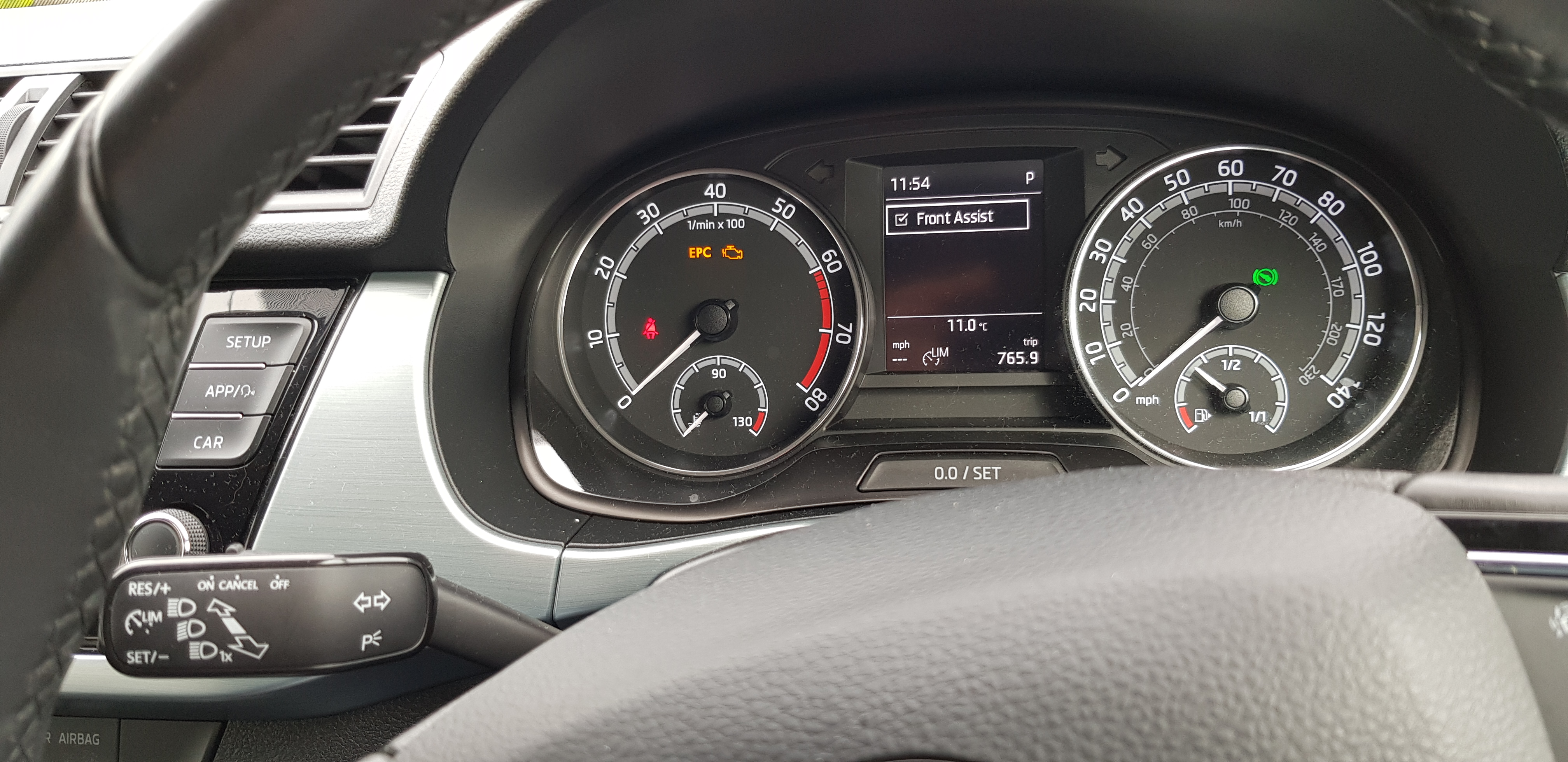

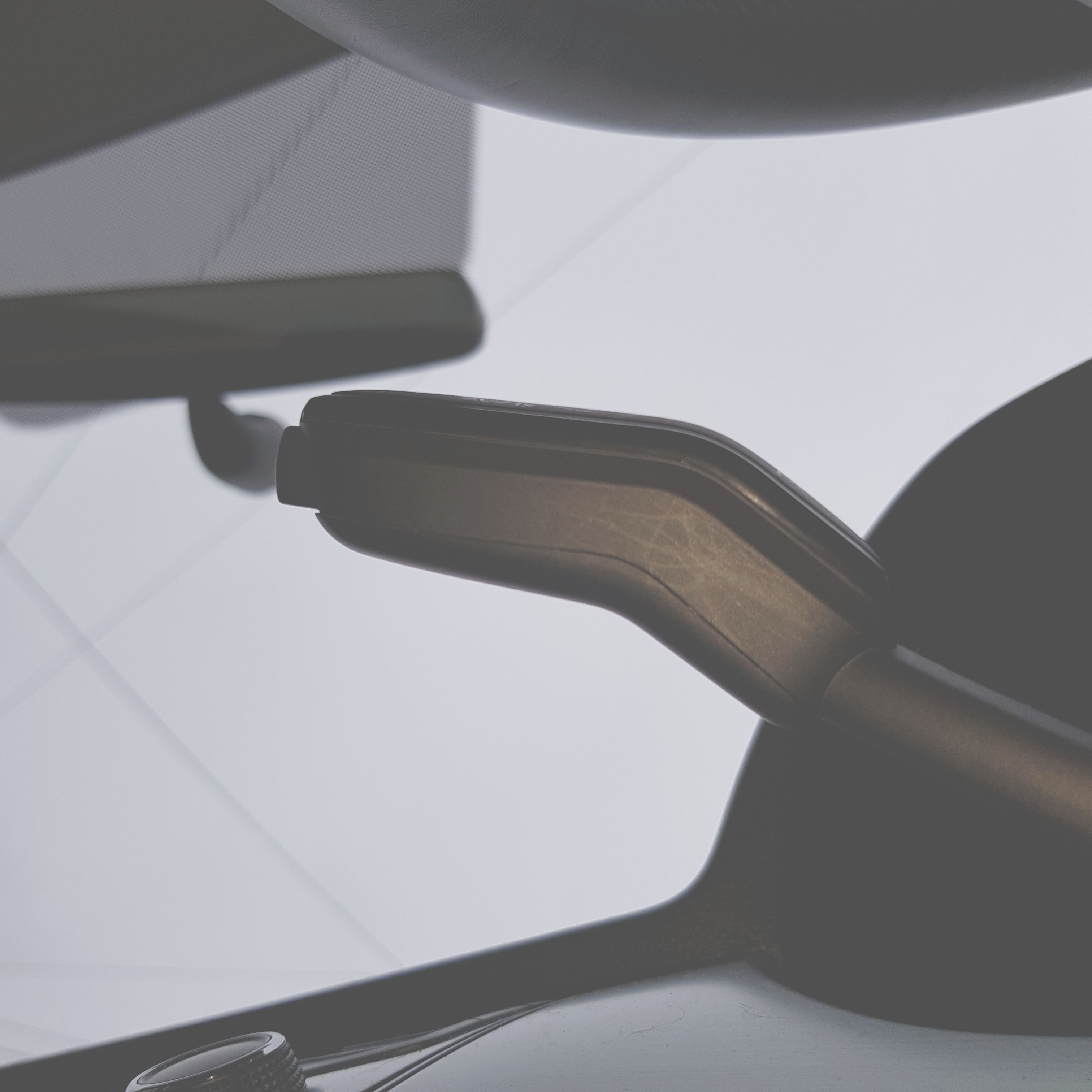

  4. Hello All, I've just become owner on the above car, and have a 400-mile mostly motorway trip on Tuesday. I'd like to use cruise control, and the right stalk indicates this is a feature. However, it's stuck in Speed Limiter mode with no set speed, which causes it to interfere at nearly any speed and clip the throttle. There is *no* button 'D' on the underside of the stalk. I haven't missed it and it's not recessed. The handbook indicates that mode is a selection via the RH steering wheel thumbwheel and buttons. Under the 'Driver Assistance' menue, the only option is 'Front parking aids': which the car does not have, only 3 sensors at the rear. See pictures. Is there something I've missed, or does the cluster have the wrong software version for the car? Thanks in advance Mike
