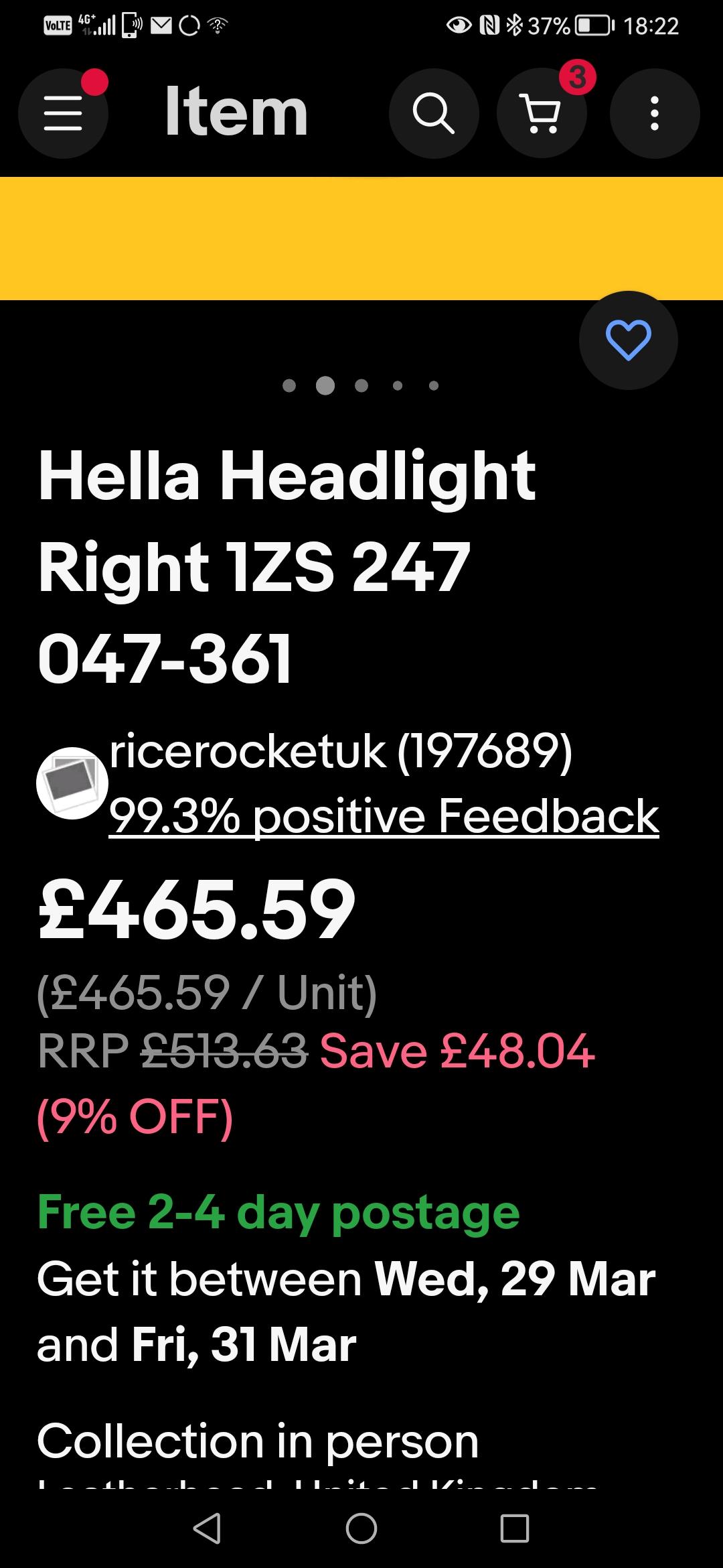

  7. Would this fit my car?

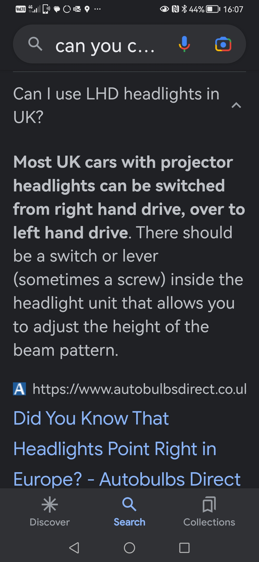

  8. Can LHD not be SWITCHED? I've been told there's a way to switch them over to RHD

  10. Thanks a lot guys, will look into the drying out, whilst looking for replacement, problem is I need car off road for least amount of time possible. But let's see what happens, 👍

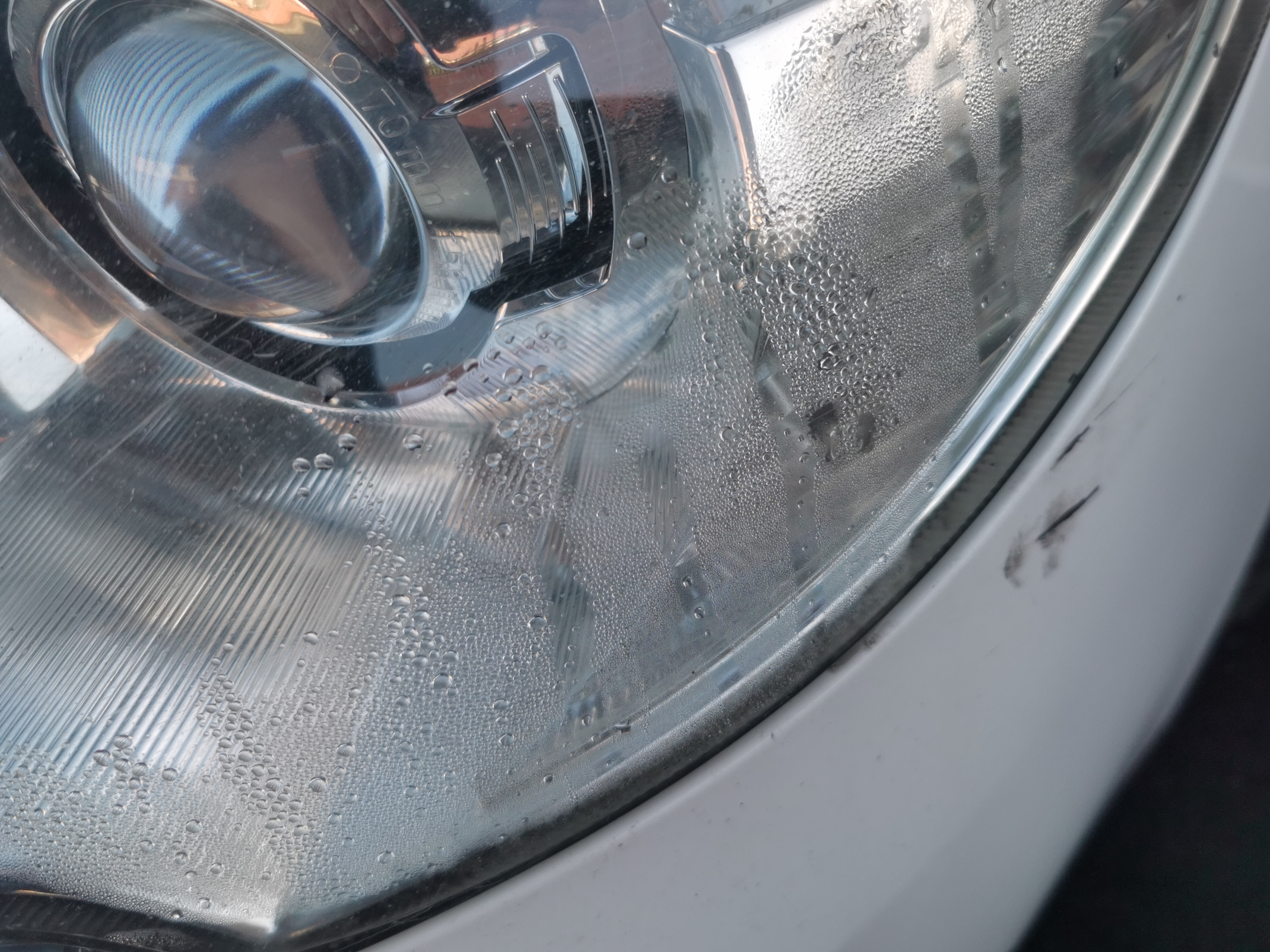

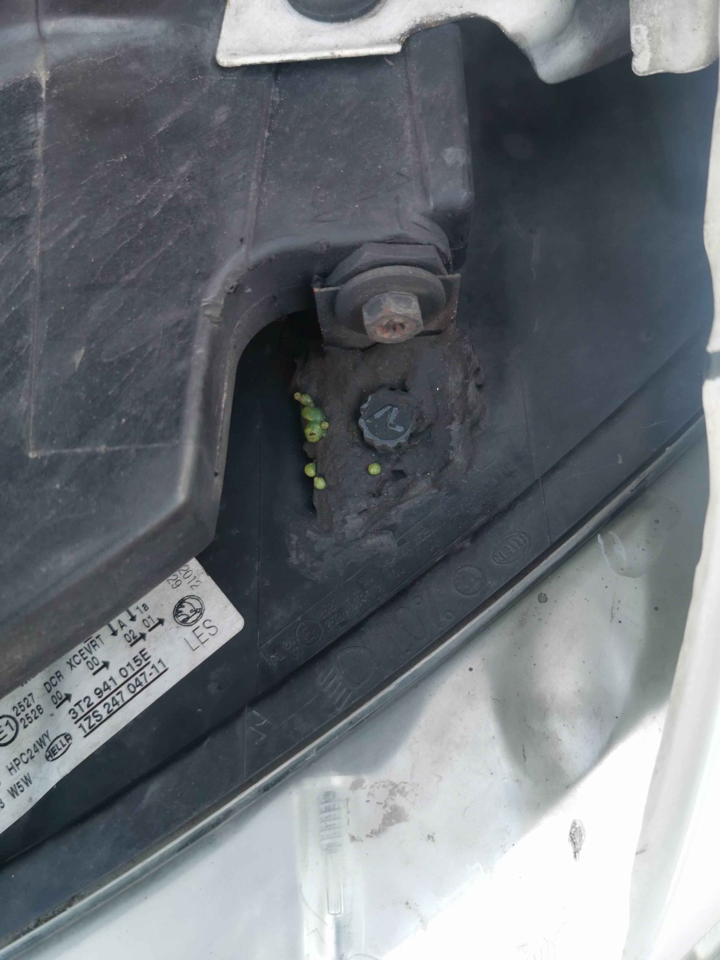

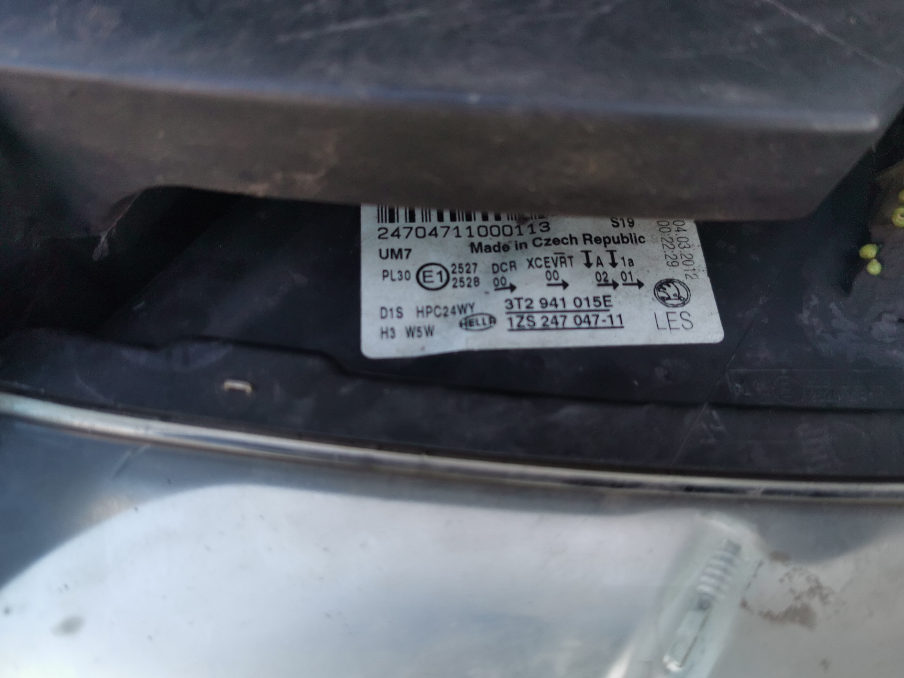

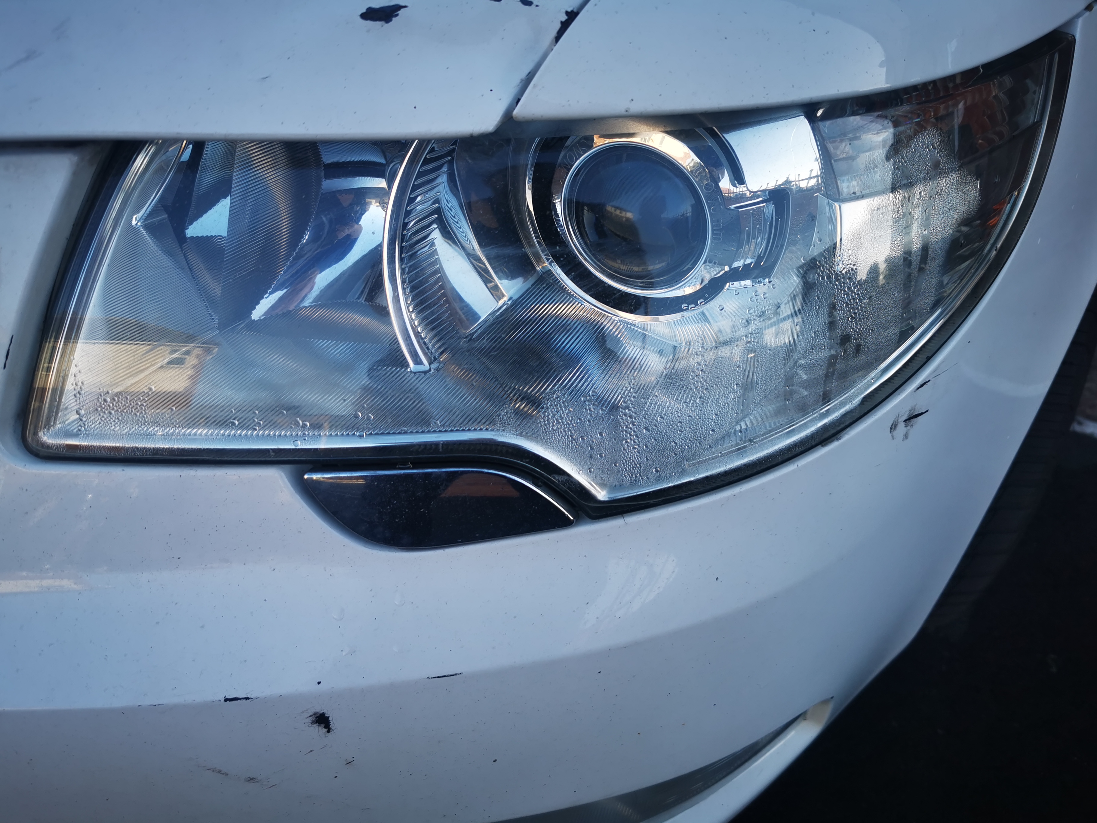

  11. Hi thanks for answering, maybe the B was a typo I've looked at so many. Yes the n/s headlight is the problem. When I purchased the car a week ago, he told me the dipped beam keeps blowing after he had a bump in tha area. The cluster seems to have been glued or summat on top and there is deff condensation on inside, figured new cluster needed. Dealer quoted ÂŖ900 for light ÂŖ250 fitting and calibration. Gave me the part number 3T2941017E. But as Ive just taken pics for you I can see the lamp is 015E 🙄 I'm assuming there are ibvisouly different clusters that will fit.
