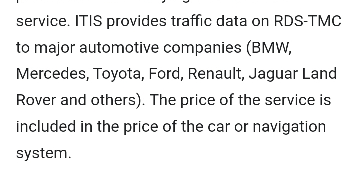

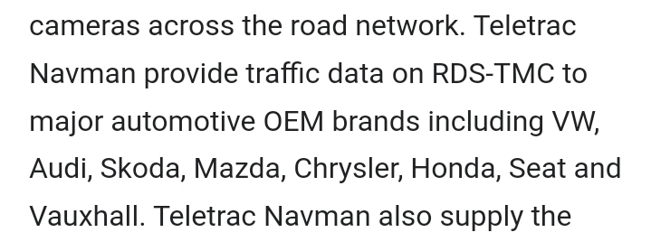

From Wickedpedia....... Trafficmaster (Teletrac Navman) supply the following manufacturers, all of which we now know are having major issues....... INRIX (ITIS) supply the following manufacturers..... owners of their systems are NOT reporting and issues as far as we know........
