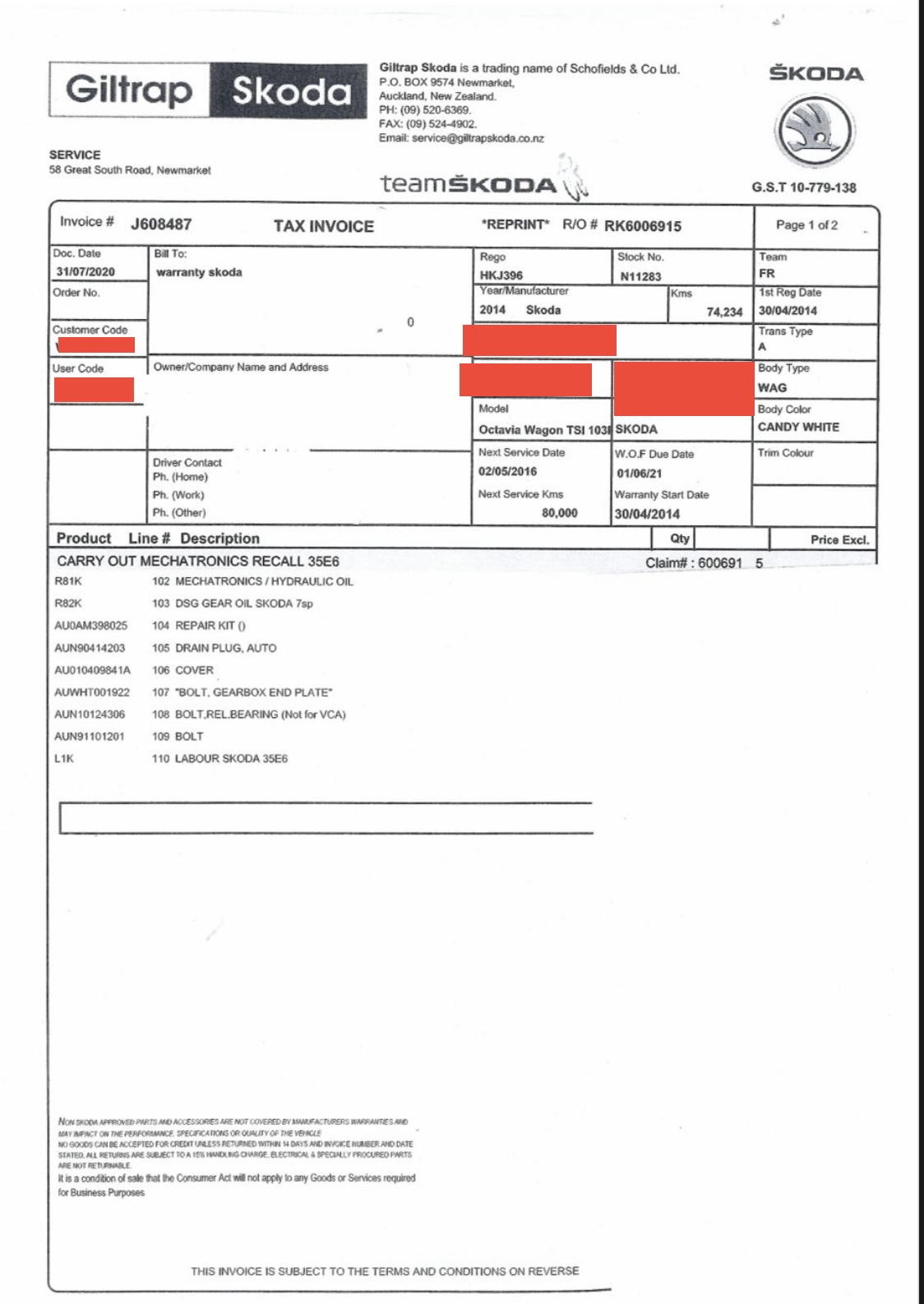

  12. This is exactly how mine feels. Also curious about what’s in the “kit”
  13. *EDIT* The invoice doesn't mention any type of software updates (i.e 34H5) , @toot do you think they would have carried out any updated necessary as best practice when they did this work? (even if it's not been listed)
  14. Called the Skoda dealer that the car was purchased from. They were more than happy to help confirming the work was done and even providing me with the invoice (they did hide the costs though) See what was done, I hope this helps someone else at some point 👍
