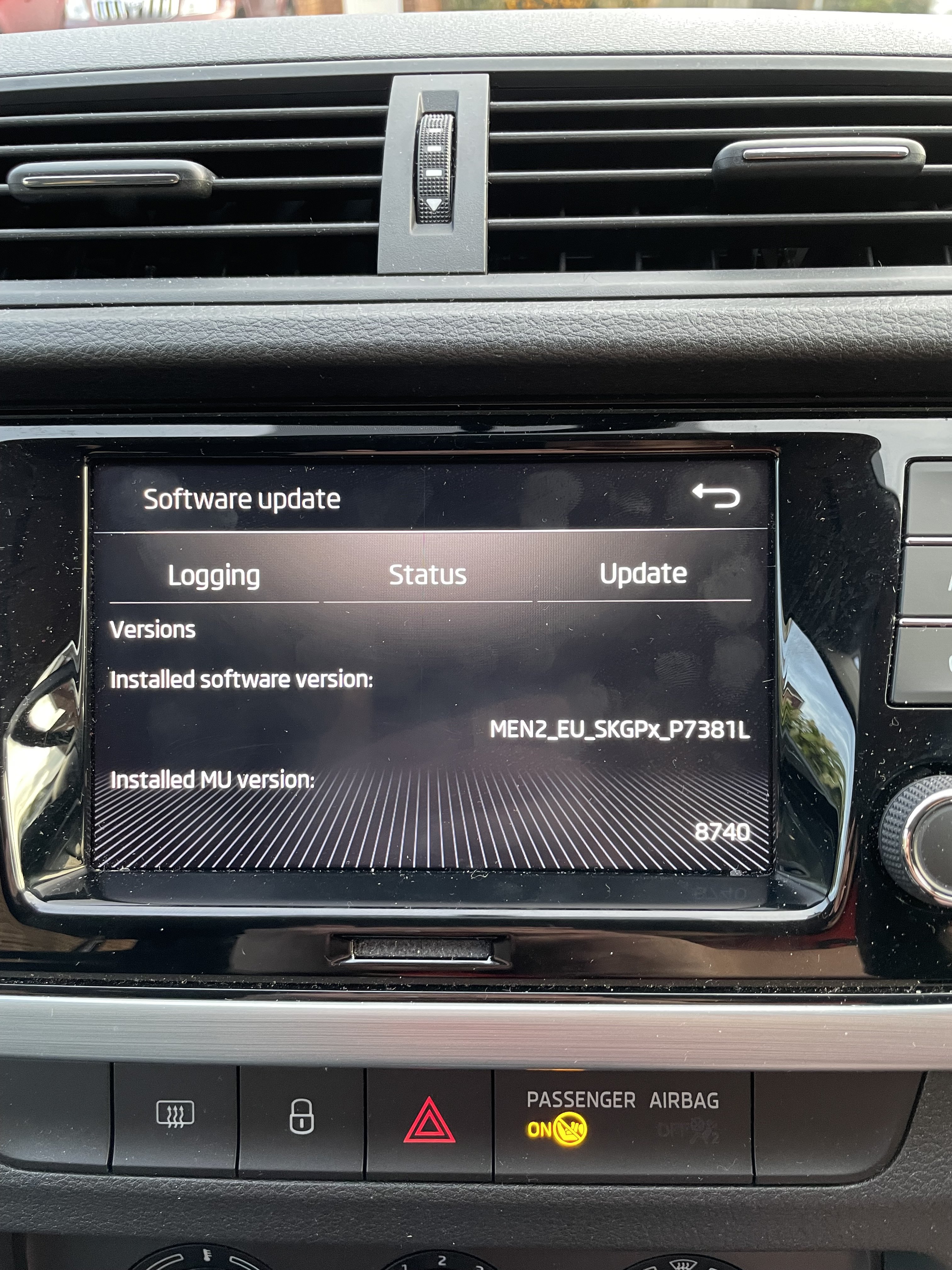

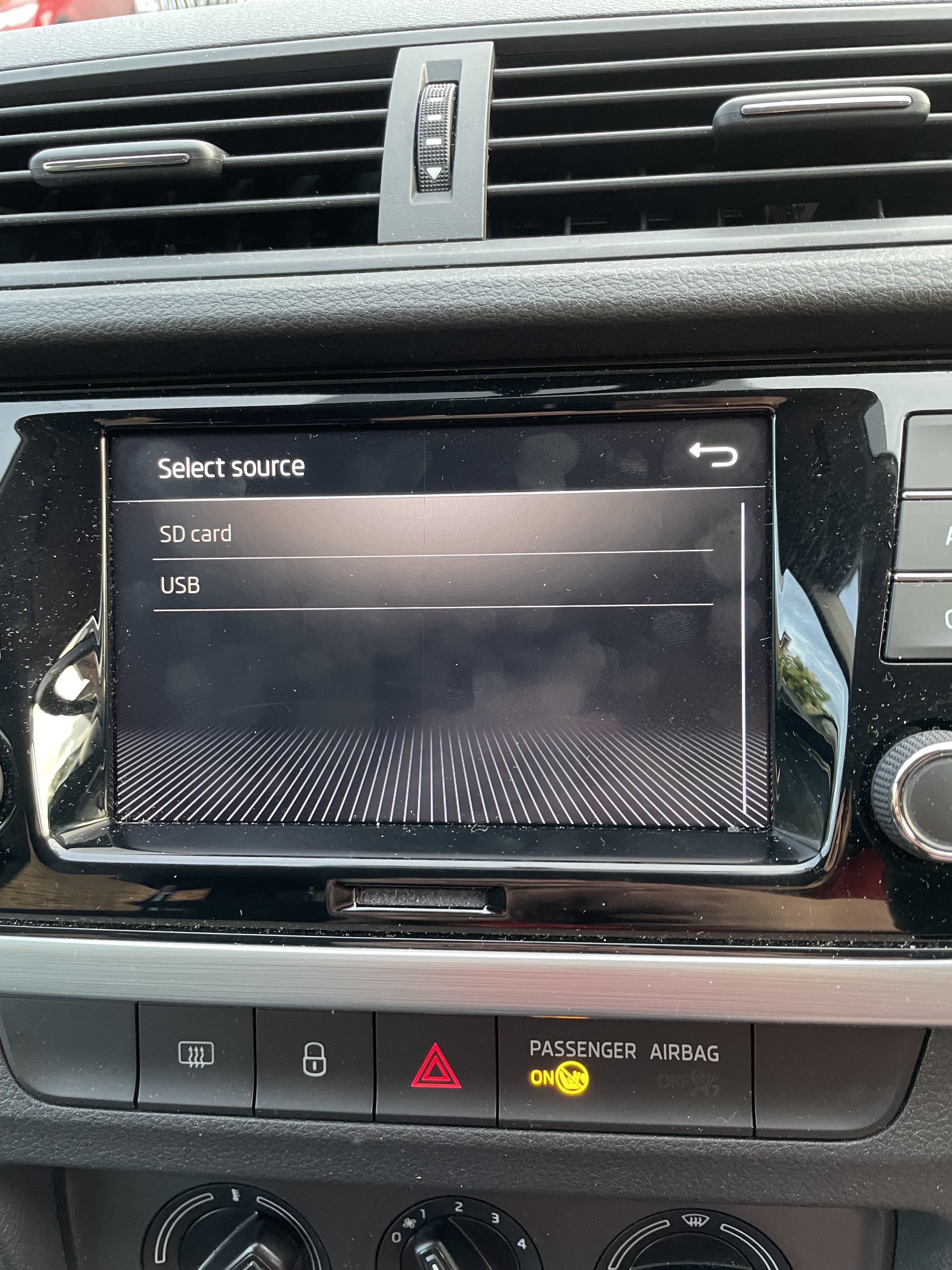

  7. Hello wonderful people. Just picked up a 2019 Fabia 1.0 SE and there is a horrendous crackle when using CarPlay and Spotify. Waze seems unaffected I’m current on version 8740. I understand that 8755 resolves it. Has anyone had this done at a UK stealer and how much did it cost? failing that does anybody have the 8755 file? it’s not online like some manufacturers. Seems it can be updated from the secret service menu by SDcard or USB. I’ve seen some other threads on here but never sure if people still look once it’s resolved! anyway, any help or advice would be greatly received!
  8. Would anybody be able to share a copy of the update please, I’m avoiding using the car now it’s got so annoying!
