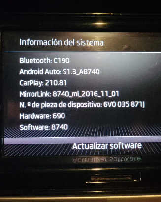

Hi,
I've recently purchased a used Skoda Fabia 2019 Monte Carlo, and when using Apple CarPlay, there is stuttering when playing music through it. After doing some digging online, it seems to be a firmware issue and I need the latest firmware update of 8755 or above to resolve this issue.
I was just wondering if anyone had the update file for this via SD card, or do you have to go to a dealer and pay?
Thanks in advance.

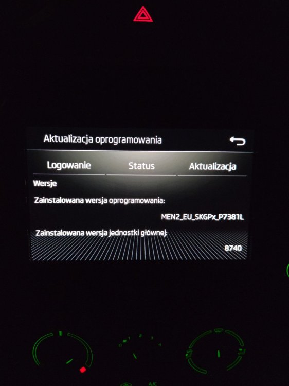

Hi! I'm having the same issue with this specs:
- Pull: MEN2_EU_SKGPx_P7381L
- MU: 8740
My skoda is a twin color, also from 2019! Can you help me?
- MU: 8740
Yes
What kind of information you need?
I have enough from your posted Software Train

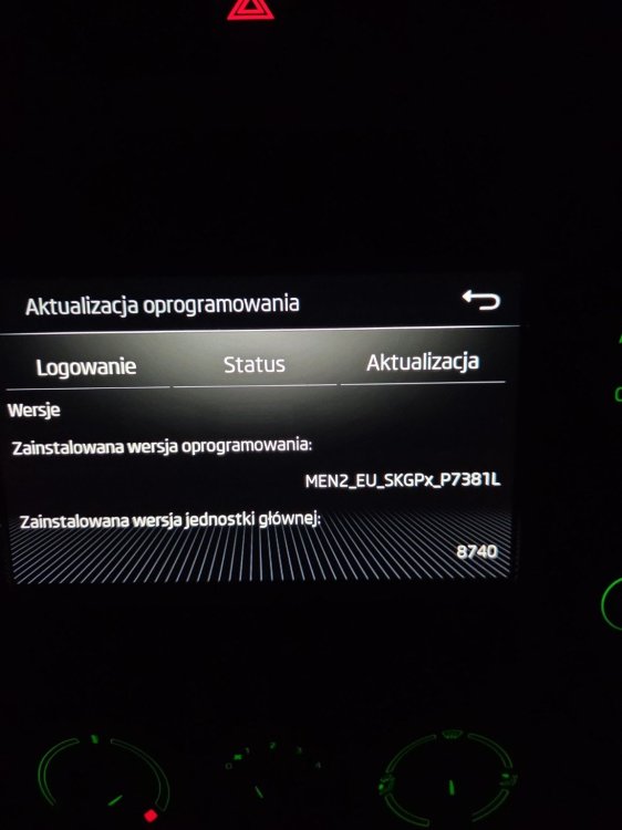

Hi @varooom,
I have SW version 8740 and I have the same issues as the other members above.
Would you be so kind to send me version 8755 as well? :)
Please find details below:
Version: 8740
Many thanks in advance.
Luca

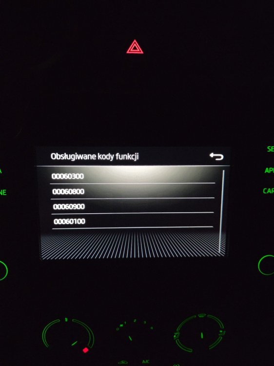

Hello @varooom,
I have SW version 8740, I've bought an android car wifi usb dongle and I can't get it work (it's supposed to work with recent Skoda cars). I thought that maybe updating my swing infotainment to last version 8755 it could work.
Software version is: MEN2_EU_SKGPX_P7381L and I'm using a french version.
Could you please send me version 8755?
If I install 8755 SW, does it change langage interface and does it keep FEC activated codes?
Many thanks,
Léonard

I am not sure updating your software will make things just work I'm afraid.
I can send along the update and you can try of course.
Any factory stored FEC activated codes should remain afterwards.

Hi!
Just a follow up:  it worked! Thanks a lot! I would like to give some heads up: after the first reboot I was asked to do some kind of diagnostic and I thought that I needed to wait, but I figured out that it was waiting for what I think was a usb connection to a diagnostic device, so I pressed cancel and after another reboot I was able to get my Smartlink fixed.
Thanks again!
