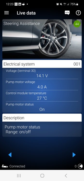

  2. So I have spent the last couple of weekends testing wiring and all was fine getting 12-13 volts at the socket. spoke the guys at Western Power Steering, the low terminal 30 voltage read by the OBD scanner was a sign that the internal pump circuit board had failed. ordered a reconditioned pump and fitted today and can confirm that it was in fact the pump! Would definitely recommend Western Power Steering, with V.A.T & delivery it's came out at £255 and they provide a 3yr warranty. scanned the modules to clear the codes and all good.

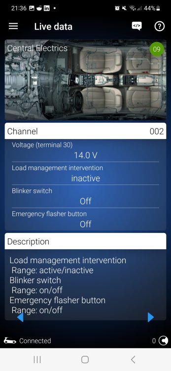

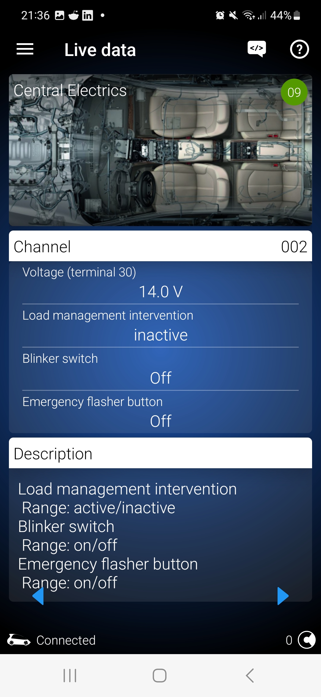

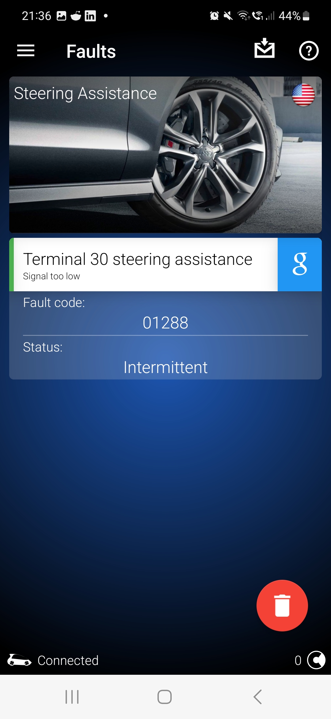

  5. so today I have done a bit more exploration to no avail. I have removed the plugs to the PAS unit and cleaned the connections with some contact cleaner, tested the voltage on the power plug which gave me 12.7v and cleaned the battery and earth terminals to the body. I have also done another drop test on the battery which showed that the battery was fine. I'm also getting between 13.7-14.1v from the alternator with all the auxiliaries running (blower at full speed, headlights on main beam and rear demist on). I'm still getting only 7.1v registering through the live data for control module 44 which suggests to me that something has died in the pump control module. the only thing I haven't checked is the steering angle sensor, but I'm not sure how to check that. I did get an error logged when I unplugged the angle sensor from the PAS pump to clean the contacts which suggests to me that the sensor probably isn't the causing the PAS issues. is there anything else I can check before I order a replacement pump?
  6. I have just bought an OBD Eleven dongle, only the basic model, but reads and clears fault codes and can output live data. you can purchase additional services to allow long coding ect... cost me £49.99 from amazon.
  7. Hi guys, I'm new here, I have a 2010 model fabia HTP2 1.2 Petrol. I have had intermittent PAS issues for the past couple of weeks, with the light coming on on start-up and with no assist and then going out and Steering returning to normal. However, the past couple of days light constantly on and no assist. I have checked and topped up fluid level as it was slightly low, and invested in an OBD Eleven OBD2 dongle which has thrown up 01288 fault code " Terminal 30 signal too low" I replaced the battery about 18months ago and it currently has a 400CCA-45Ah battery. I have had the battery checked today and its at 72% capacity and have since put it on a battery charger. I put the battery on charge for a couple of hrs this afternoon and the light went out after about 30 secs of running but as soon as any load was applied pump cut out and light came on. terminal 30 had 9.2v, but soon dropped to 8.1v I have checked the live data for the 09 central electrics module and terminal 30 is showing to have 14v ( with the engine running). However if I scan the live data through module 44 terminal 30 is only showing 8.1v. My first thought was weak battery, but not so confident now. do you think that my pump has failed? My next step is going to pull the coonectors off the pump and check the power to the pump and clean the contacts with contact cleaner. I would really appreciate some guidance.
