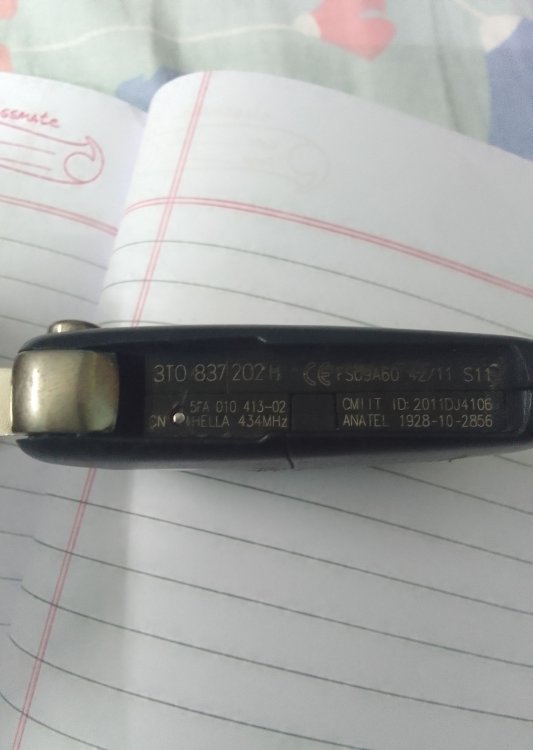

  1. Thanks! But unfortunately Aliexpress is banned here in India. And to be honest Aliexpress is kinda sketchy. Has been unreliable in the past. That's why I'm looking for alternatives. Mine have these little pins in the slot where the folds away into. I looked it up on YouTube and they push this pin into the key and pop the two pieces. And that pin is impossible to move. I tried sim ejector, a round pin sort of screwdriver, etc. Everything I tried either kept slipping or gave out. It's a post 2010 thing I suppose. Video link. Yes its the one with the trunk button. Images only show the exterior and not the inside. The part numbers are different for a reason right? Not about the price but I don't want anymore plastic junk than I already have lol. Edit: Adding a few images.
  2. My OEM keys which are 11 years old are starting to fall apart. The buttons have broken off on one and are sticky on the other and the cases themselves have seen better days. I was looking for a good replacement case but couldn't find the correct part number. The original has this part number: 3T0 837 202H with the CN code. All the ones I can find here are with the part number: 5K0 837 202AD. Can I interchange the cases like that? I am in India and the only place I could find the original was on a sketchy website. Any help would be greatly appreciated.
