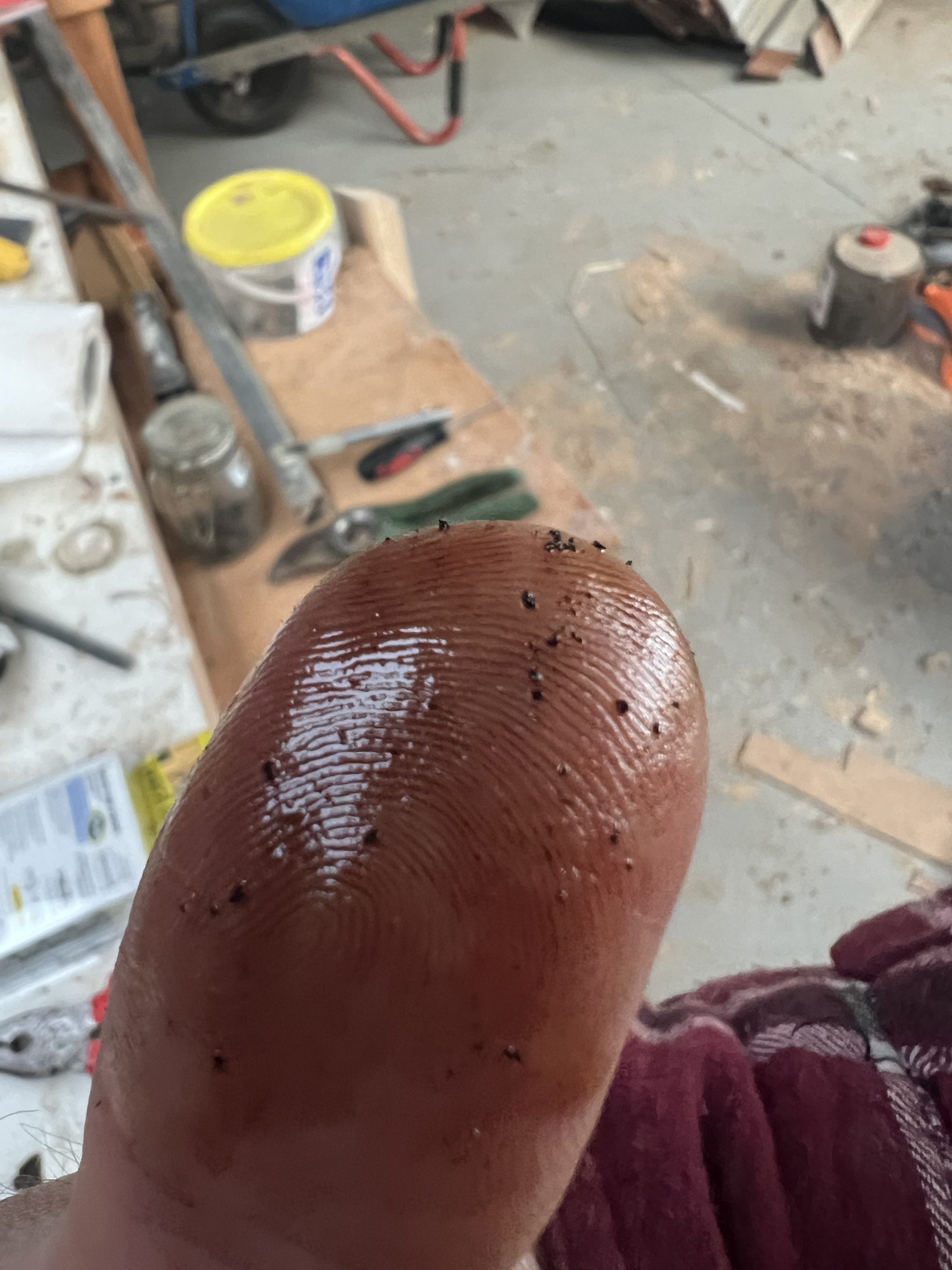

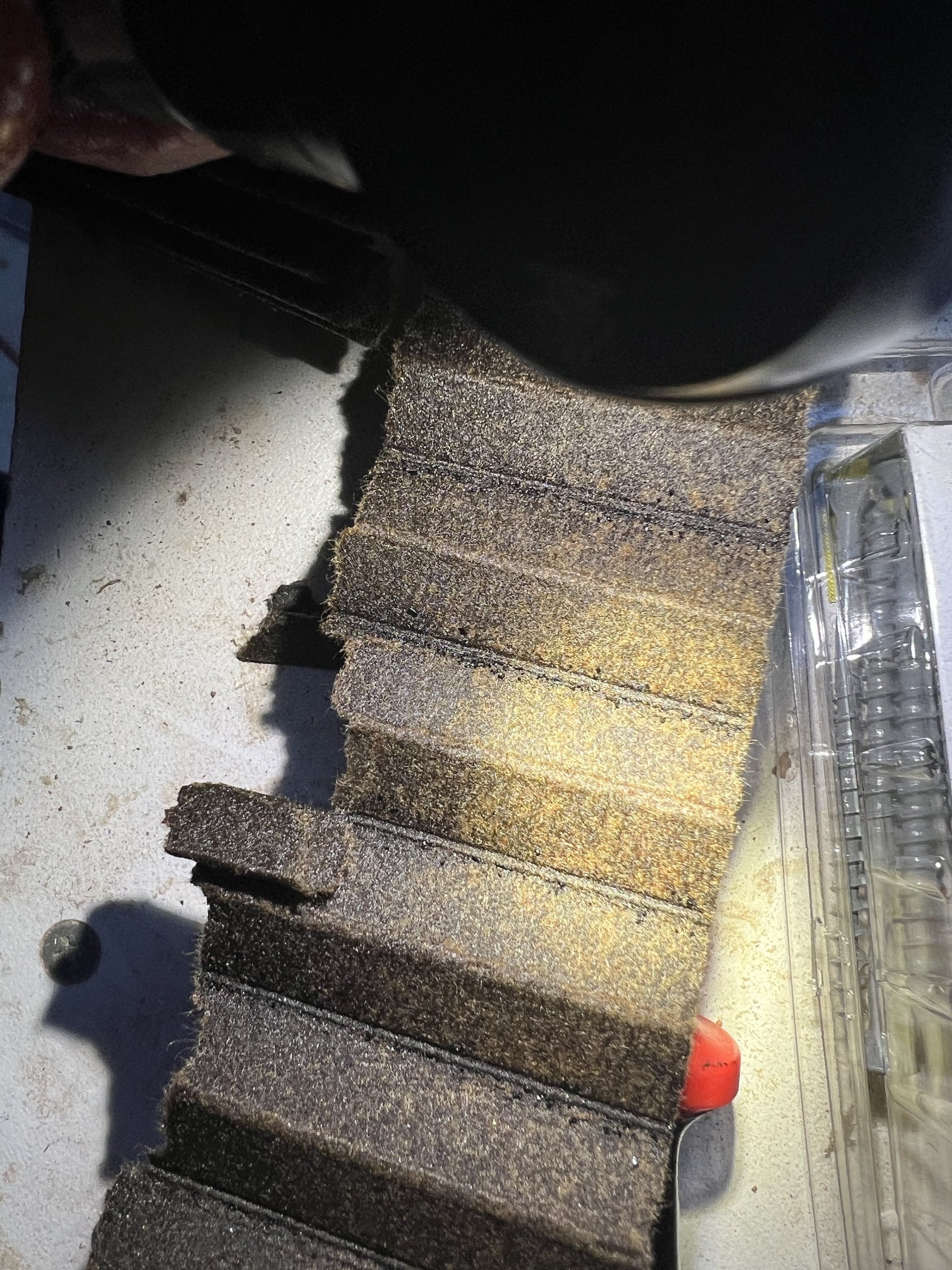

  10. We also removed bumper and pulled out oil filter. Oil filter looked pretty normal and couldn’t see any metal bits, however ripped paper apart and it was pretty gritty. Is this typical for these motors?

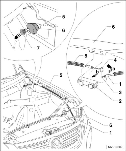

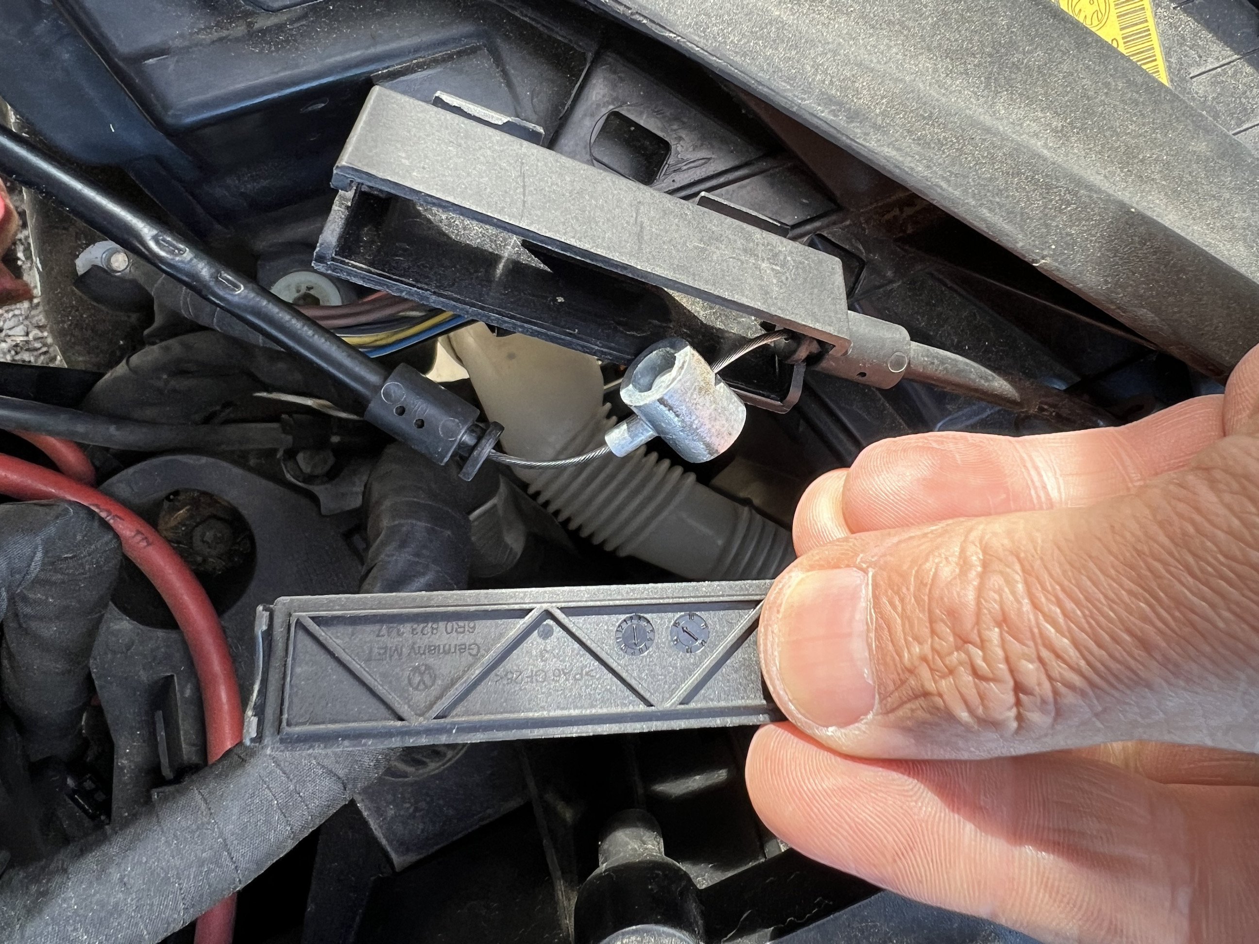

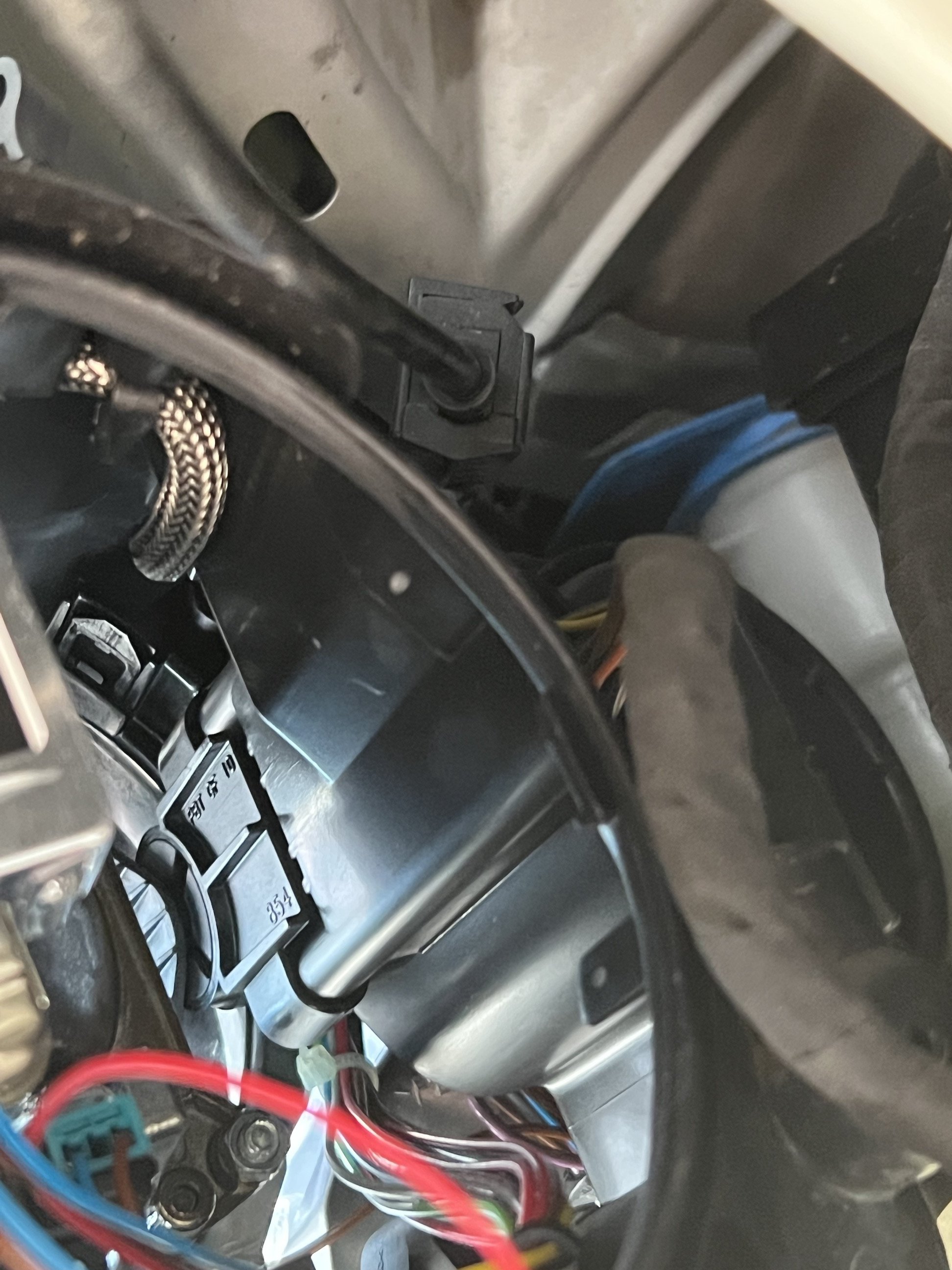

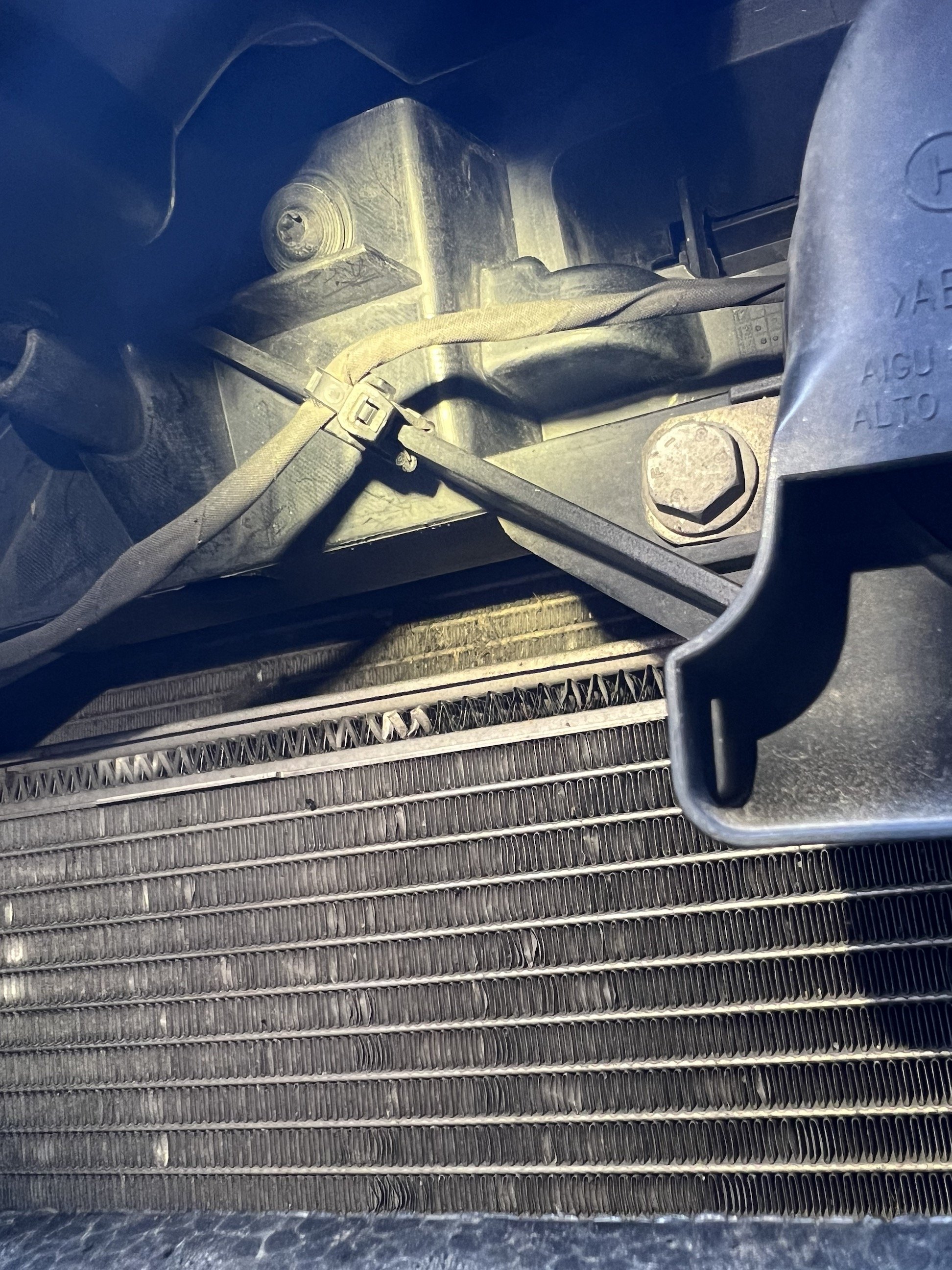

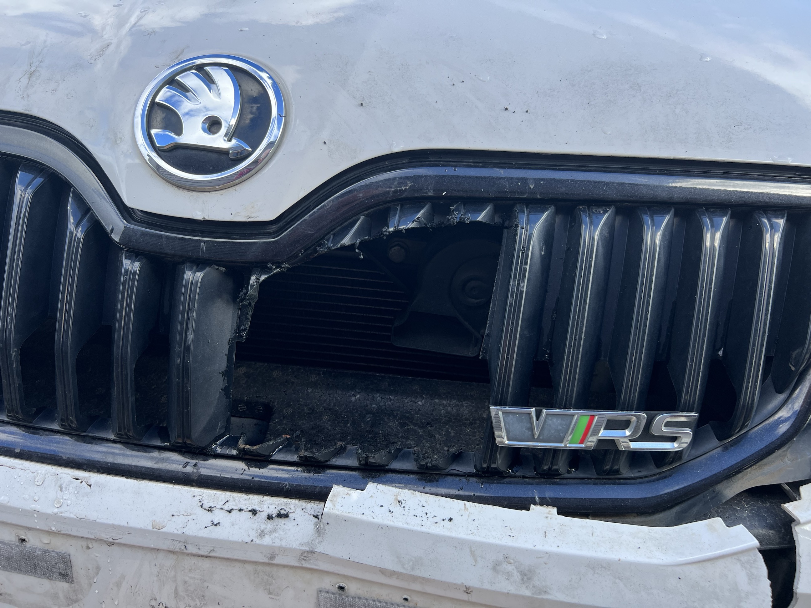

  11. Quick recap… Skoda Octavia Mk3 2016 /17 Recovered stolen vehicle, no keys, all doors locked, flat battery, all electric windows. Googled Skoda Octavia Mk3 bonnet release cable broken and none were the same.. —- What did we learn today… Don’t cut into grille, can’t do anything here… (see pics), there is nothing you can do from front. What works? Removed lhs front wheel and internal lining. There is a bonnet cable here, inside up above headlight that can be reached, however the join of two cables is different to everything I could find on the net. Had a look at wife’s 2015 Tiguan.. Lo and behold it has same bonnet release.. Pull case apart easily, with small screwdriver (small lid comes off), and grab join of cables and pull.. bingo bonnet open. No need to pull join apart. Sorry pictures not in order but should make sense, and hopefully help next person.
  12. The bumper is already damaged, the grille is ok but have found that it is bonded to bumper and will come with replacement. Just being cautious.
  13. A lot of good responses here, thanks you all. Will have a go at trying to get in door with tool pictured below.. However apparently 3 different types but only 1 in Australia so will give it a gentle shot so as not to stuff lock up. Am resigned to cutting into bumper/ grill on weekend. I did see that the Amarok appears to have same bonnet catch and there is video of opening that on line. Whatever result, I will post learnings so that answer’s available to help anyone else who ends up in same spot. If I can get bonnet open will be able to check oil filter for any metal fragments. If filter is clear, it’s probably worth a shot to order genuine Skoda keys and then start replacing panels which will keep us busy until keys arrive. As always, open to good ideas and wisdom. Thanks.
