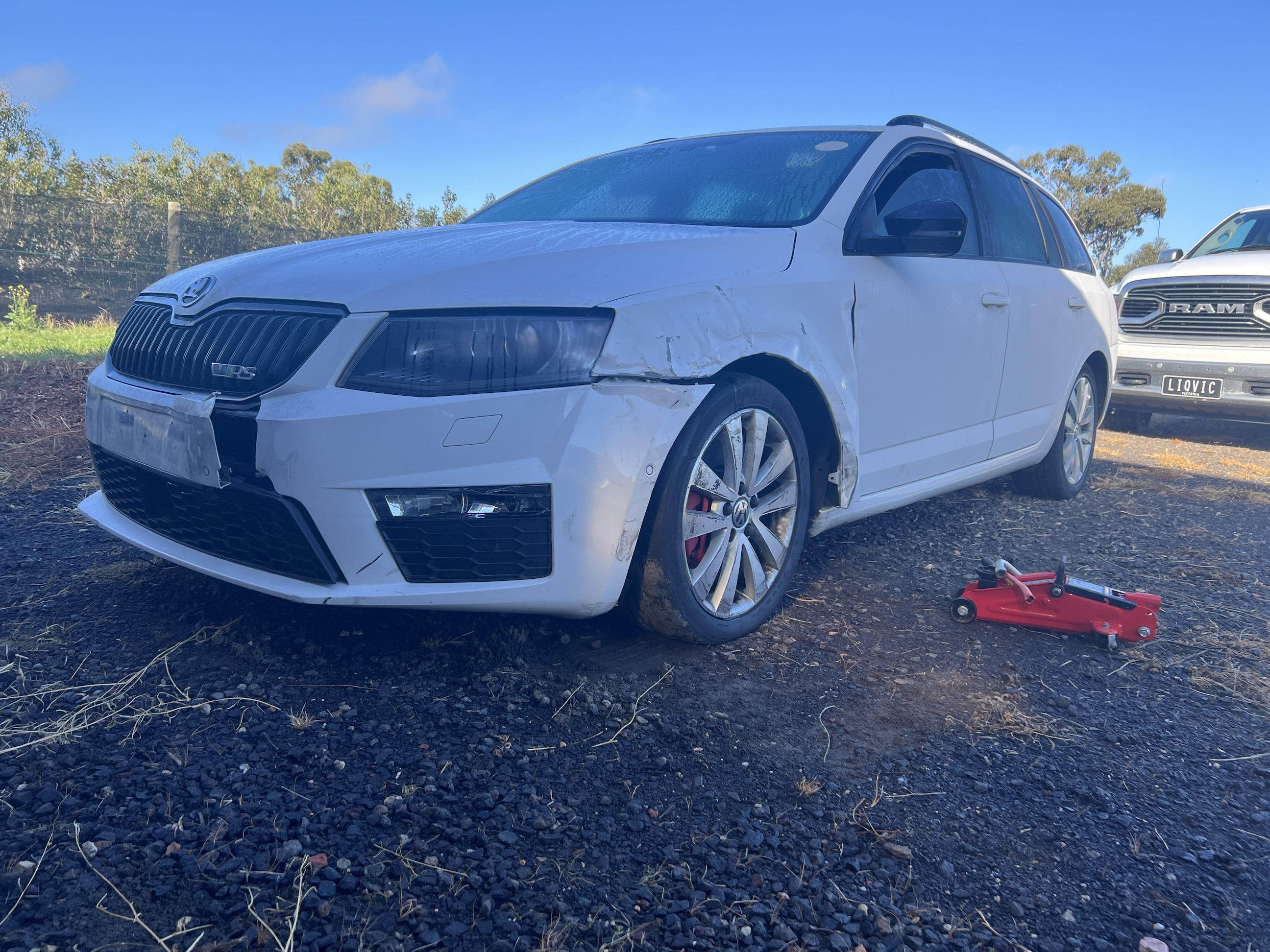

Well it’s a nice day in Australia so got into it. Put new sump, baffle and oil filter on. Topped up coolant. Pressed the button and started first shot!. Wow. That was a surprise.. no rattles or noises.. Goes forwards and backwards.. no noises.. But no brakes… pedal to the floor. Worn set of pads in the back so I am guessing they did some home handy work and didn’t bleed the brakes properly or perhaps computer gremlin? Passenger side window went up but doesn’t want to come down.. all the rest are good. Now try and sus out brakes.. reservoir is full. So a bit of digging.

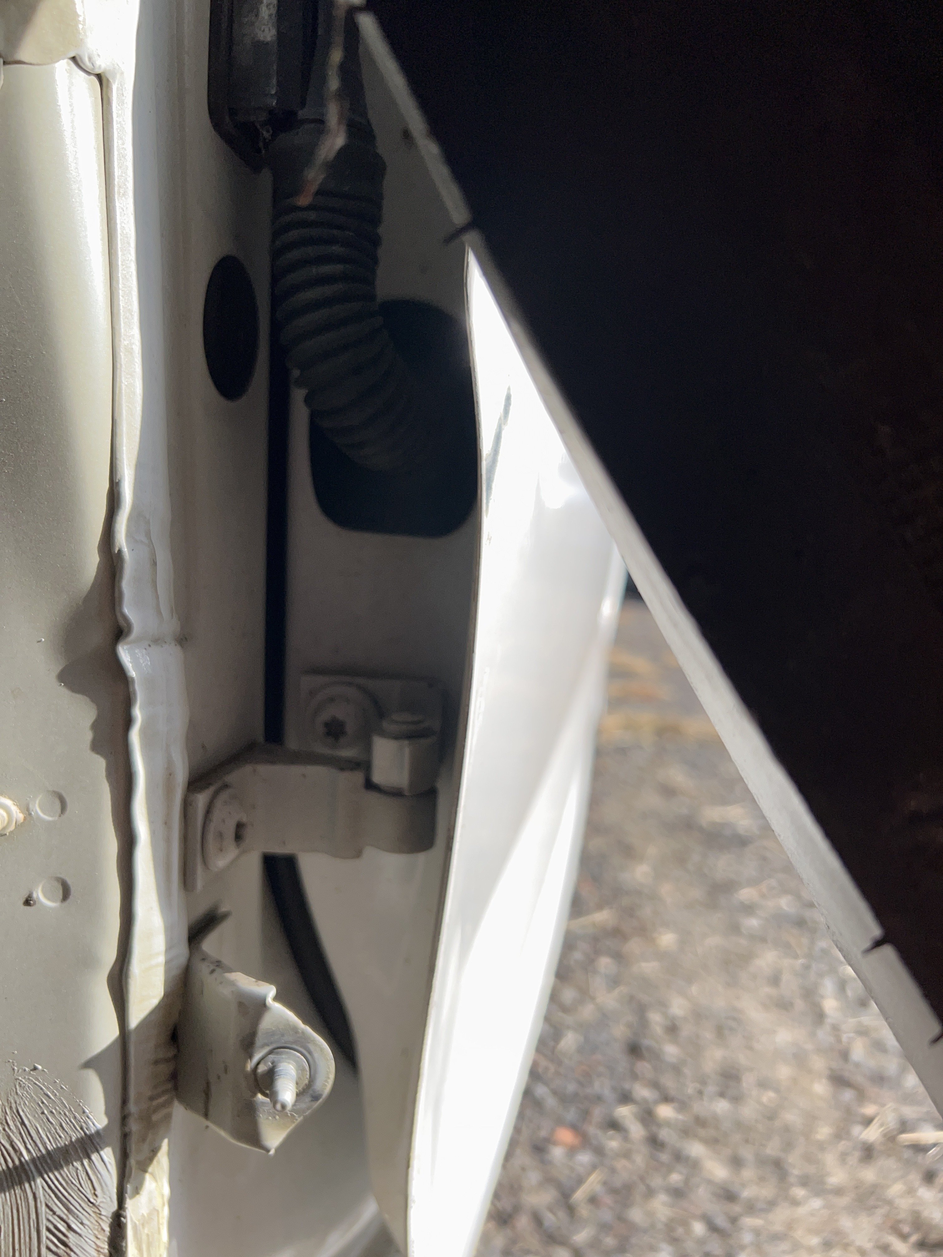

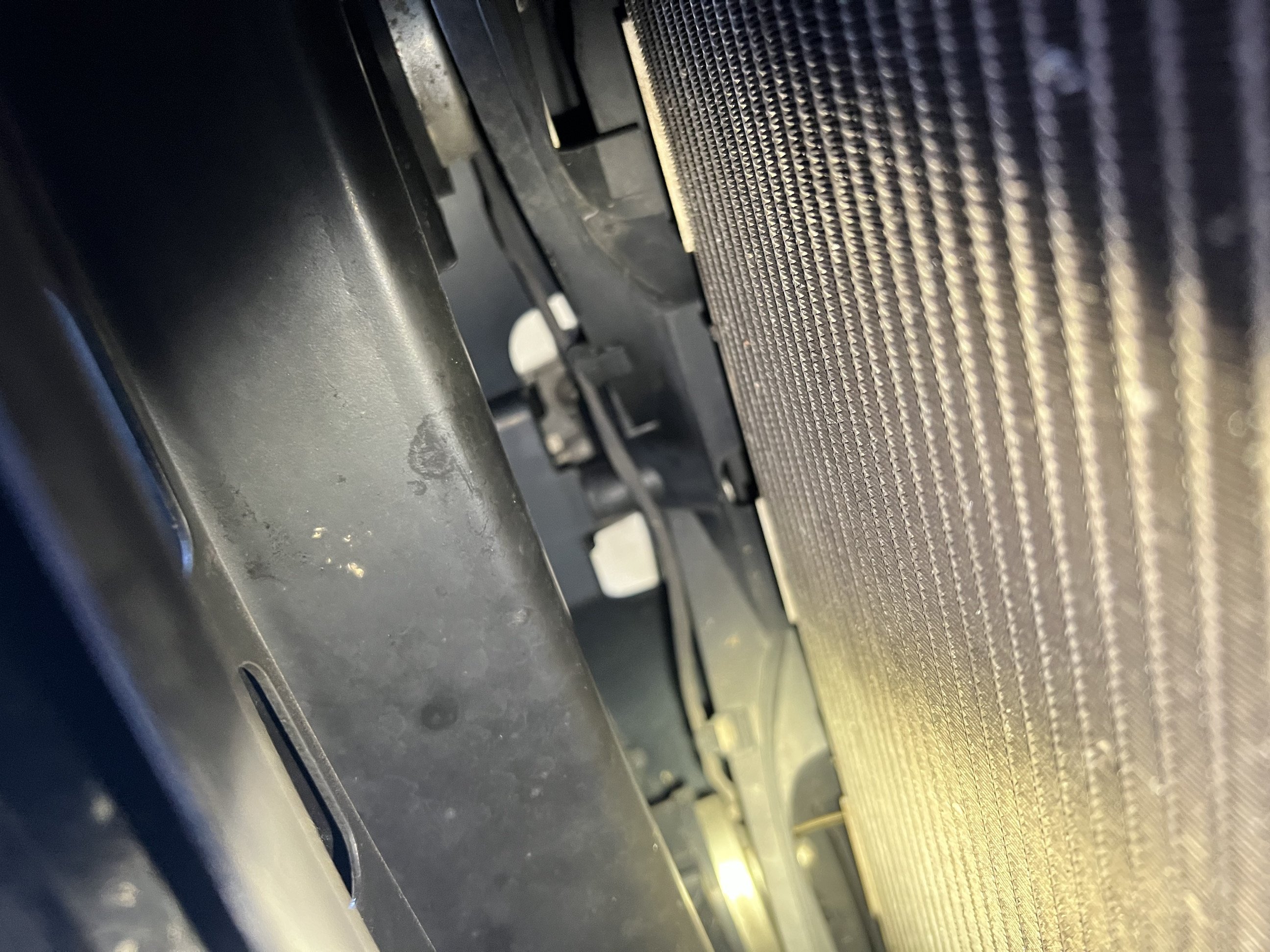

Quick recap… Skoda Octavia Mk3 2016 /17 Recovered stolen vehicle, no keys, all doors locked, flat battery, all electric windows. Googled Skoda Octavia Mk3 bonnet release cable broken and none were the same.. —- What did we learn today… Don’t cut into grille, can’t do anything here… (see pics), there is nothing you can do from front. What works? Removed lhs front wheel and internal lining. There is a bonnet cable here, inside up above headlight that can be reached, however the join of two cables is different to everything I could find on the net. Had a look at wife’s 2015 Tiguan.. Lo and behold it has same bonnet release.. Pull case apart easily, with small screwdriver (small lid comes off), and grab join of cables and pull.. bingo bonnet open. No need to pull join apart. Sorry pictures not in order but should make sense, and hopefully help next person.

The bumper is already damaged, the grille is ok but have found that it is bonded to bumper and will come with replacement. Just being cautious.

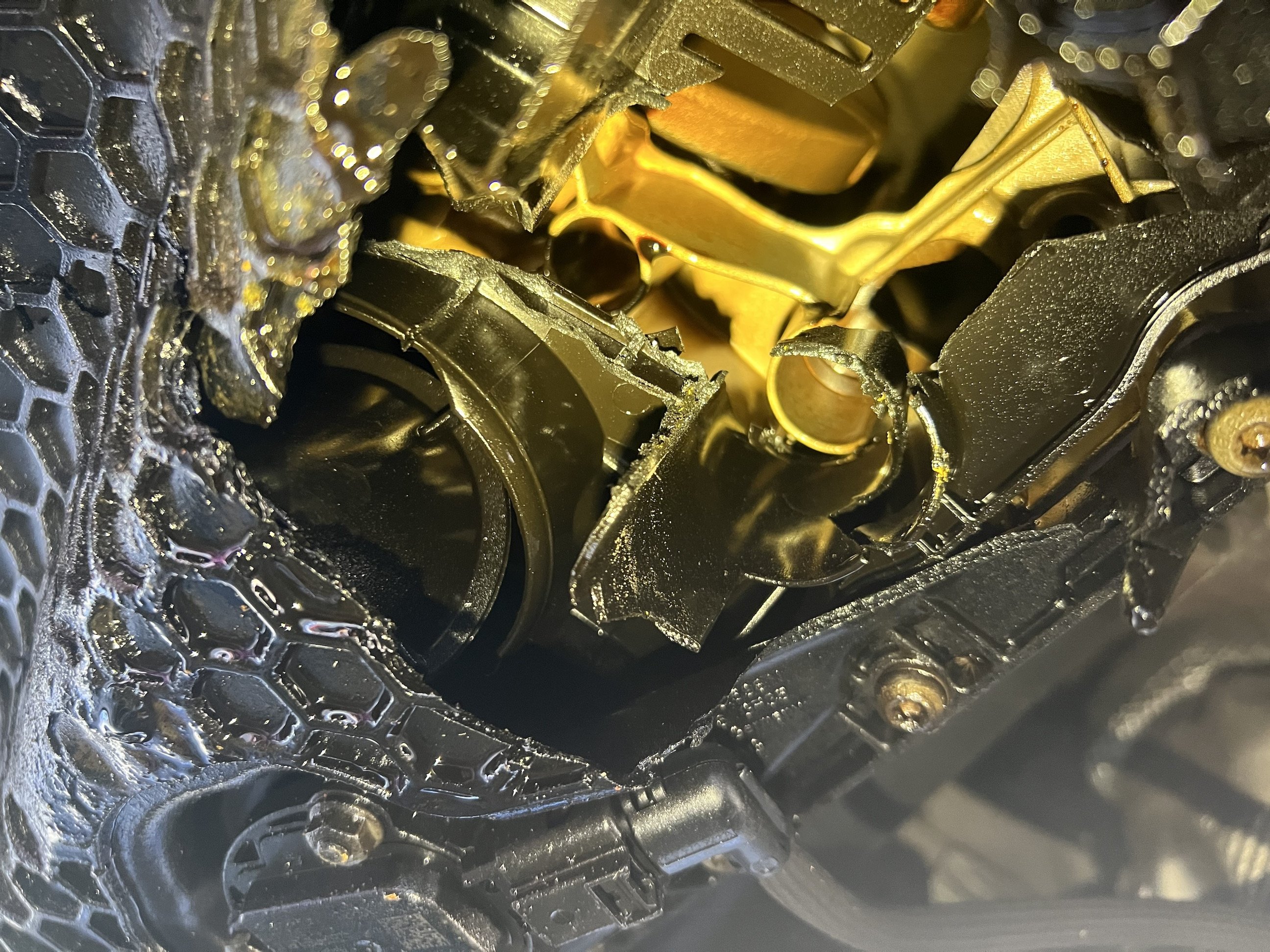

All good.. in for a penny in for a pound… Hoping to get power and bonnet open, hoping (against hope) that power would allow us to wind window down or unlock door. Not sure that keys are not inside but with flat battery can’t tell and windows to dark to see detail.. At least when we get open I will have some new tools.. it looks like thief was auto elec as has left card inside car with tools and kids toys ( Facebook page shows card and child on kids toy in the back) but who knows… Will drop sump tomorrow and check bearing on piston rod and see what they are like. The oil in sump that I can reach seems clean. If ok, probably pick up cheap sump and baffle then order OEM keys and wait for them. It seems there is mixed feedback regards third parties providing and program keys when missing original.. although some say they can but want to charge $1,500 AUD.. I think too much to take a punt on..

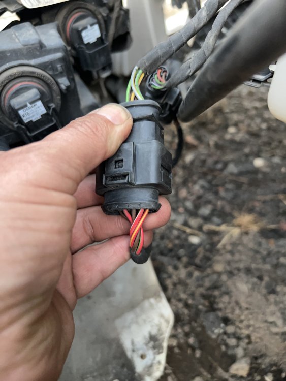

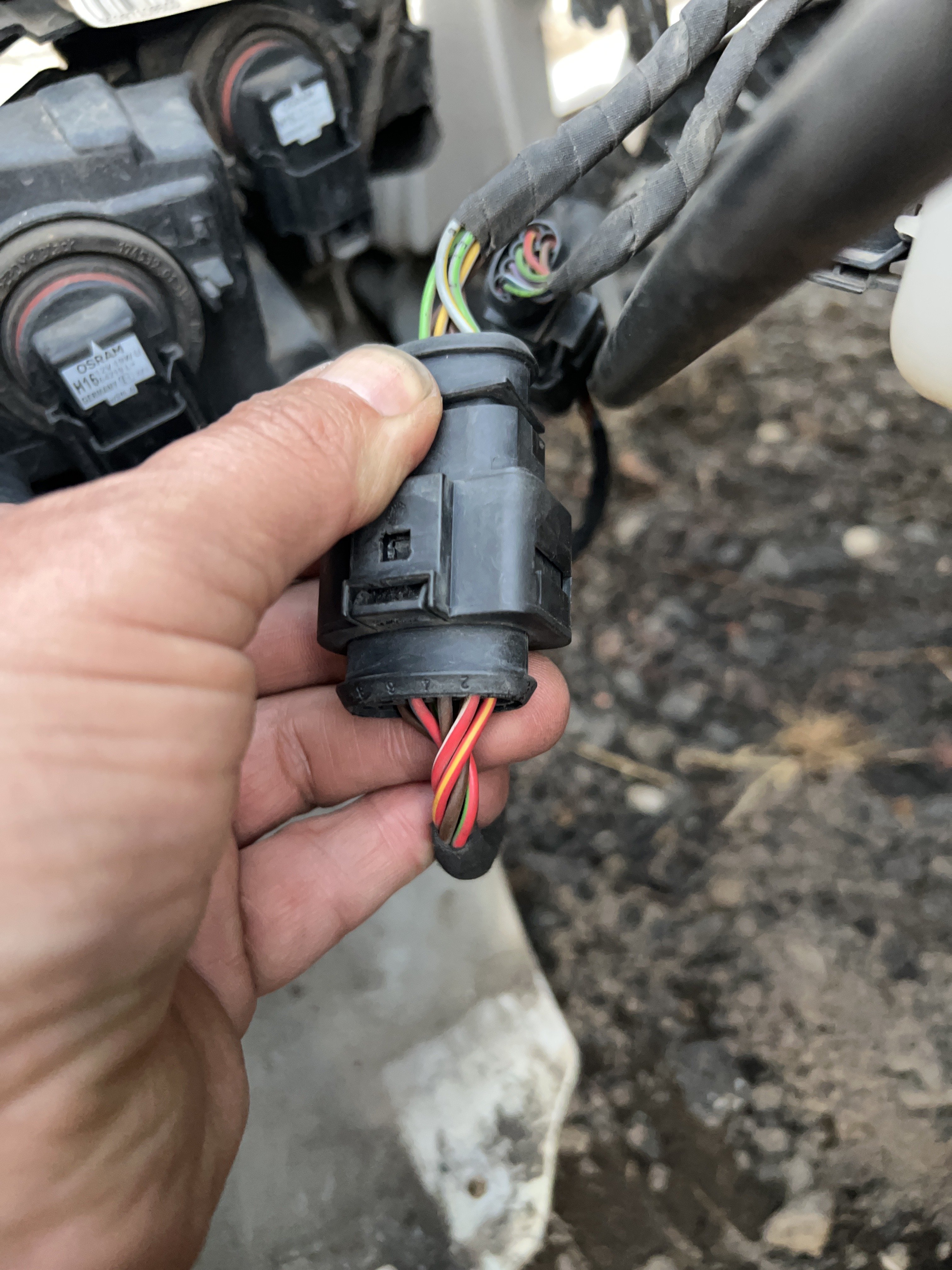

Ok, this plug goes to indicator and washers on the bumper. Would it be realistic to put 8amps through this? Else I think might order keys.. 😢

No worries, checked charger and it’s only 8amp, so that bit is good. Wonder if there is an easy plug to get to as this one requires stripping cover. Time to start looking. The Golf has 10mm bolts holding bonnet catch but these have Torq bolts so can’t access them.. looked at unbolting bonnet lock but that is torq with no room also.. grr…

Unfortunately/ fortunately son told police he left spare key in car. No insurance now. We are in Australia so parts are a bit difficult to access, along with good help.. Now trying to open bonnet from grill side.. this seems impossible? Have got lower grill out. Jacked up today and they have put hole in sump, so want to get bonnet open and check motor to make sure we are not putting good money after bad..
