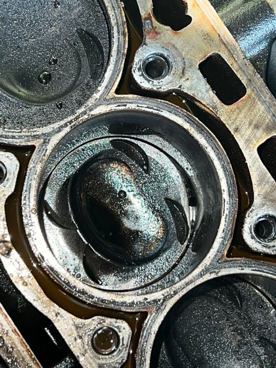

  1. Not that bad tbf just a little rough where the pistons cracked, nothing a hone wont take out
  2. Update: took a few days off and had to order or borrow a few special tools, but ive found the culprit.

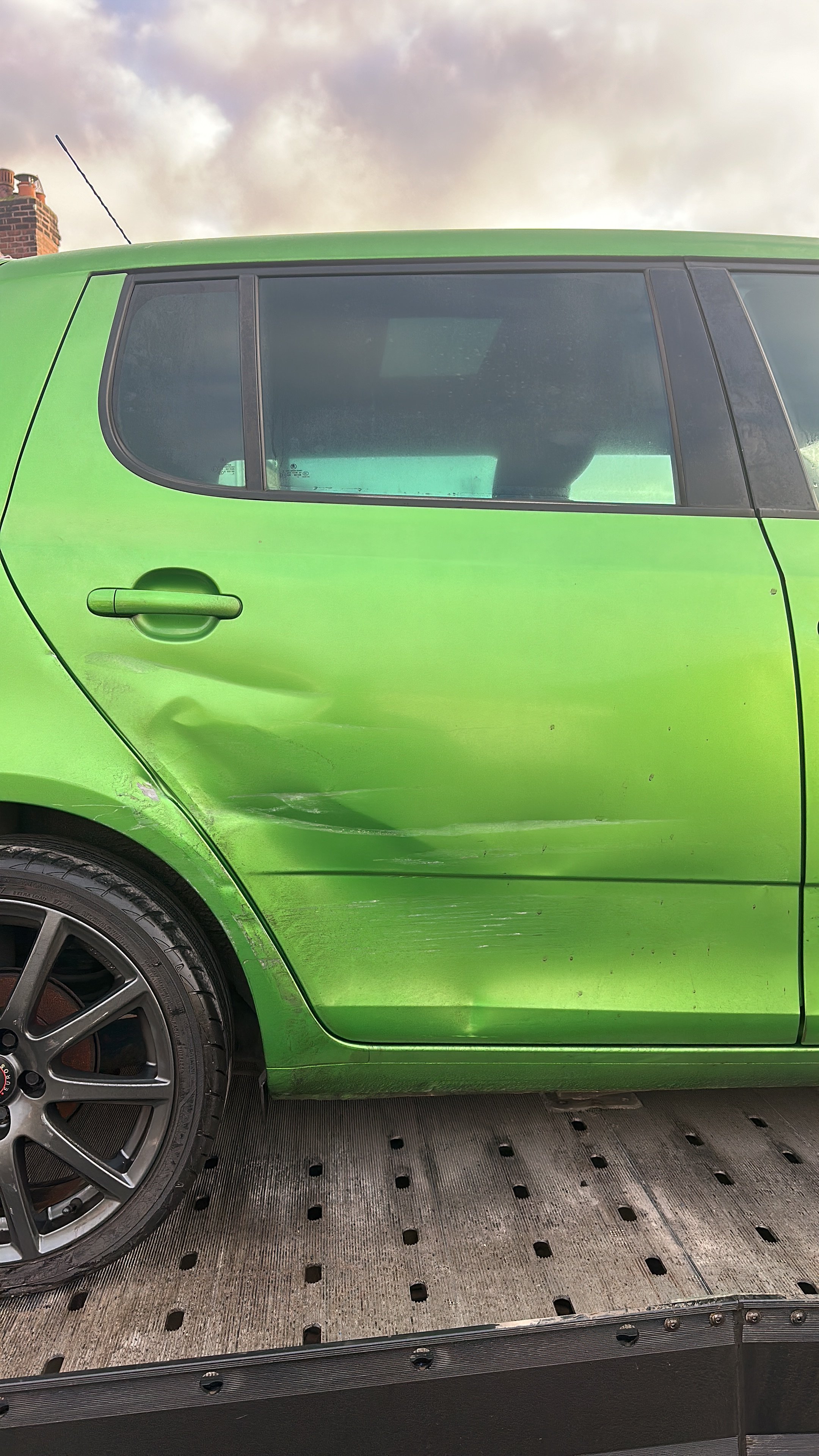

  4. Ah right shouldnt cause an issue right? here check the picture from copart, its a cat N for the damage here.i bought a scrap door for £42 and fitted it in 10 mins, if the engine wasnt a stinker I would have been golden 😂

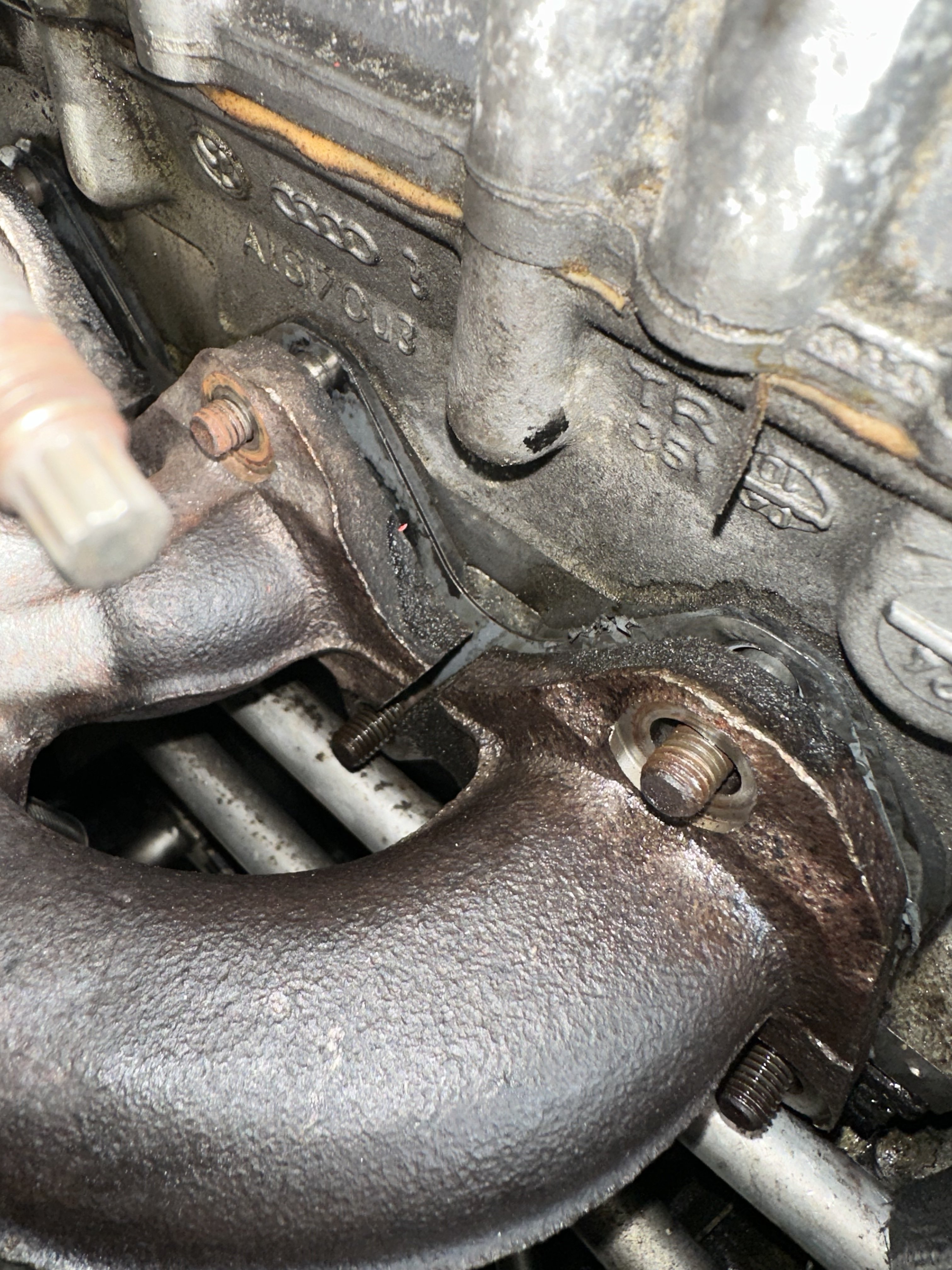

  5. So sort out pistons and should be okay in my book😂 going to give everything a proper clean when re assembling, just took off exhaust manifold and found these cuts in there is this normal?

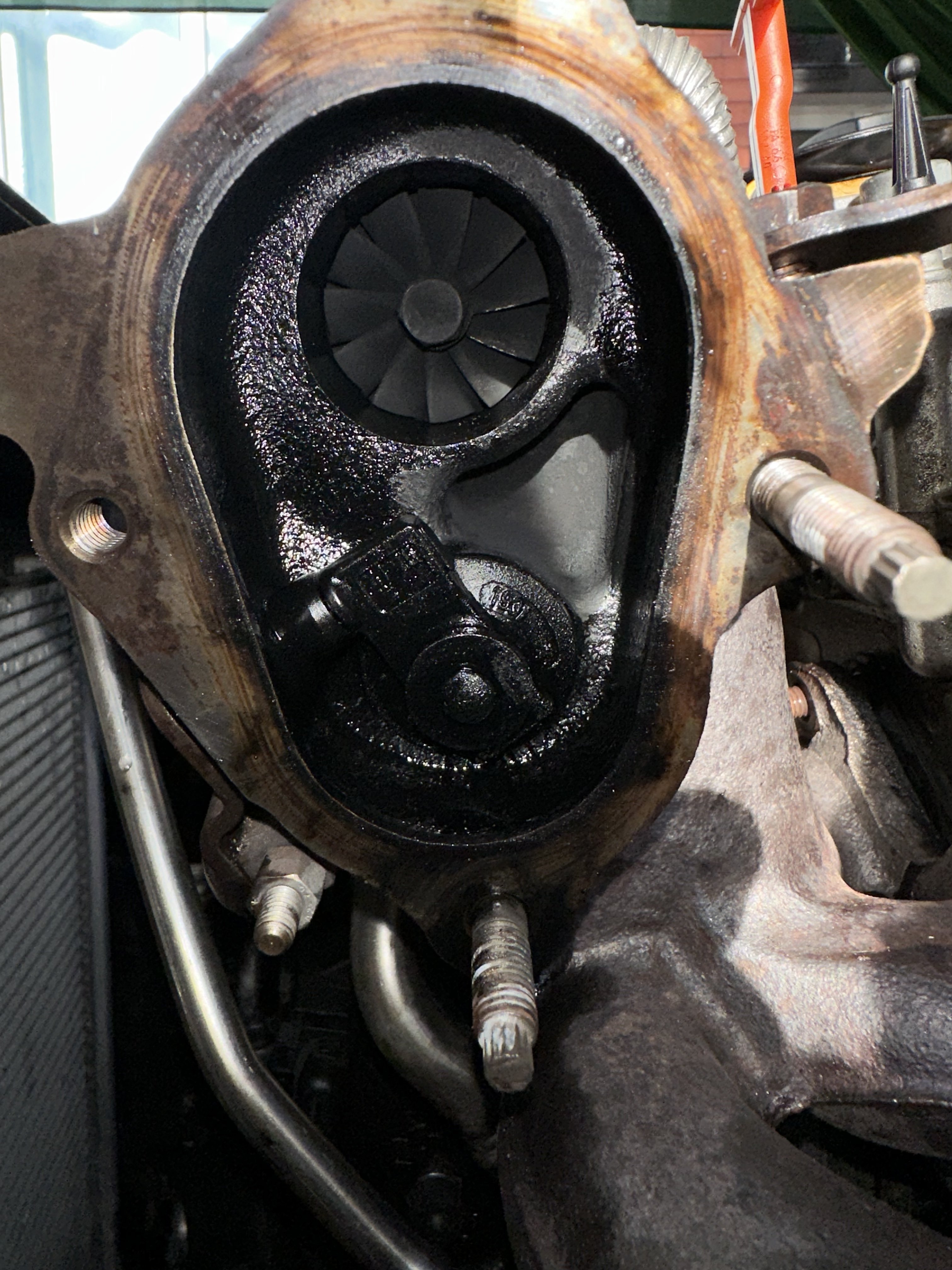

  6. Oil was low actually! Turbo exhaust side is rammed with oil, intake side clean
  7. Intake is covered in oil aswell and the intake is was full of oil. It also had a forged BOV that was spitting oil out everywhere

  9. So story is, i bought the car on copart as runs and drives no egm, when it arrives I test drive it briefly and it has absolutely no problems at all for maybe 1 mile. As I was busy at the time just parked it on my drive and planned on fixing the cosemetic stuff at a later date. Brother borrowed the car for a 40 mile round trip and thats where it went wrong so don’t have much detail about exactly what happened. took it to skoda for a “full diag” they said its misfiring cyl 2/3 burning oil in the exhaust and has low compression on cylinder 2. Wanted £400 just to take the head off for further diagnosis so took the car back from them. engine builders had a chat on the phone theyre princess engineering here in Manchester was recommended them by a few people. The guy said its most likely a cracked piston and hes repaired quite a few in the past, will probably cost upwards of 2k hasnt been boroscoped but since im taking the head off not much point now, ive just got most of the surrounding items off airbox boost pipes pcv system etc. drained oil coolant and oil filters planning on getting the head off today to get a conclusive answer…. just wondering what to do about the oil in the boost pipes and pcv, read on lucifers guide it usually comes from the turbo but the turbo was dry so 🤷‍♂️
