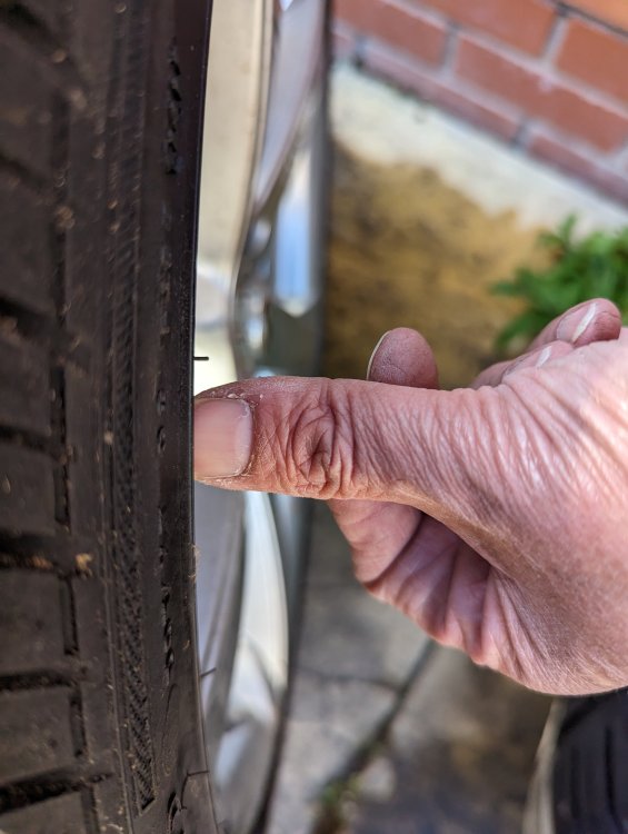

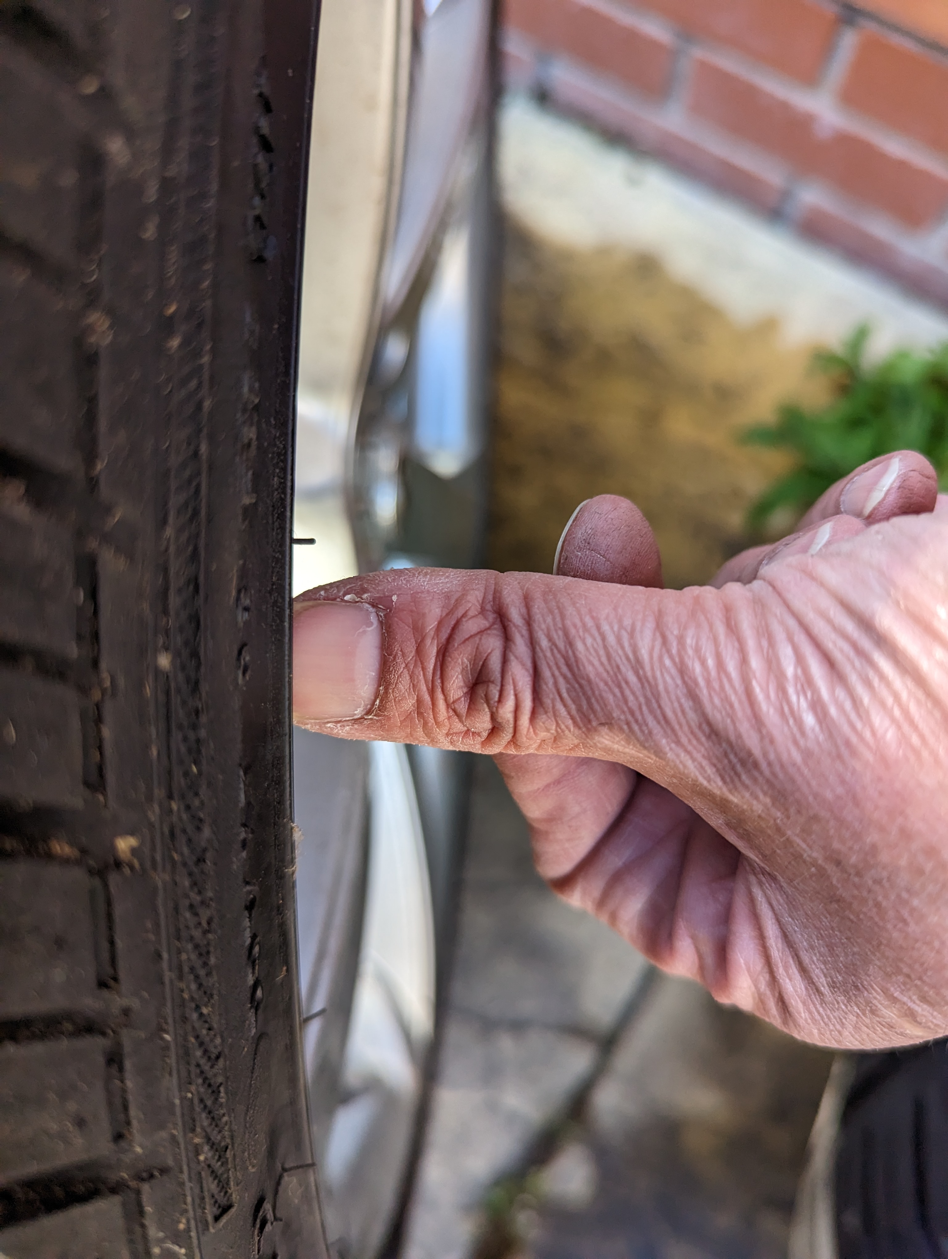

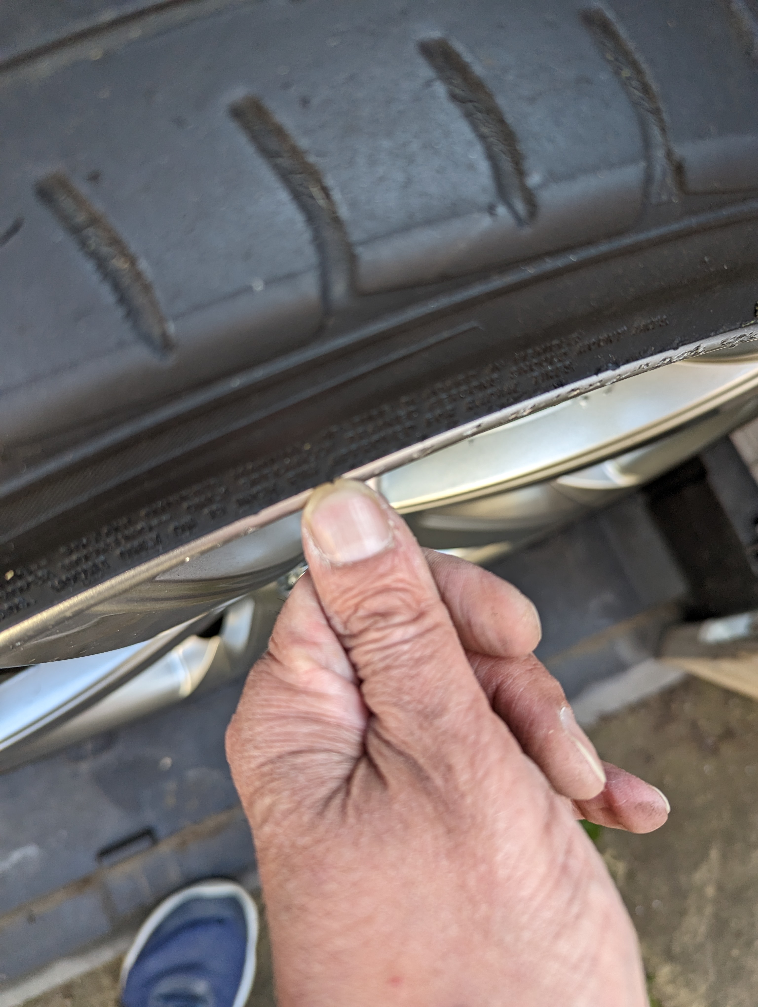

🙏 thx guys Im not a professional, but I know by looking at the pics I have I'd like to go 255 rear n 245 front, if you look at the pics you see the added tyre at the edge of the rim. I know I'm a noob I'm asking will they fit under the rear arches 255, n will 245 fit under the arches at the front, from pictures it simply looks to me that the added rubber compared to my thumb nail will add some protection, I suppose after seeing everyone's comments il have to try them and see what happens, thank you guys you have all been so helpful and knowledgeable, I appreciate your advices thank you.- Tyre widths on Skoda superb
