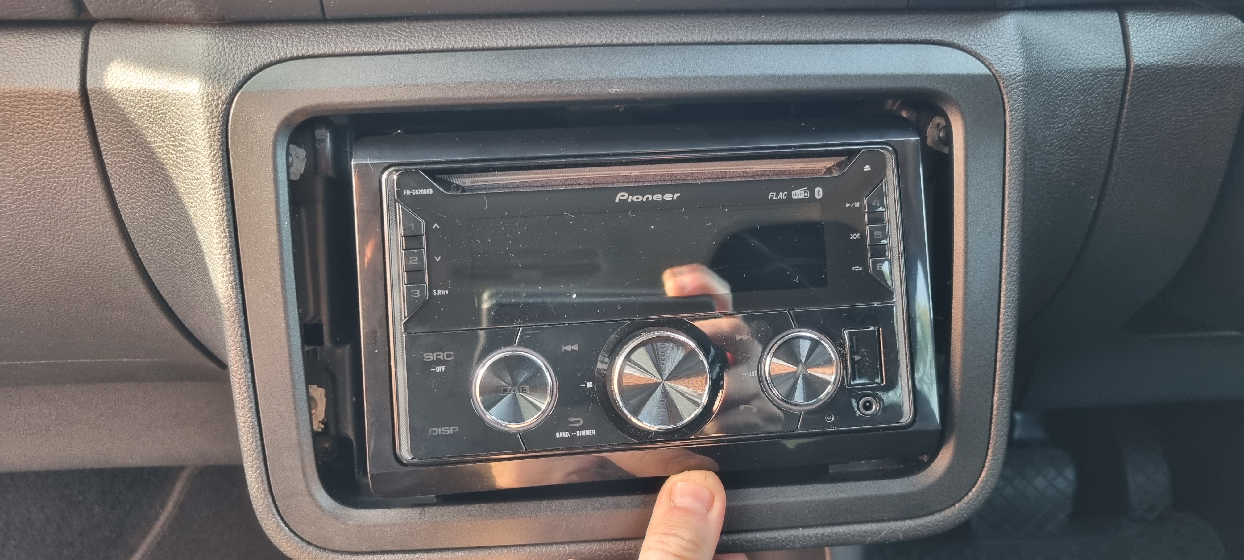

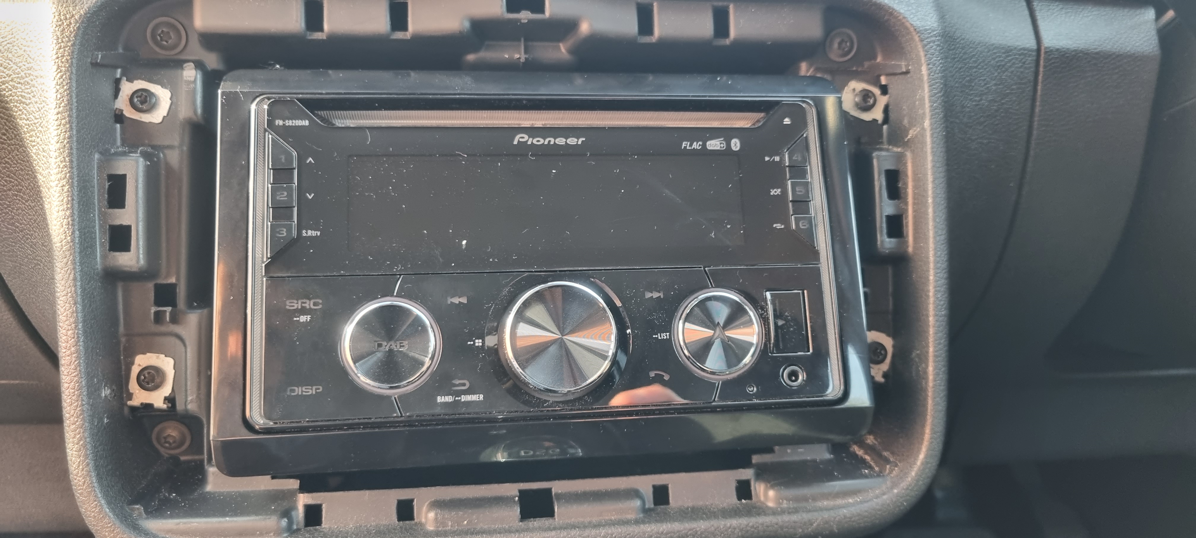

  9. Hi all, I've got a Pioneer and just checking if this is the thing I need before purchasing. In the pics I take it the fascia in the link will sit in *behind* the clip in part on the front (removed second pic), is that correct? And then it'll all fit in snuggly? Thanks https://incartec.co.uk/product/Volkswagen-Seat-Skoda-Double-DIN-radio-fascia-adapter-panel-MATT-BLACK-50-714

  11. Ok thank you chaps for all the help it's much appreciated I managed to get it working normally so I'll just live with manually turning the radio on/off. Next job is making it fit snugly and finding/making a bigger fascia, don't fancy buying one incase they're not big enough!
