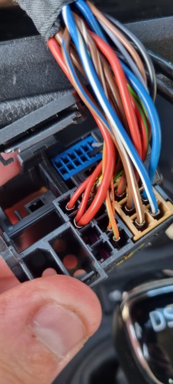

  13. Nah that didn't change anything, stereo still comes on straight away even without key in the barrel. I've looked on the page below but it doesn't match what I see (I have asked there as well with pictures). I have 5 wires into the black section on the car but the converter only has 3...feels like I'm missing something I need. https://www.briskoda.net/forums/topic/196288-oem-wiring-loom-colours-pins-for-stereos/

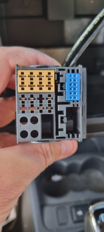

  16. Sorry to resurrect such an old thread but hoping someone could help me, as per the first post the Black Connectors are not the same on my Fabia mk2 see pics below. I figured the fatter Red wire was the Power but the two up top? orange with green strip and orange with brown strip, any ideas? thanks
  17. bought online but no matter I popped to Halfords and they helped me with the adapter I needed.
