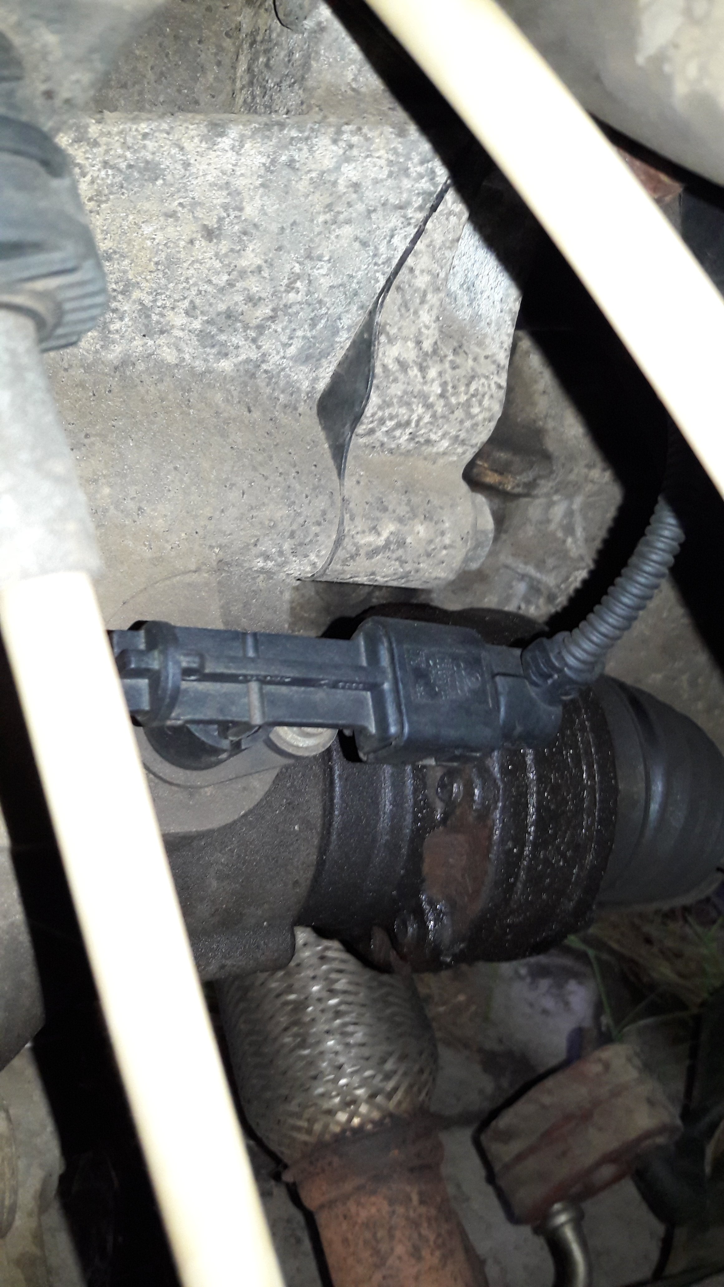

Don't think it will have a vehicle speed sensor, does what you found look like this?

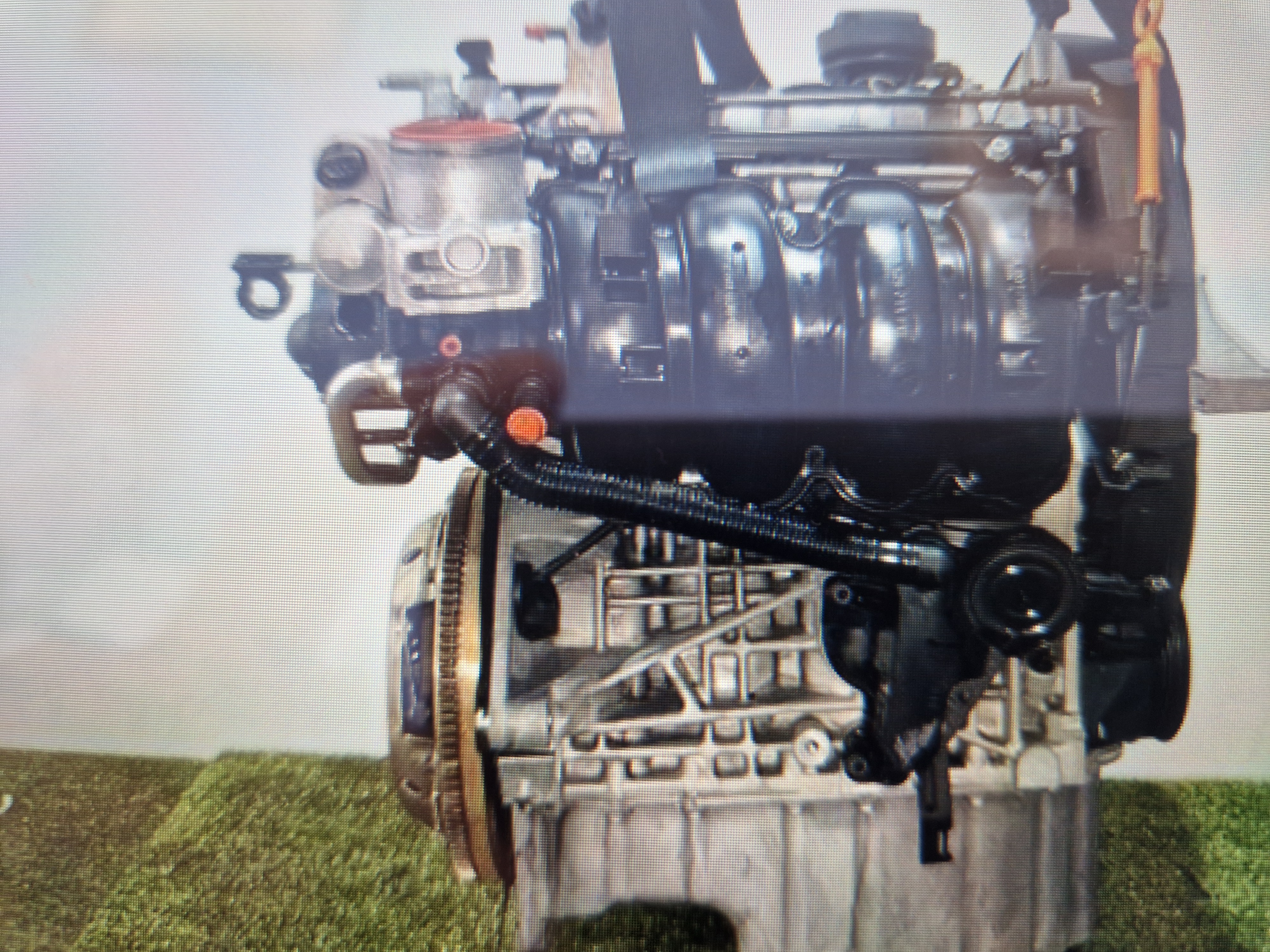

Crank sensor isn't far from there, on back of block looking at back face of flywheel, I think. Will try to find a good image.
  • Sponsor
Here you go, vertically below TB.
20160828_085505.jpgYes, thats what I found. Looks like speed sensor to me, reading shaft rotations out to the wheel.
  • Sponsor
It's a dummy sensor, pull it out of diff and you'll see. ABS wheel speed sensors do the job on your car.
