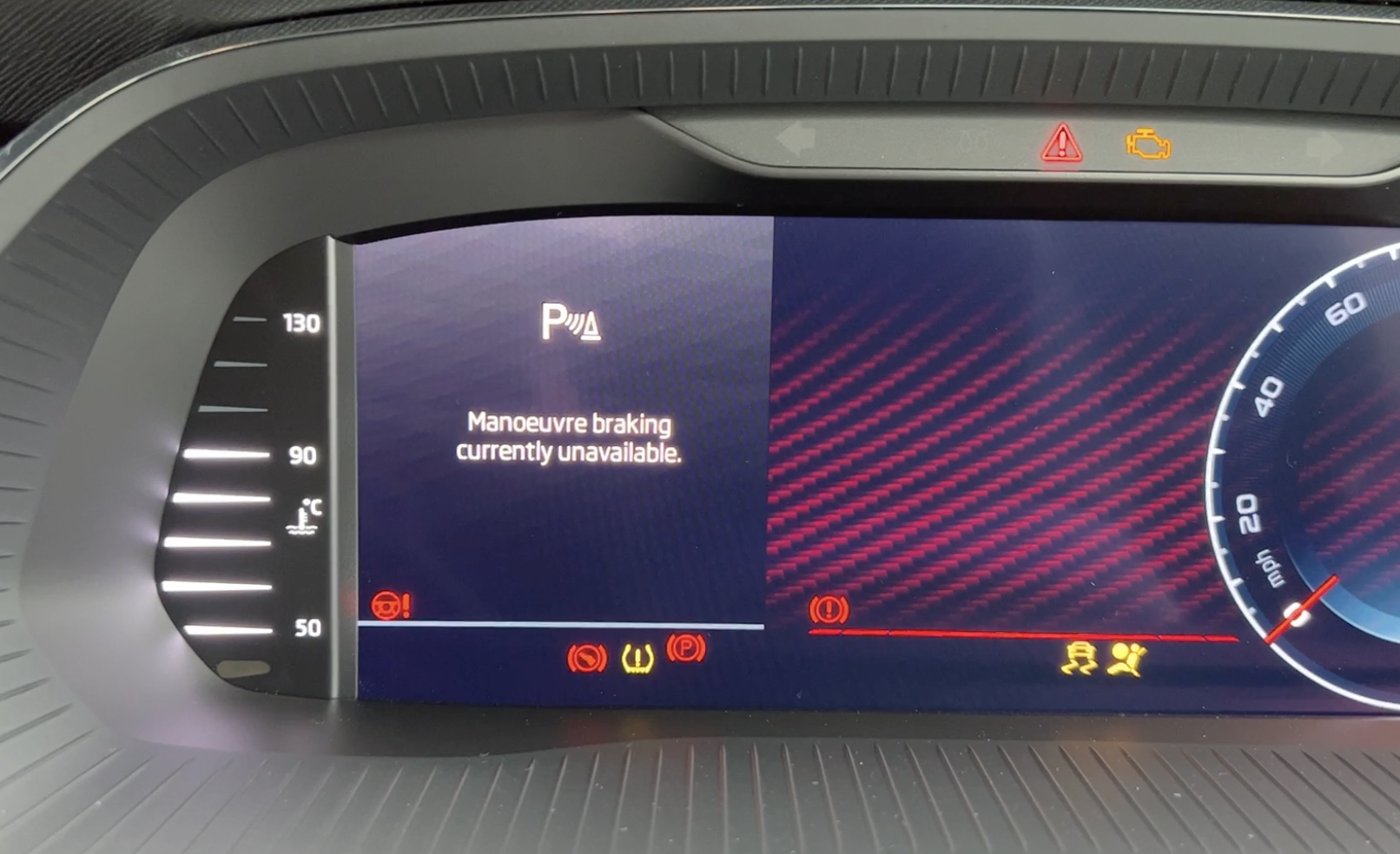

  2. Your description of your problem is almost identical to my issue. However ACC doesn’t work for me. I get the bong sound the two warning messages pictured and the warning triangle. With a lack of ACC function. On occasions the error will clear, ACC works for a short while, then the error returns. Sometimes I get the error and bong over and over again. It’s very annoying.

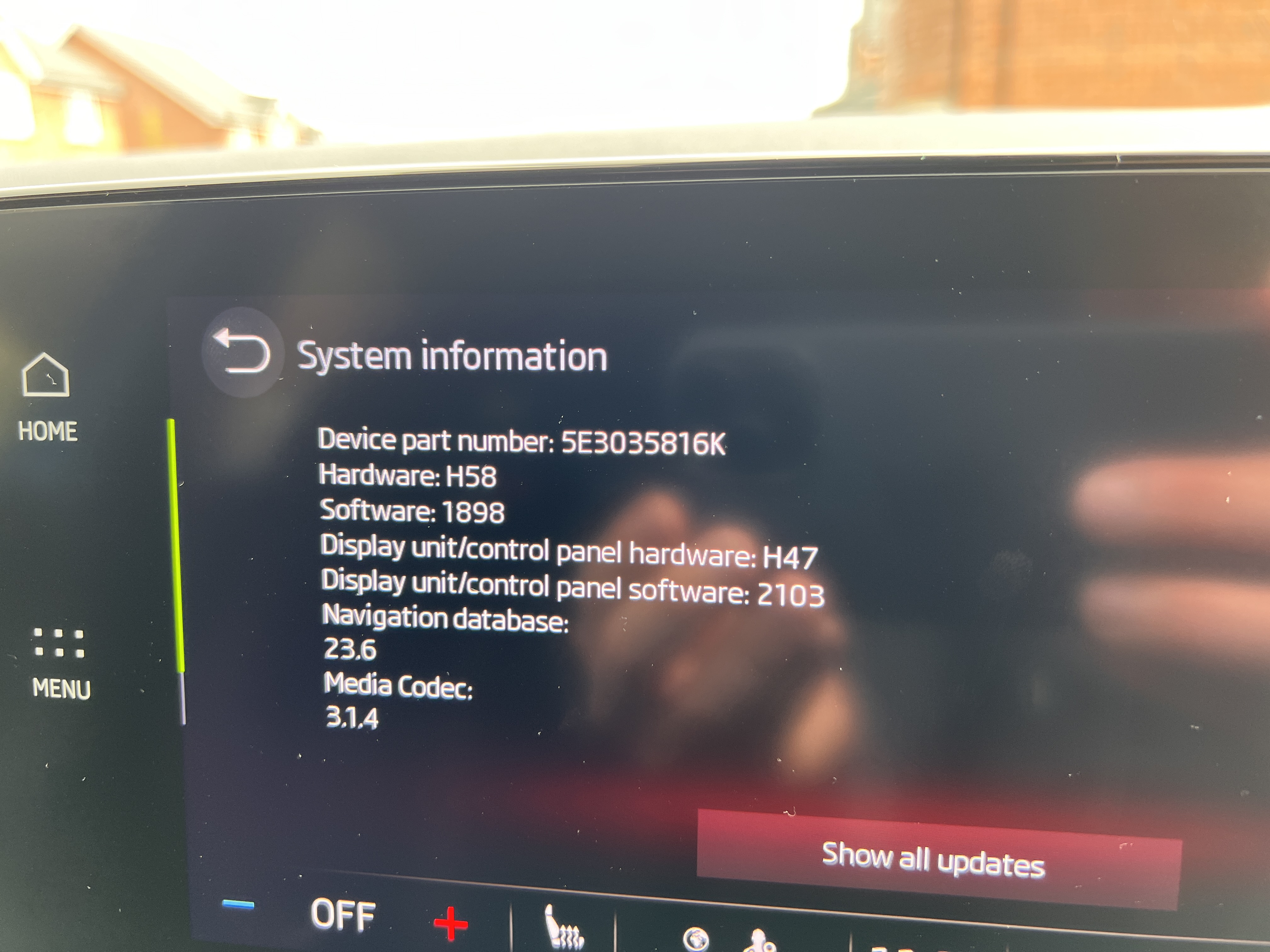

  5. I’ve been following the infotainment restart thread for a while, but came to the conclusion my issue wasn’t related because there was no one else from what I have read with the front assist availability limited issue and acc not working. But I think it’s worth a go. Nothing to lose. If upgrading to 1941 doesn’t fix the issue. I think I’ll move the car on if I can with this fault.
  6. Thank Julius, My Vehicle is also going back to the dealer on Monday, I’ll report back also. I was intending to ask for 1941 update too. We’ll see it solves the issues we have.
  7. Hi Julius, Thanks for the reply. What software version is your Infotainment System on? Would it be on 1896 by any chance? I would be grateful if you could let us know if there’s any change once you have your Infotainment System updated to

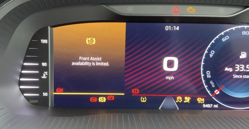

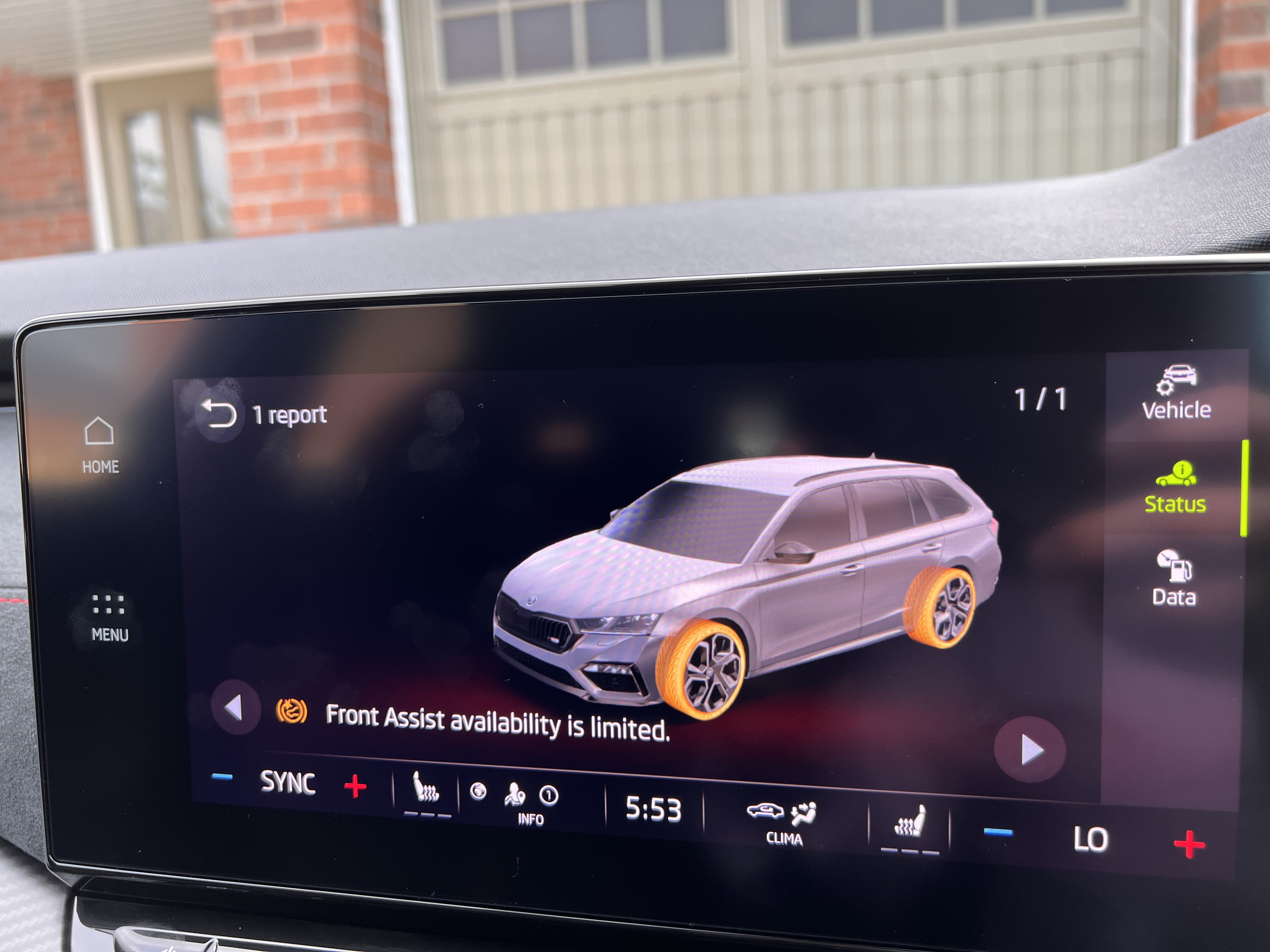

  9. Hi Everyone, I’m hoping someone else has experienced a problem I haven't with my VRS IV. When turning on the ignition and starting the vehicle 99% of the time I get Manoeuvre braking currently unavailable and also Front Assist Availability Limited. The error is persistent, however occasionally the error clears briefly. Then the errors pings over and over again. I took the vehicle to a Dealer and all they did was clear the error codes and sent me on my way. This problem is driving me insane. Any help is appreciated. Thanks in advance.
  10. Hi Guys. Thanks for the replies. I should have added ACC isn’t available also. I’m not brave enough to do the software update myself, although I’ve read the thread and do understand the process. I have the vehicle booked in with my local Skoda dealer to investigate. If the dealer can’t resolve I may have a go at the software update. I’m really hopping it’s software related and not hardware as I understand front assist recalibration isn’t covered under warranty. Not sure what MIB is, assuming reference to the infotainment software? My vehicle is 6 months old so also assuming my vehicle has the latest systems. I owned a Octavia III previously had no issue with the Front assist or ACC in that vehicle.
  11. Hi everyone, New member here, I’ve been viewing the forum for a while, reading with interest. I was hoping someone had experienced of a problem I’m having with My 2022 VRS. Every time I start my car I get two errors Front Assist Availability Limited, and Manoeuvre Braking Currently Unavailable. I’m thinking this is probably a software issue rather than a problem with the ACC camera or radar. I get both of these errors, 99.9% of the time when starting the car, very occasional the error clears for a short while, but eventually the error returns. My infotainment system is on 1898. The car hasn’t sustained any sort of front end impact, and both sensors are clean. Any insight is appreciated. Thanks Ian
