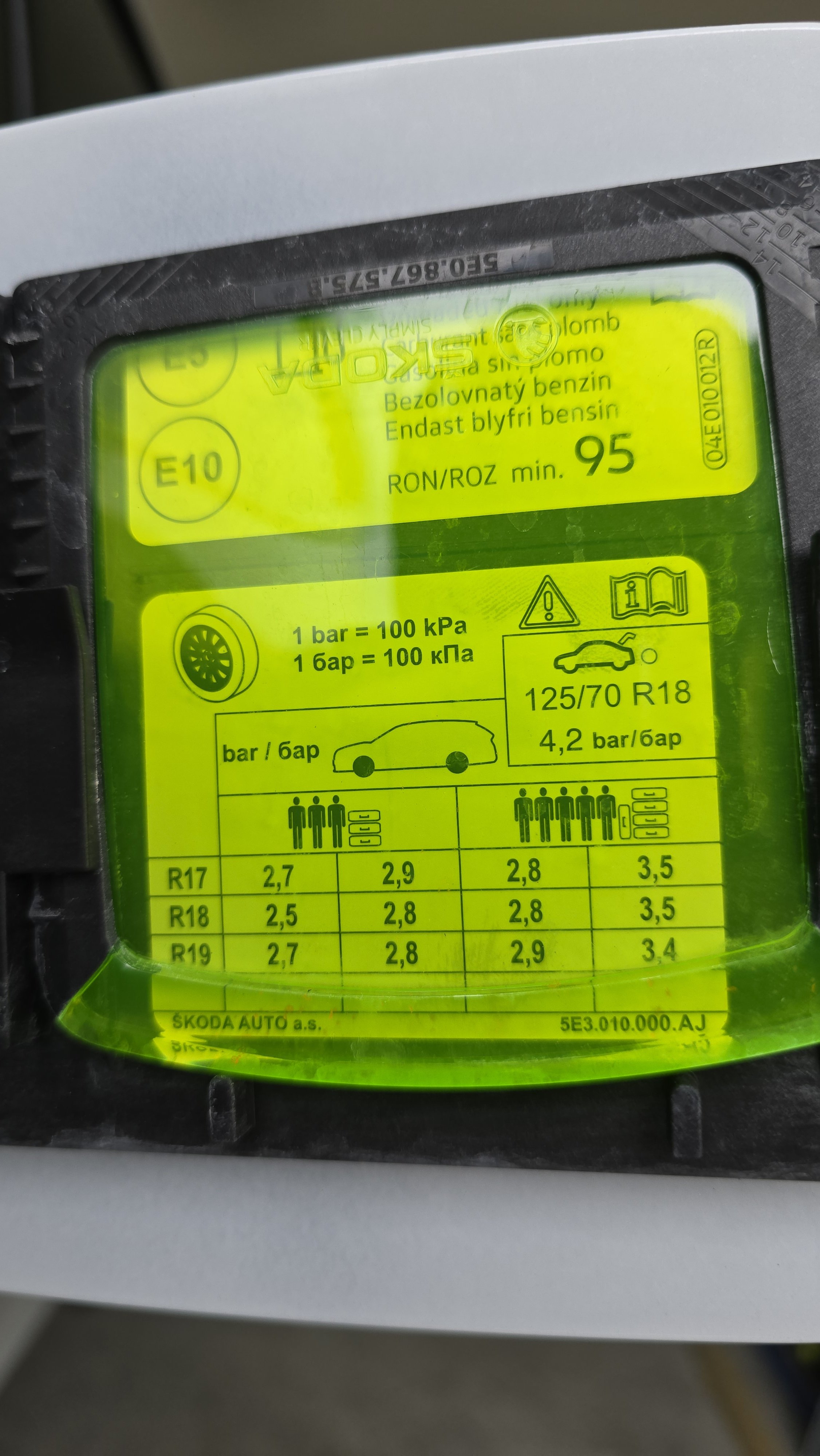

  3. well, now you've opened a can of worms..... i have the 22/45 R18s and the chart by the fuel filler shows this: i think using BAR for anything but scuba is a blunt tool so in psi this is 36 front and 40 rear. for decades of driving across different car the go-to has been 32/33....which i why i originally said youe pressure seemed scary high. so i erred on the side of caution and have been running 33. however, i guess i need to grasp the nettle, pump then up a bit then go for a drive e-mode and just see what happens.
  4. noted, thks. running 33psi (manual says 32............39 seems very high??)

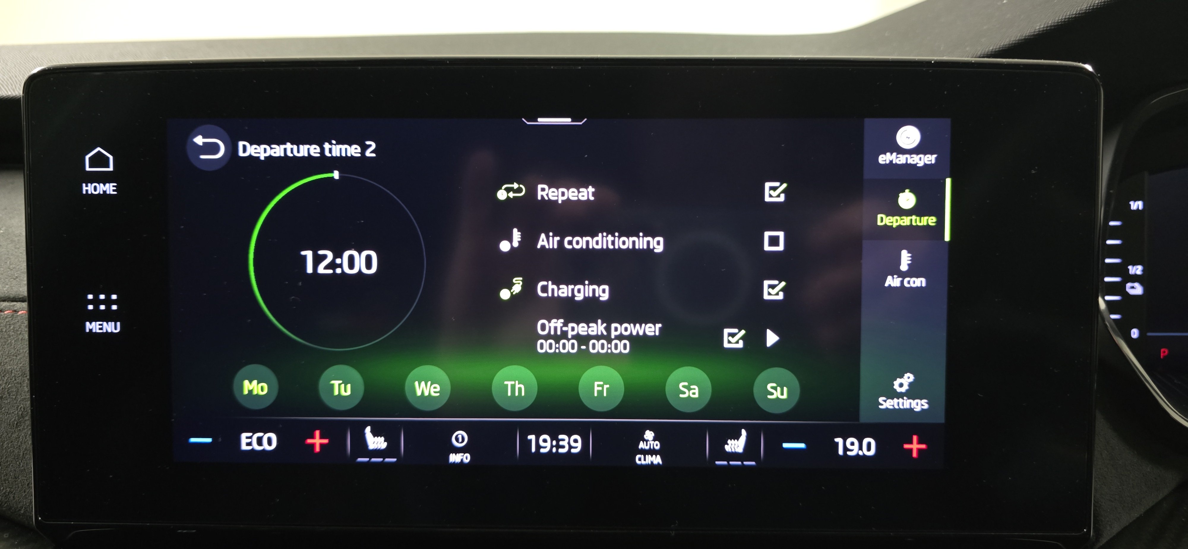

  12. @Edela - cheers, look like thats the only way to go..... @jay982bea - i obviously have a different setup, when i configure a departure plan it comes up as follows:
