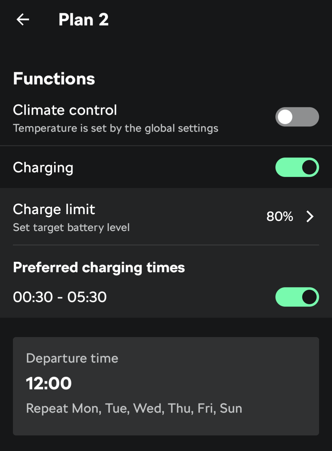

I have set a departure plan for 12 noon each day which has a maximum charge level of 80%. I don't apply this plan on Saturdays, because I go shopping and have a separate plan which charges to 100% and sets a target temperature for my usual departure time.

@jay982bea - i obviously have a different setup, when i configure a departure plan it comes up as follows:
Mate I’m guessing that is because he was showing you his app. We don’t have connectivity in New Zealand.

@whippersnapper @jay982bea @Edela
ah, the penny drops......of course, suddenly makes sense.
i've tried to get the app, officially and not so officially but no joy.....
i asked the dealer and he said it ewasn't going to be any time soon.
cheers mate, i'm just going to plug it in overnight and it can have at it :)
I had the app but it won't work. The app needs to connect to a dealer to authorise the connection. The one I had went to Singapore! My dealer told me that there are plans to introduce servers in Australia / New Zealand but when that happens it won't be retroactive unfortunately. For me the only downside is not being able to have driving profiles for my wife and I. At least the seat and mirror settings are coded to the memory seats.
