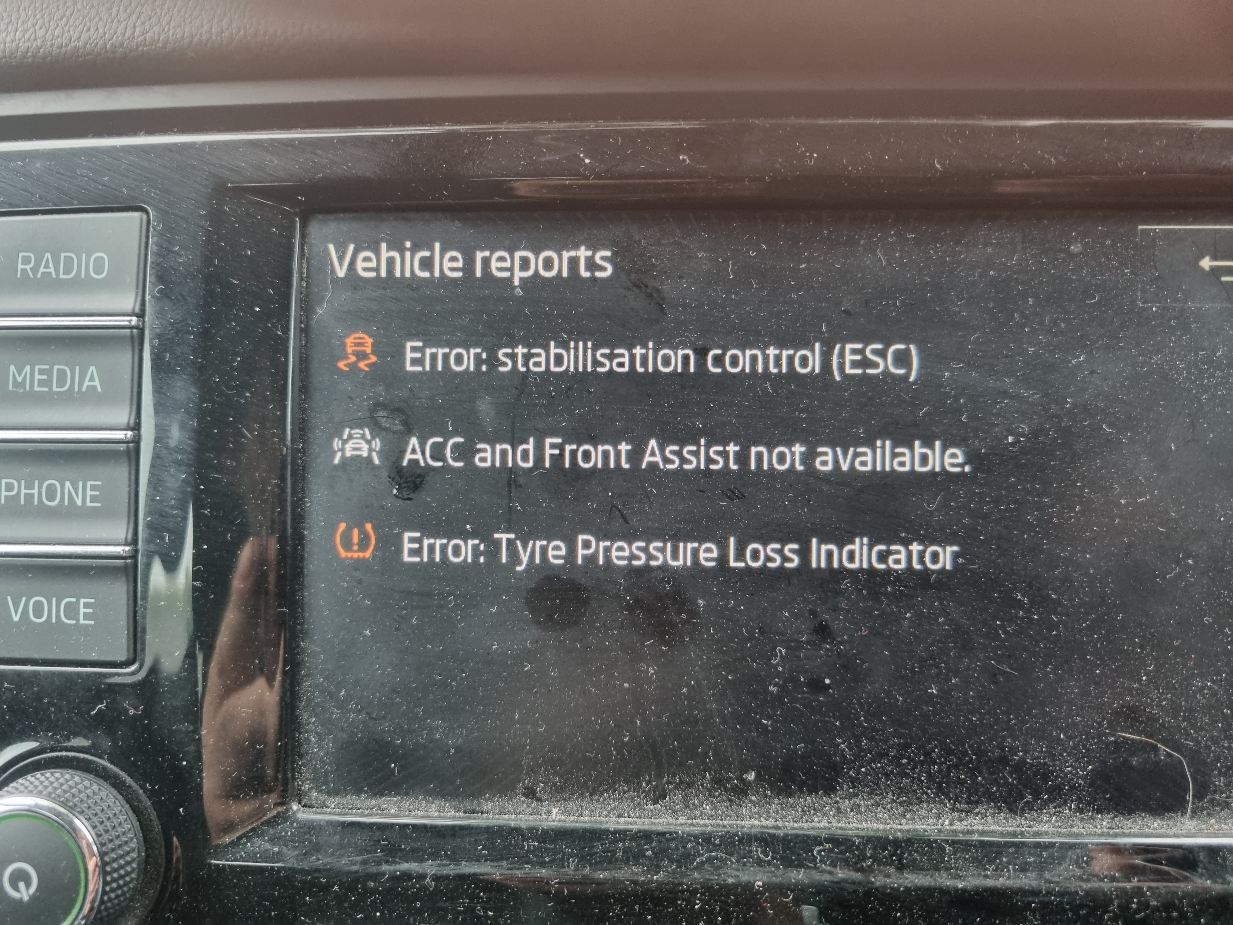

  1. I've got a full set of sensors in my garage which I bought when I had a wheel hub replaced just incase they were required
  2. Thanks I'll get the volt meter on the battery to check it out as it's the original battery
  3. Driving my mk3 octavia 2lt 65 plate and all the electrics started to bleep and the abs and esp warning lights ,and low tyre pressure light came on Amber try to rest the tyre after checking and it wouldn't reset.ive plug my odbe reader in and there was no codes . People have said it could be the battery on the way out ?? But looking for advice before taking it to skoda
