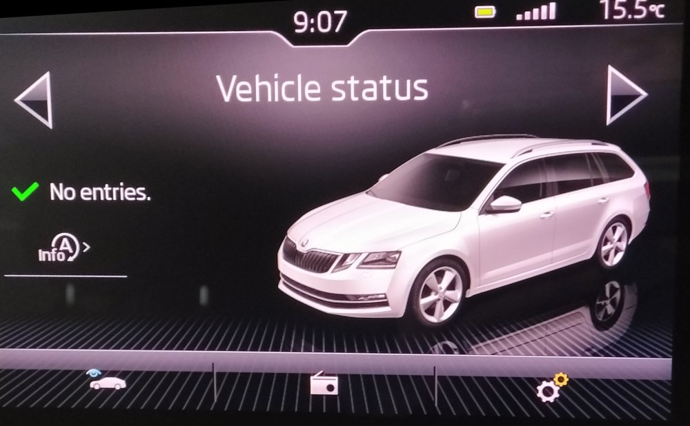

  2. 0 diagnostic trouble codes found
  3. It's coming from the dashboard or from behind the dashboard. I have had the car since new - there are no third-party devices fitted.
  4. Can anyone identify this beeping noise coming from my dashboard? Only does it occasionally. No accompanying warning lights or other indications. Disappears after turning ignition off and back on. Video was taken with car stationary and ignition on. VID_20250922192947.mp4
