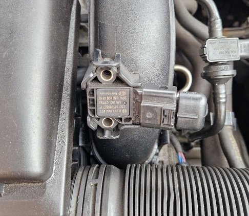

I changed this just before we went away last week, code has not reappeared in just over 1000 miles so hopefully that is another one ticked off. Thanks for the help.

Thanks for the replies, I think for £30 for a Bosch part I will just replace it rather than faff about, hopefully that will cross this one off the list! Cheers.

So, now the fuel leak is sorted I am turning my attention to three errors that VCDS has flagged up. I'll run a separate thread for each to keep everything tidy and searchable. So, we have P0113 Signal too high, The report, pasted below states G42 which looks like the one that is part of GX26 (Charge Pressure Sender). My questions are:- Have I located the correct sensor, as pictured below? Is it something that may respond to cleaning with carb cleaner or should I just replace? Log and Picture:- 20572 - Intake Air Temp. Sensor (G42) P0113 00 [00100000] - Signal too High Intermittent - Not Confirmed - Tested Since Memory Clear Freeze Frame: Fault Priority: 2 Fault Frequency: 1 Mileage: 139721 km Date: 2025.06.27 Time: 12:59:05 Engine speed: 0.00 /min Normed load value: 0.0 % Vehicle speed: 0 km/h Coolant temperature: 84 °C Intake air temperature: 39 °C Ambient air pressure: 1010 mbar Voltage terminal 30: 12.651 V Unlearning counter according OBD: 35 Mass flow through throttle valve: 1.6 kg/h Mean injection time: 0.572 ms Engine operating condition: Idle Engine operating condition-Test_Program_Channel 87: 5 Driver-side belt buckle status-Bits 0-7: 191 Engine torque: 16.8 Nm

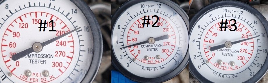

Well this tale may have a sorry ending. My daughter has used the car for a happy 30,000 miles but yesterday it misfired, rapidly declined to not running. RAC came out and a big bit of ceramic is missing off #2 plug, 6 month old plugs, very annoying. New plugs fitted and apparantly runs like a bag of nails. I am getting the car recovered from Bristol to Nottingham and I'll do a compression test but I expect the engine is done :(
