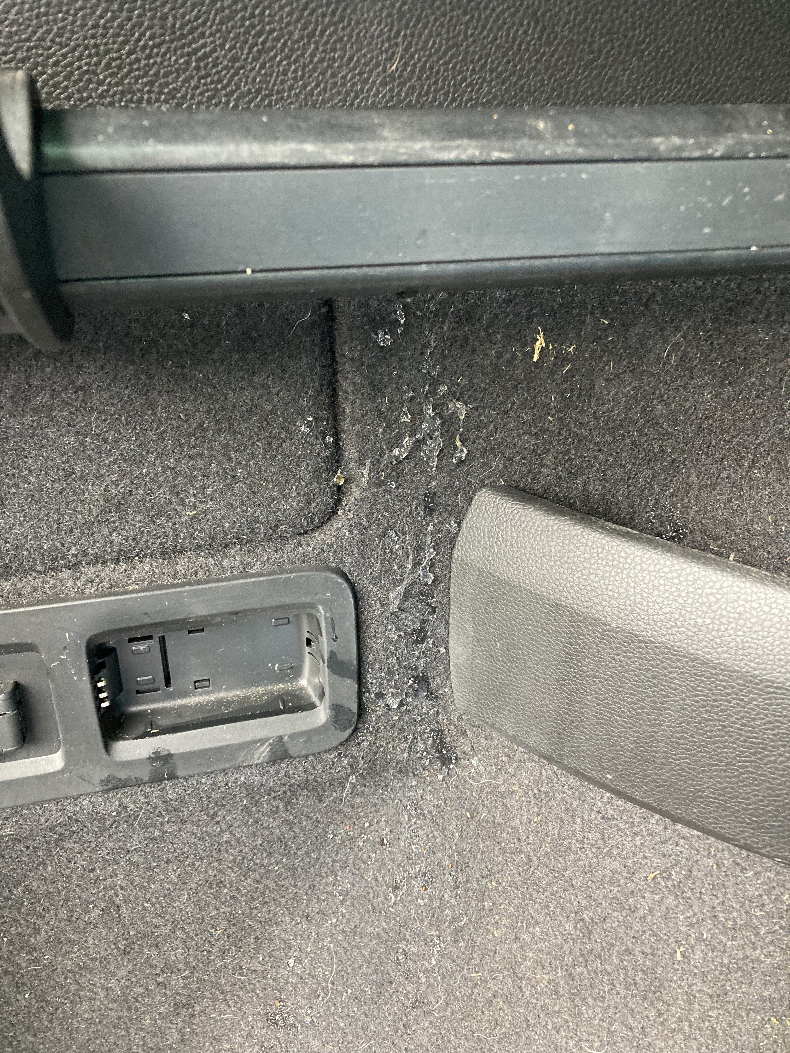

  1. Thanks for this, but it’s definitely related to the drains. Opened roof and poured water from a jug into the front corners and it drained. Did the same about halfway back (so the water ran back) and it drained on the off side but dripped into the boot space on the near side. To my mind that would equate to a blocked drain, just need to know how to get to it!
